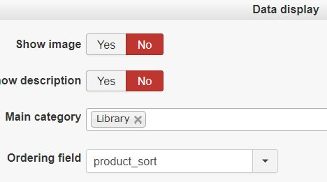

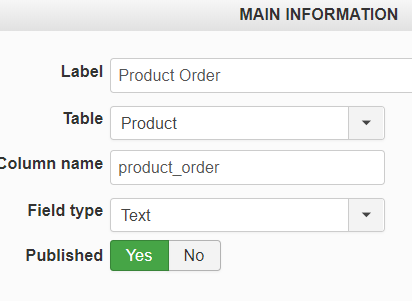

The product_code column is already using alpha characters in many of the products, so changing the data type to integer is not an option.
Will it work if I create a custom field then set it column type to integer in my database and use that to sort the products on the front-end?

8 years 6 months ago #289347
by nicolas
Replied by nicolas on topic Sorting Error for product codes >= 100
Yes, you can do that.
