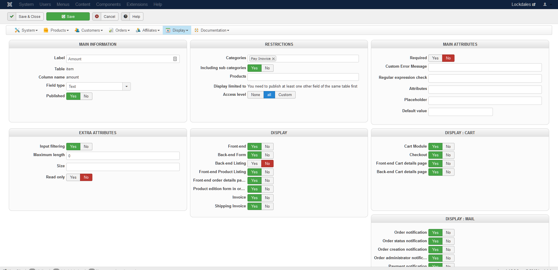

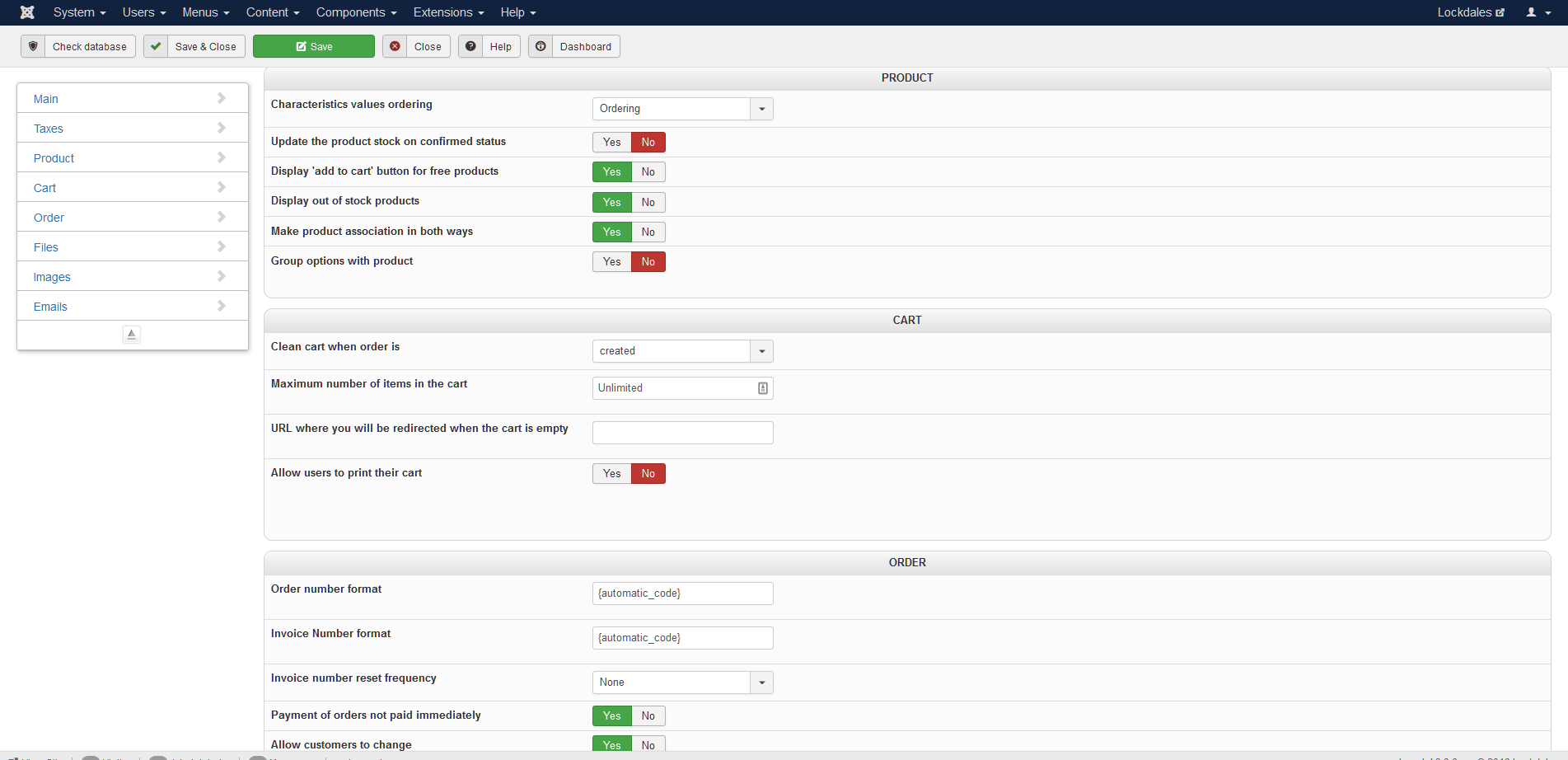

I have tried to follow the instructions here:
www.hikashop.com/support/documentation/1...p-field-listing.html
But I can't get it to work?
Please see attachments
of settings. Thanks.

These settings are fine.
From what I can see, either you didn't activate the HikaShop donation plugin via the Joomla plugins manager or have a problem in the settings of that plugin.
So please check on that.

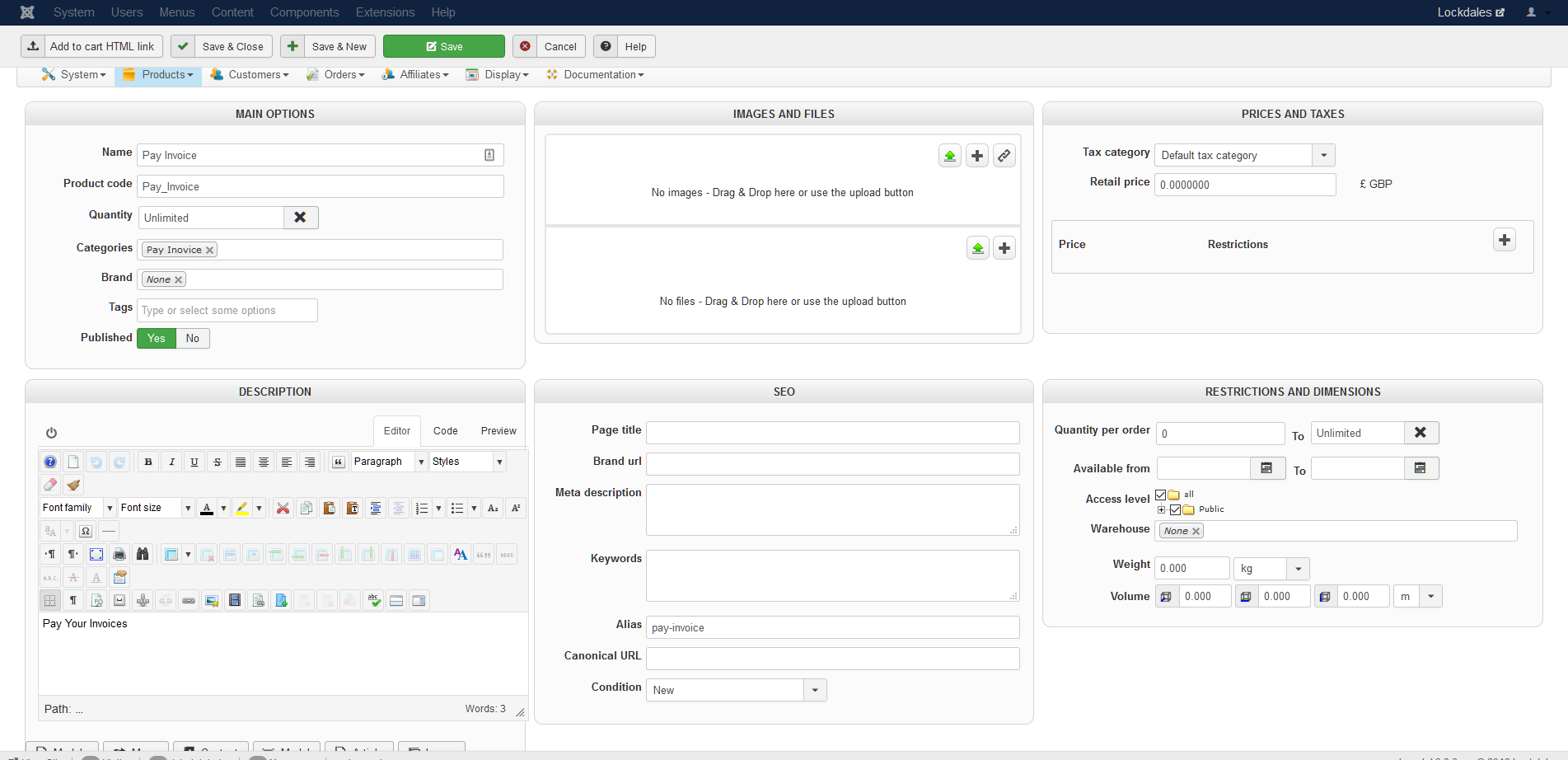

Sorry by bad lol I found the plugin.
However, now the product doesn't get added to cart at all? Anything else I could be missing?
Many thanks.
  • Posts: 26381
8 years 4 months ago #289916
I made a little test and I was able to add the product in the cart.
I just set a value for the "amount" donation and a value for the "invoice number".
