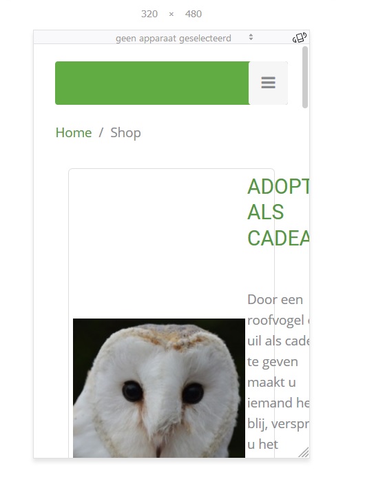

Dear all,
My category layout in the standing responsive mode is looking terrible.
Enclosed pls find attached a printscreen of the shop.
Could you pls advise?
Thanks in advance,
kind regards
Renata Gravendijk

8 years 4 months ago #289940
The issue is that you've selected "image and description (deprecated)" instead of "image and description" in the "Layout type" setting of your menu item.
The deprecated (old) layout is not responsive unless you add custom CSS.
The new layout is responsive.
I've changed it for you.
