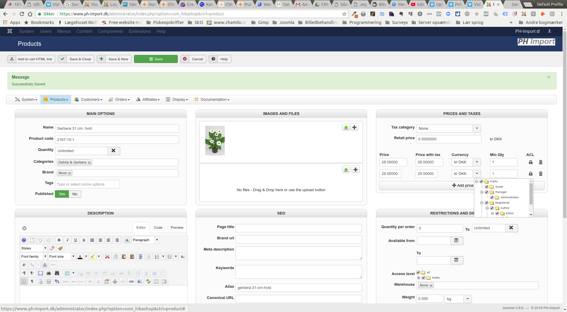

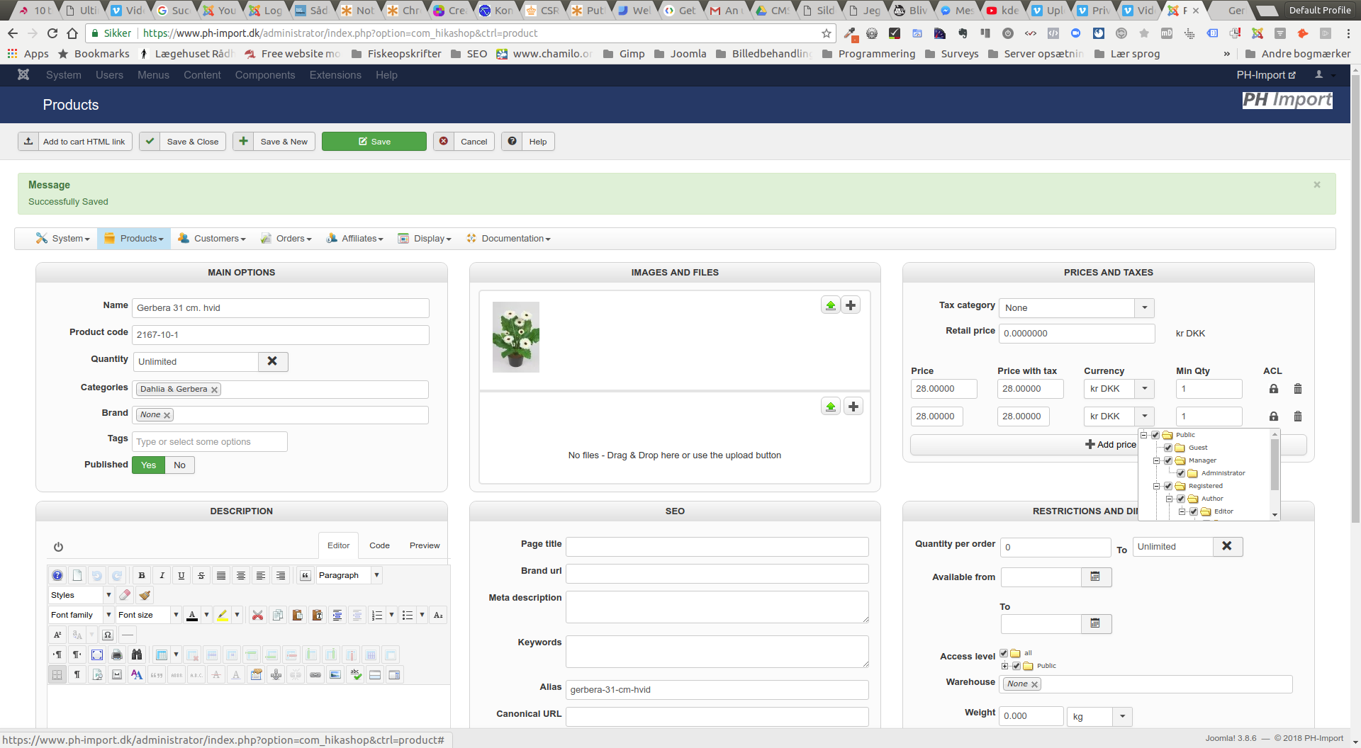

  • Posts: 145
8 years 4 months ago #290272
I have made this setting
what do i miss?
Best regards
Brian

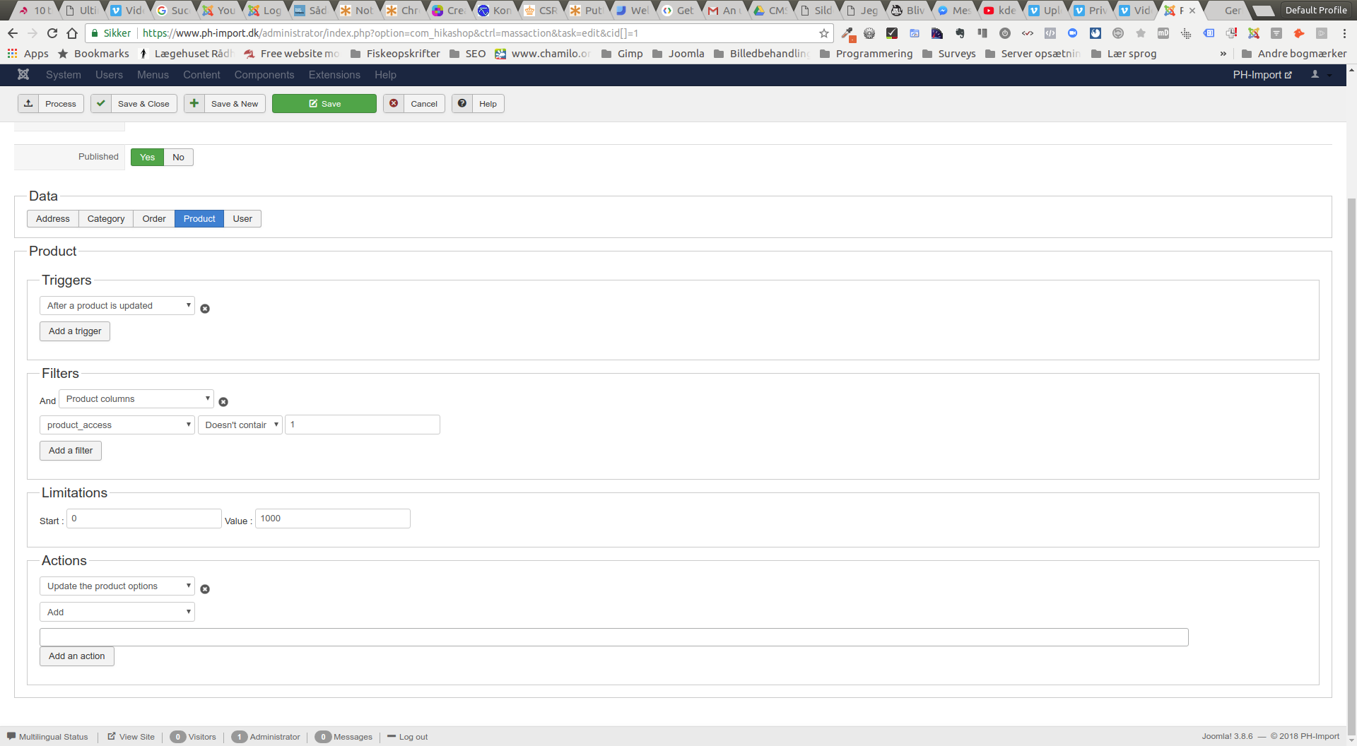

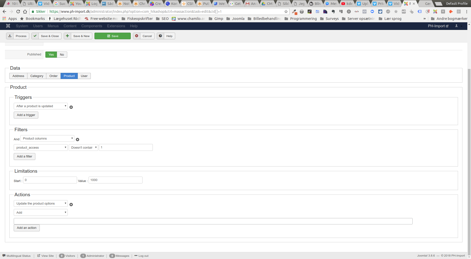

  • Posts: 145
8 years 4 months ago #290304
What do i do wrong?
I have Access level ID 1
I have set the Mass action like this, i think that should remove the public view
But it is still there when i create a new price
Best regards
Brian

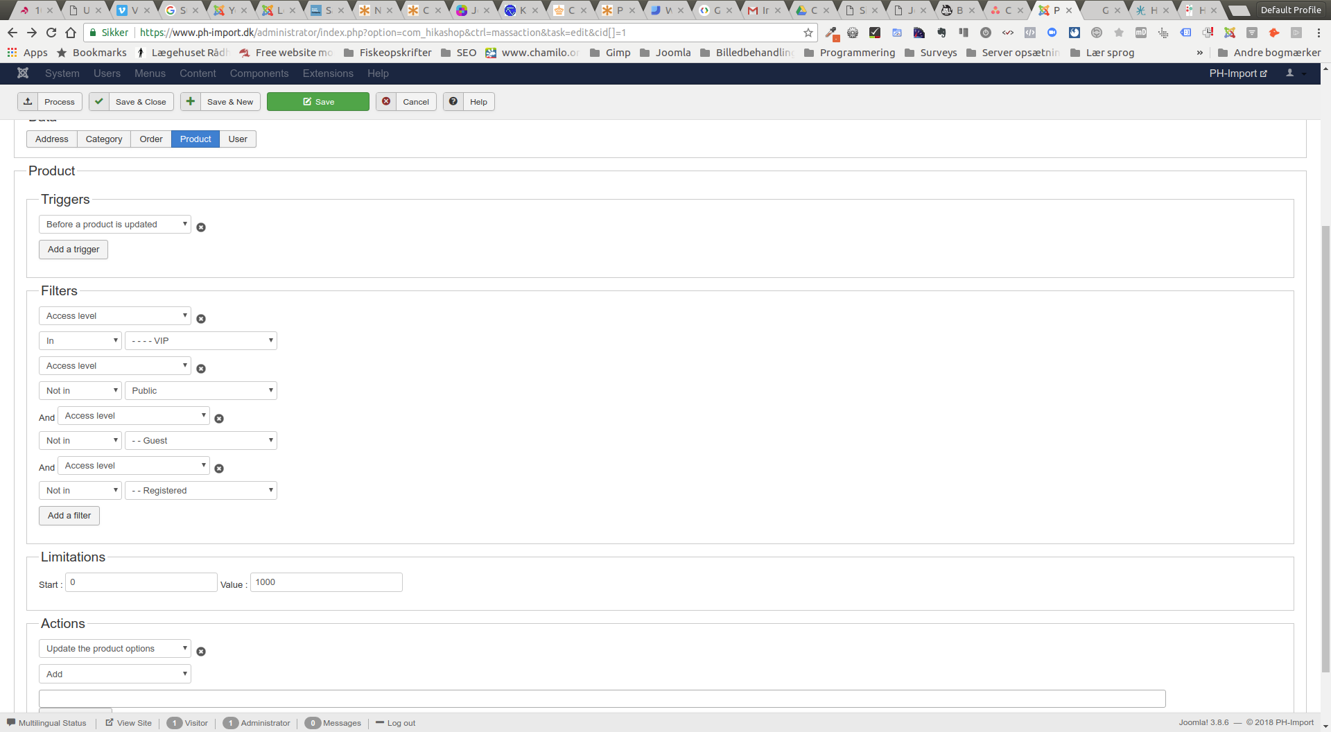

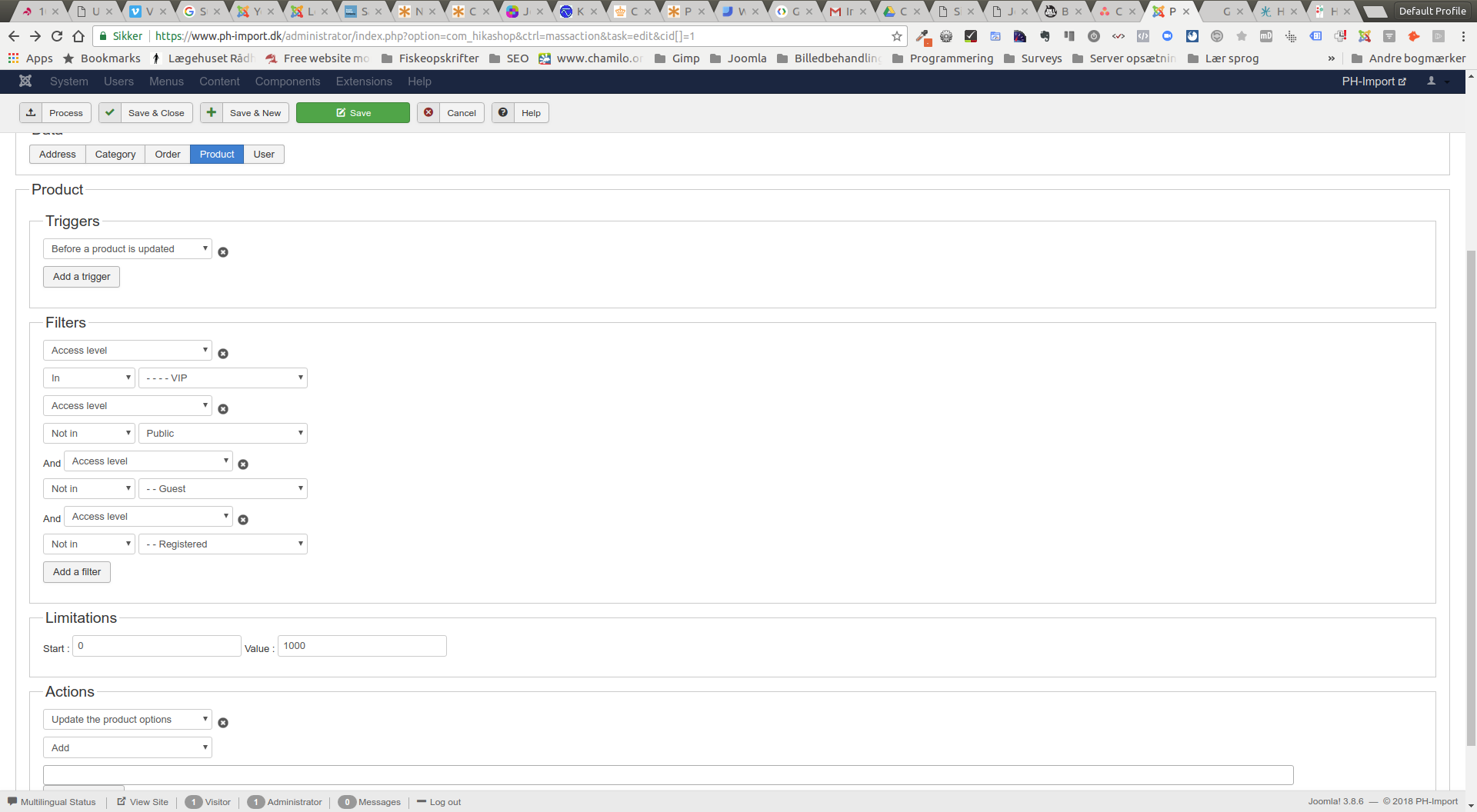

  • Posts: 86056
  • Thank you received: 14181
8 years 4 months ago #290732
If that's what you want to do, then your mass action is not correct at all.
The filter area is to decide whether the product should be processed or not.
So with the filter you configured in your screenshot, it means that the mass action will only do the actions if the "access level" setting of the product is set to that particular user group.
So you do NOT want to have a filter for your mass action. Instead you want to have one action "update the values", and in it, you want to select the column "price_access" with the "string" type and the value being ",1,"
