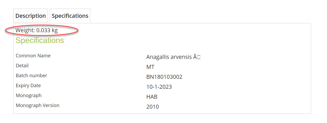

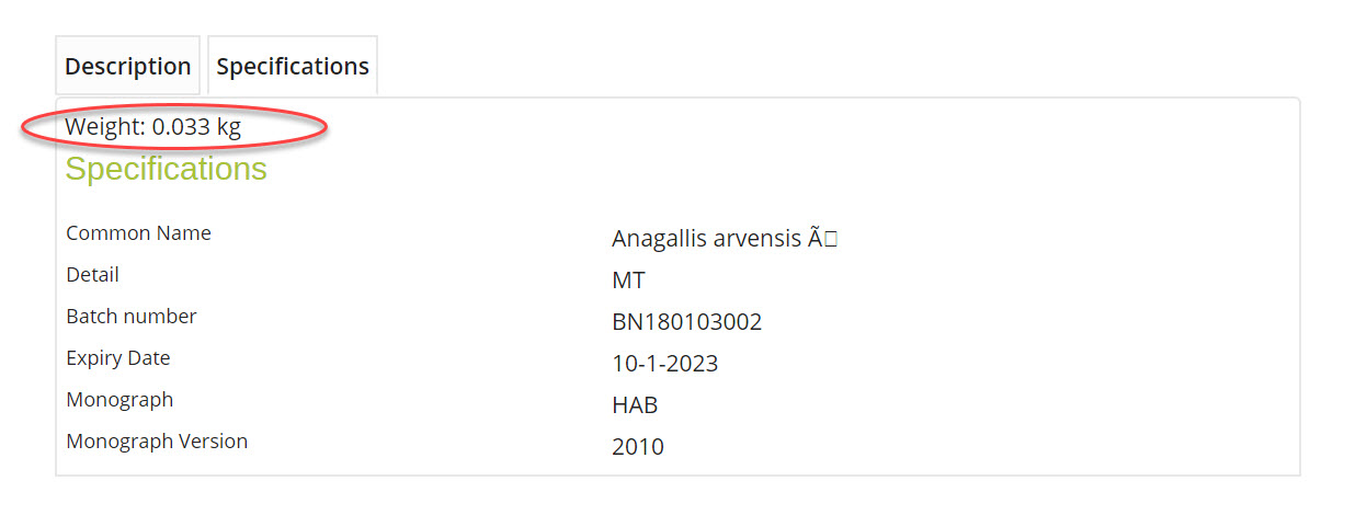

When we use the layout on productpage "tabular" we see that the weight of the product is standard displayed above the specification title.
Is there a reason for? How can we put this under the specification title next to the other fields?

You can edit the file "show_tabular" and change the line:
$specif_tab_content .= trim($this->loadTemplate());
to:
$specif_tab_content = trim($this->loadTemplate()). $specif_tab_content;
and that will swap both.
There is no particular reason that it is in this order. We'll change that on our end too for the next version.
