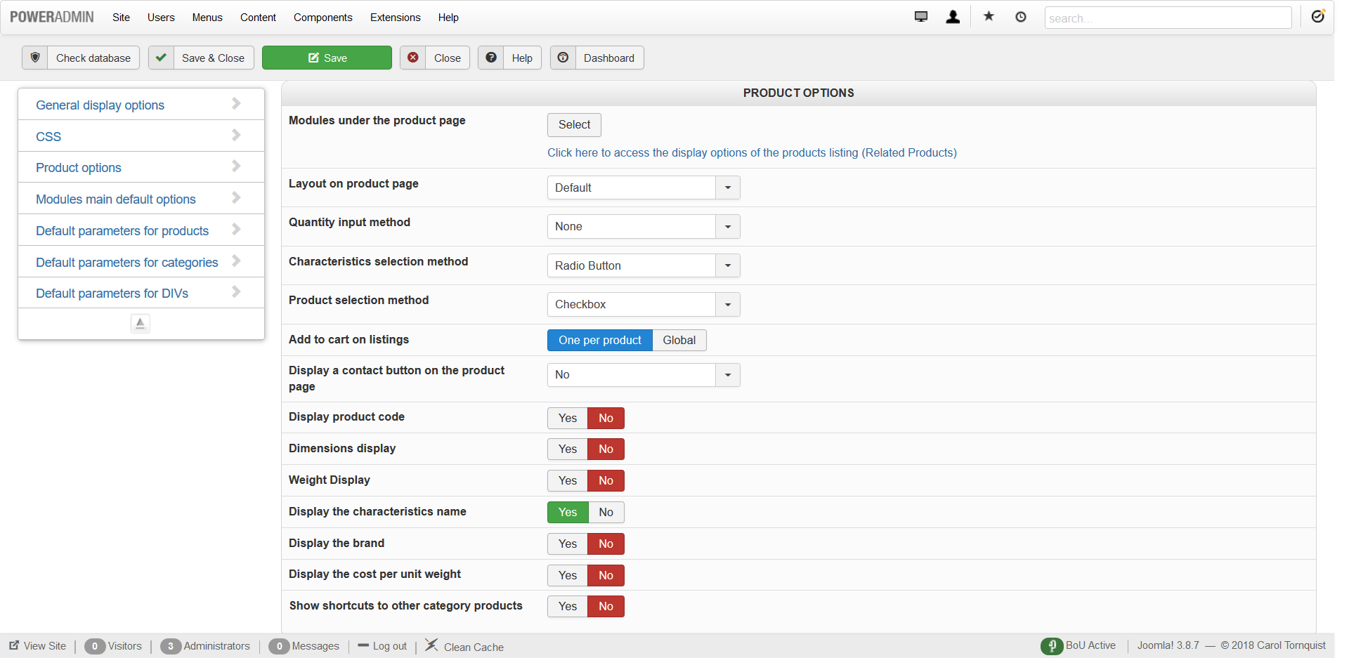

It's a bit too early to think about re-install HikaShop, Can you before this, provide these elements to check point per point your configuration :
- Your module configuration screenshot (especially HikaShop options tab)
- Your Main HikaShop Product configuration screenshot (in your Main HikaShop Configuration and in Display tab)

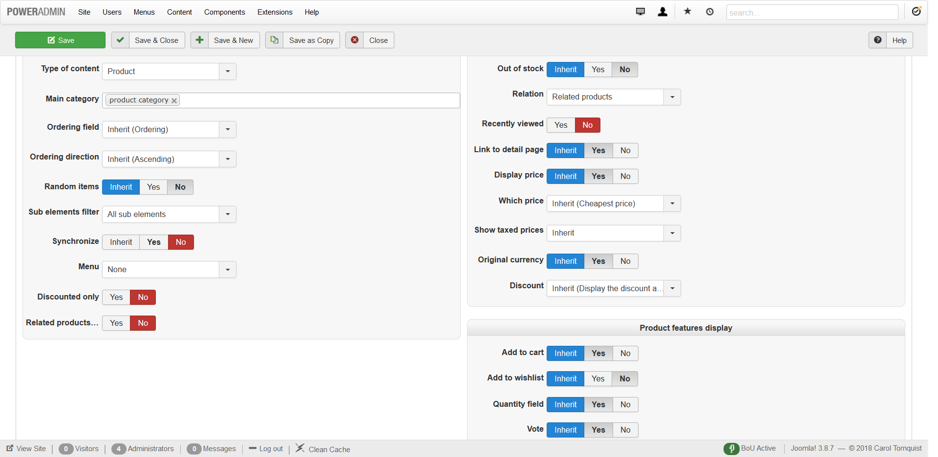

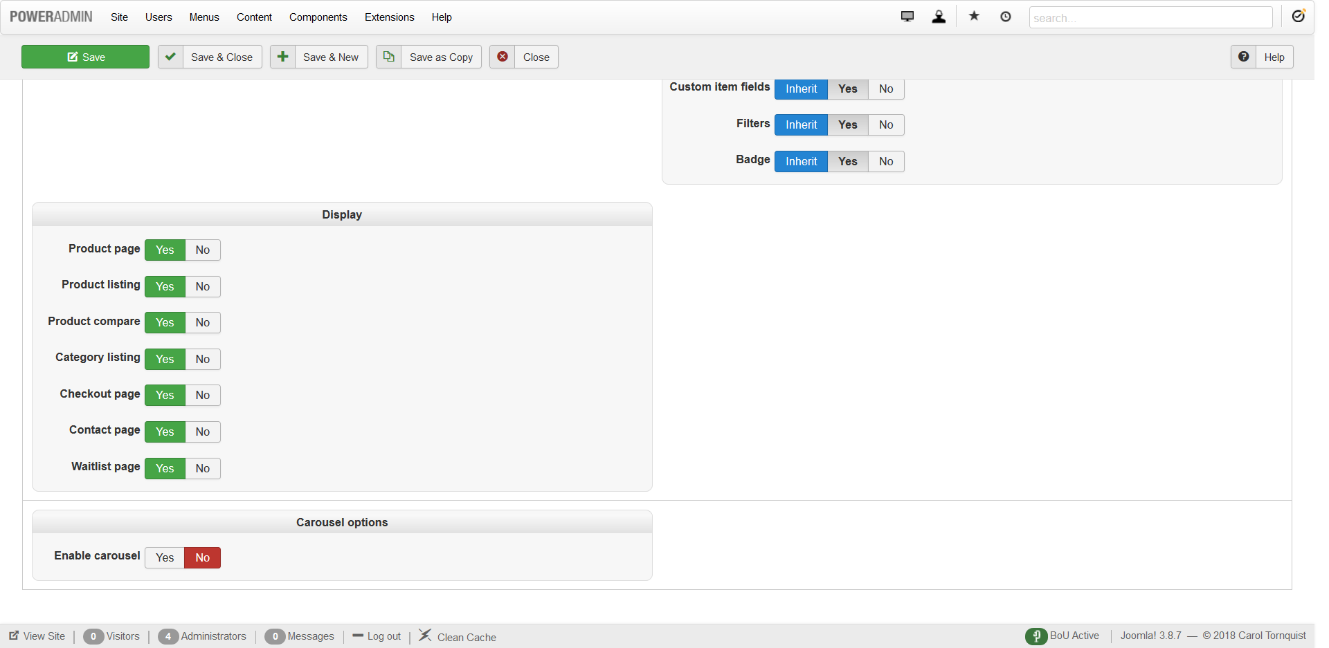

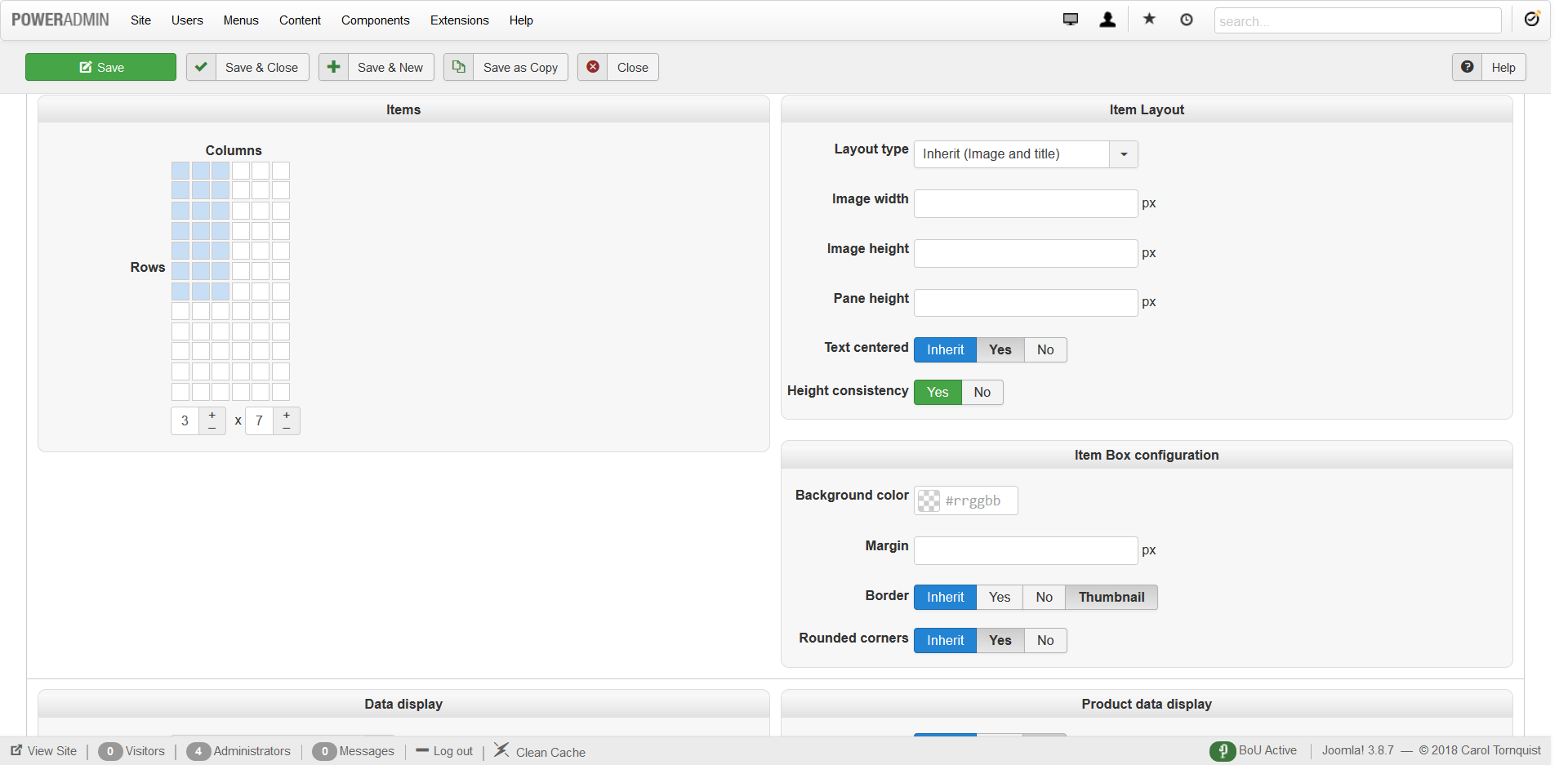

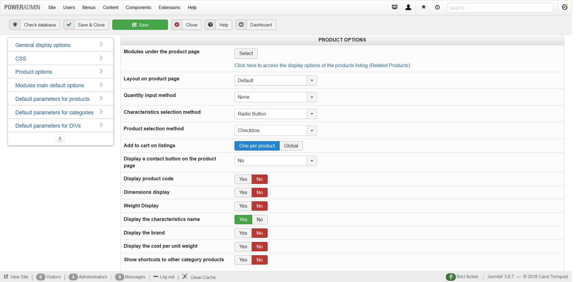

  • Posts: 36

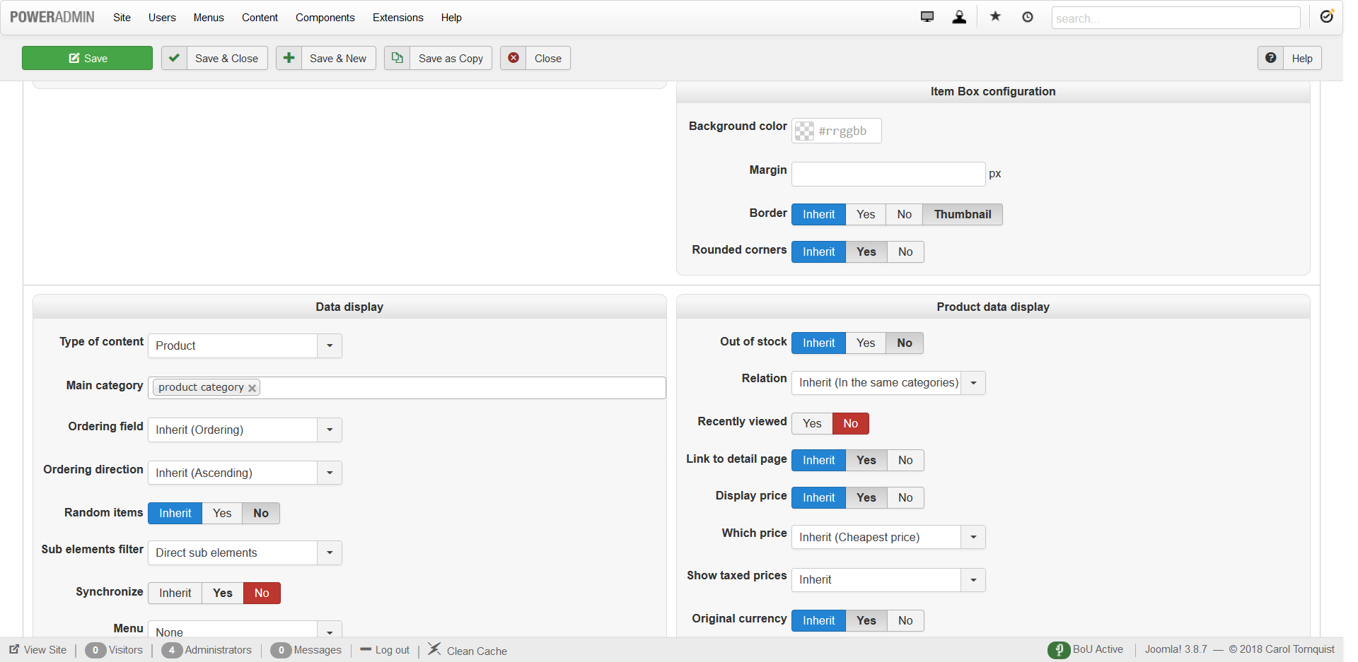

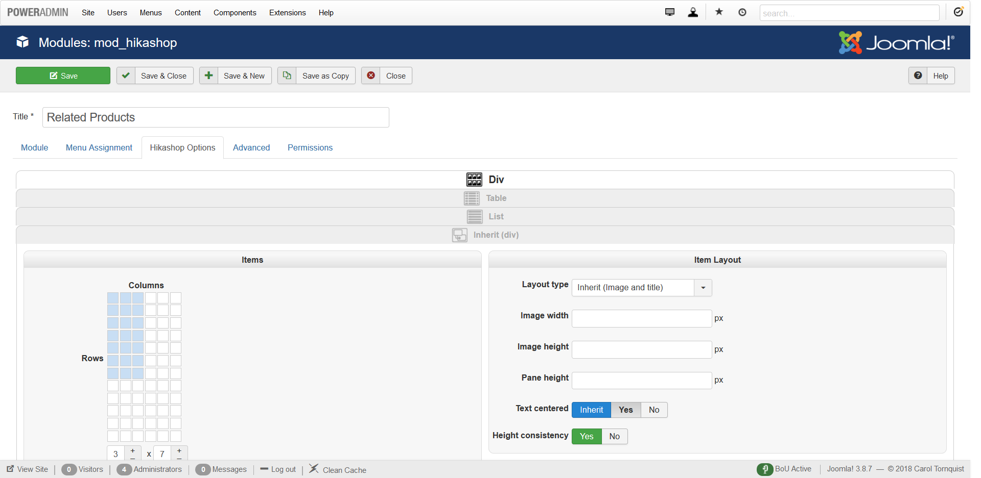

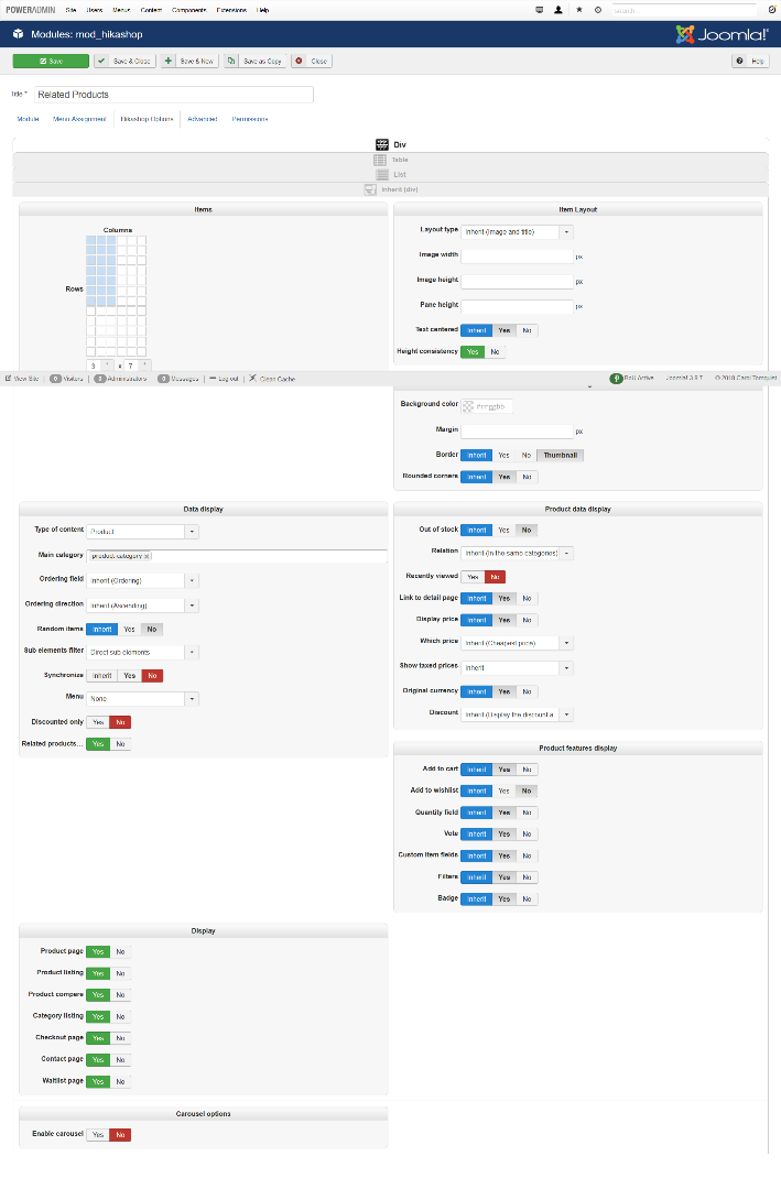

8 years 3 months ago #292710
Here are the two screenshots.
I also quickly switched the template to Beeze3 and tried to see if they related products were working - and they weren't working their either...

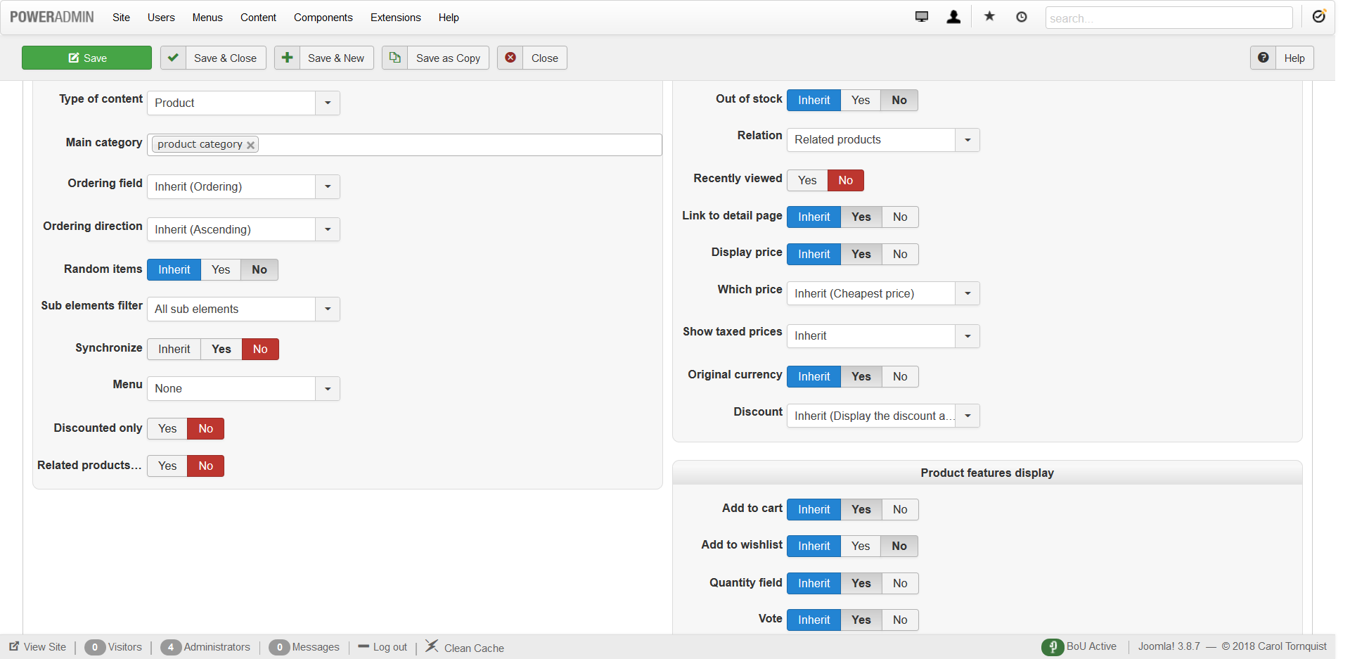

8 years 3 months ago #292724
Sorry but I'm unable to read your second screenshot options... Can you do it in a better definition ?
I was able to see some options nevertheless, and I think that I will need to see the module tab too.
Awaiting news from you.
Last edit: 8 years 3 months ago by Philip.

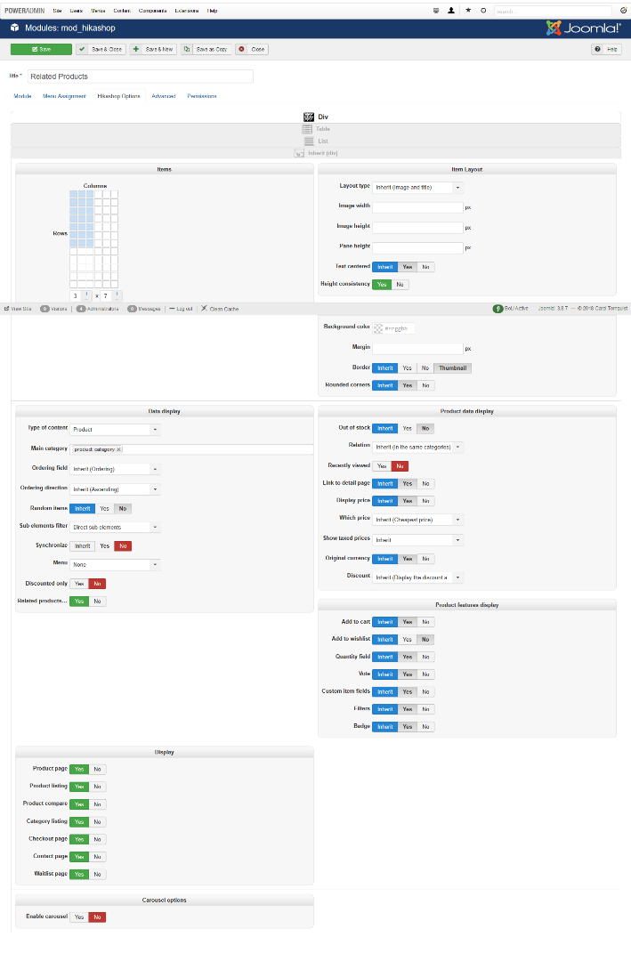

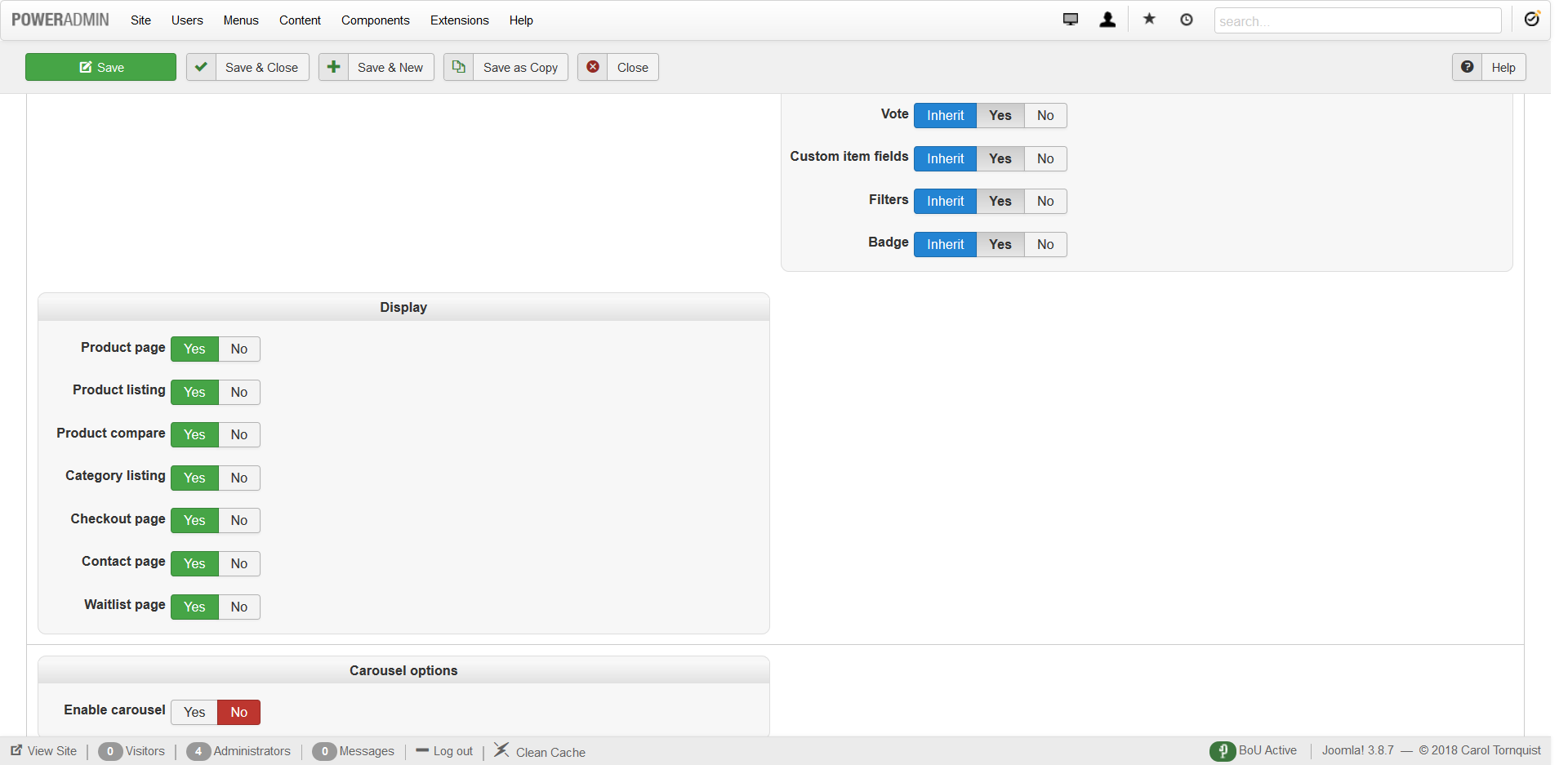

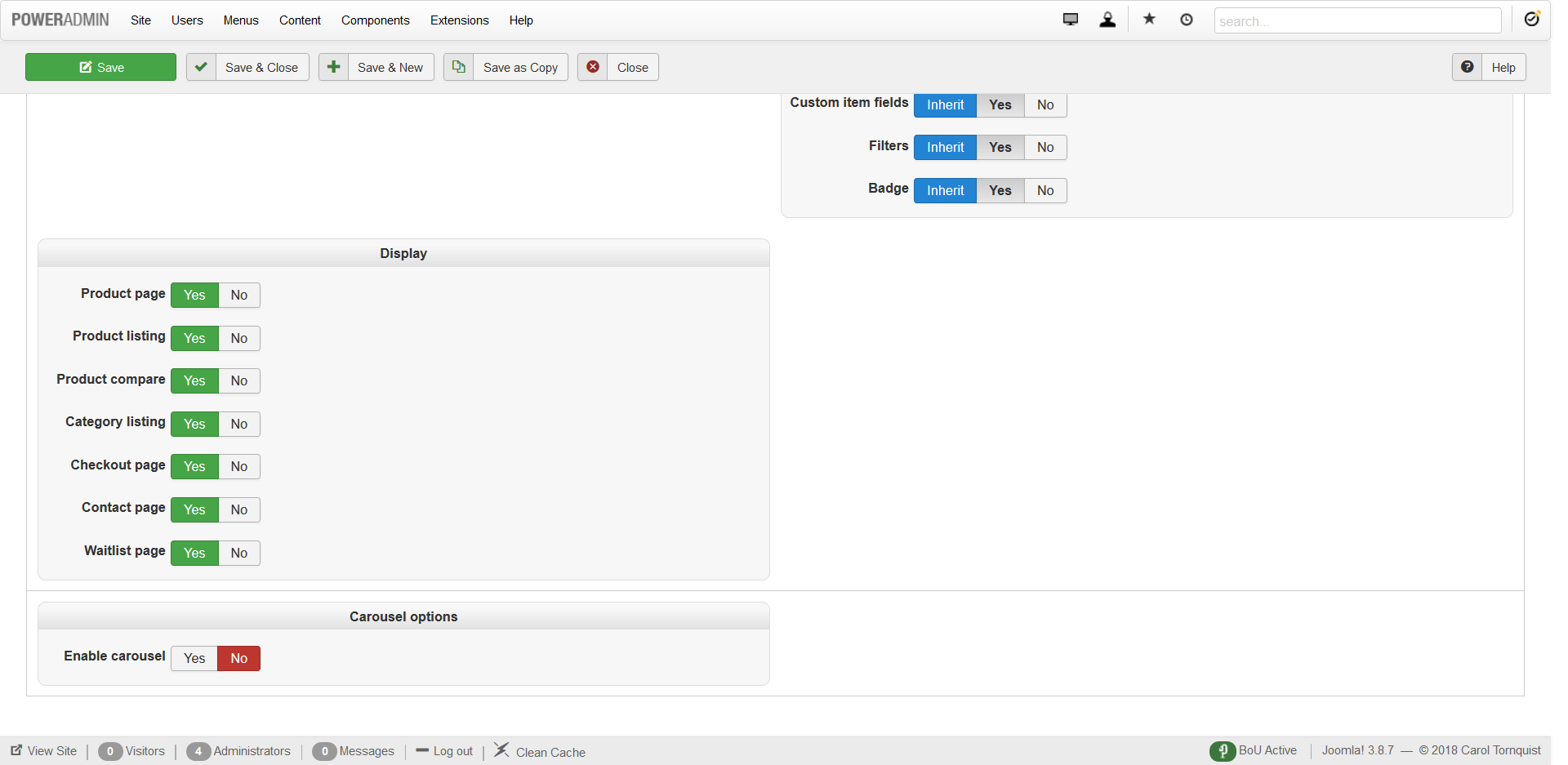

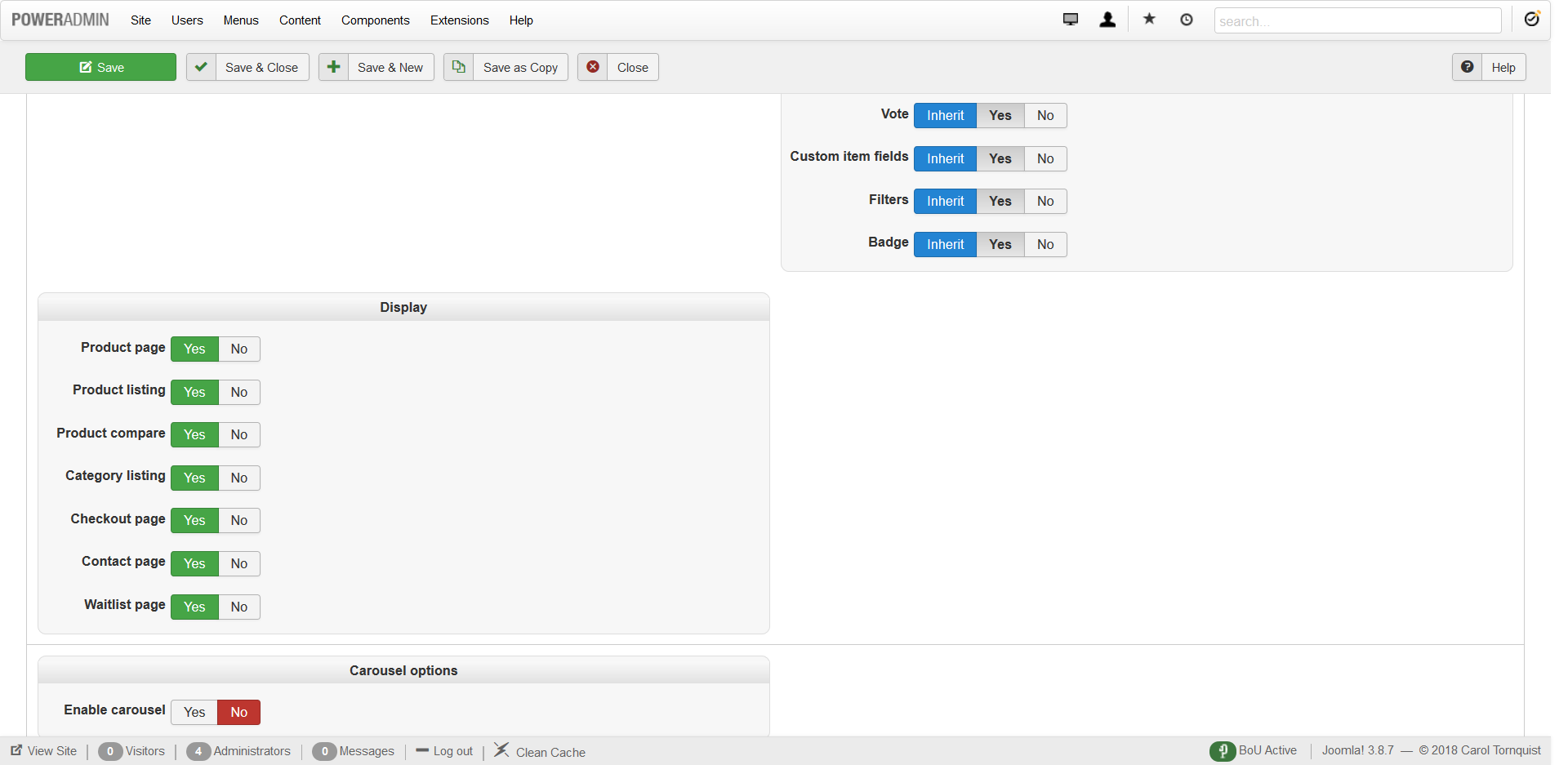

  • Posts: 36
8 years 3 months ago #292793
Here you go :)
Not sure if you can read the one any better now? The image itself is actually in higher definition...I can enlarge it great here on my computer and see everything. But when I insert it here, that definition goes away for some reason...
Last edit: 8 years 3 months ago by heart0.

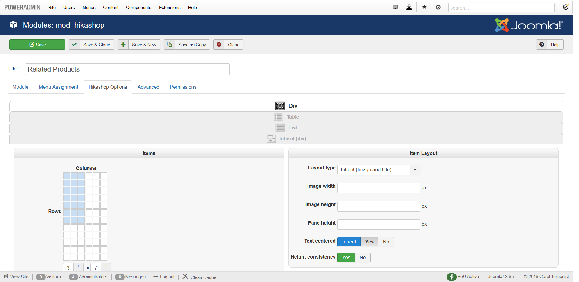

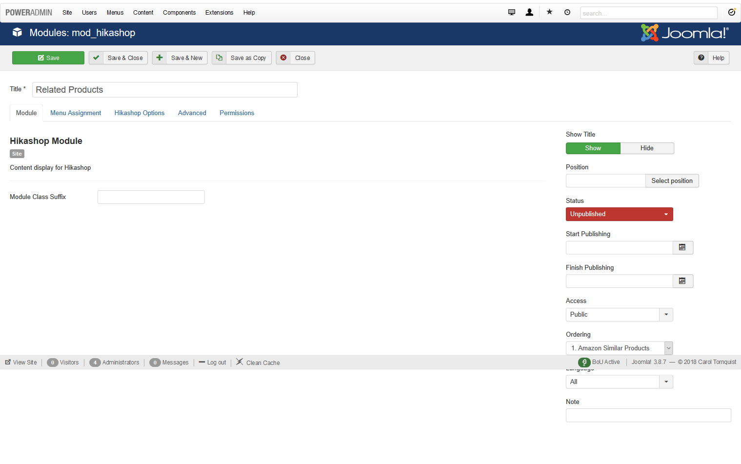

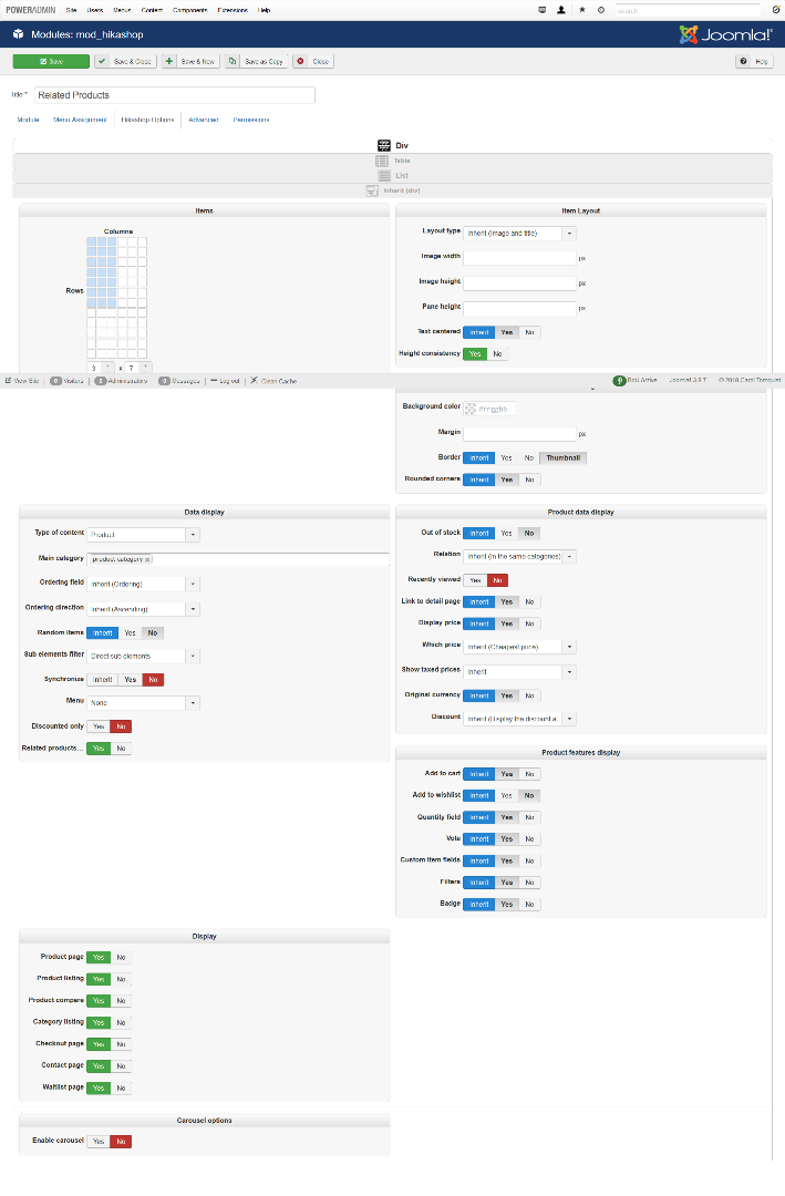

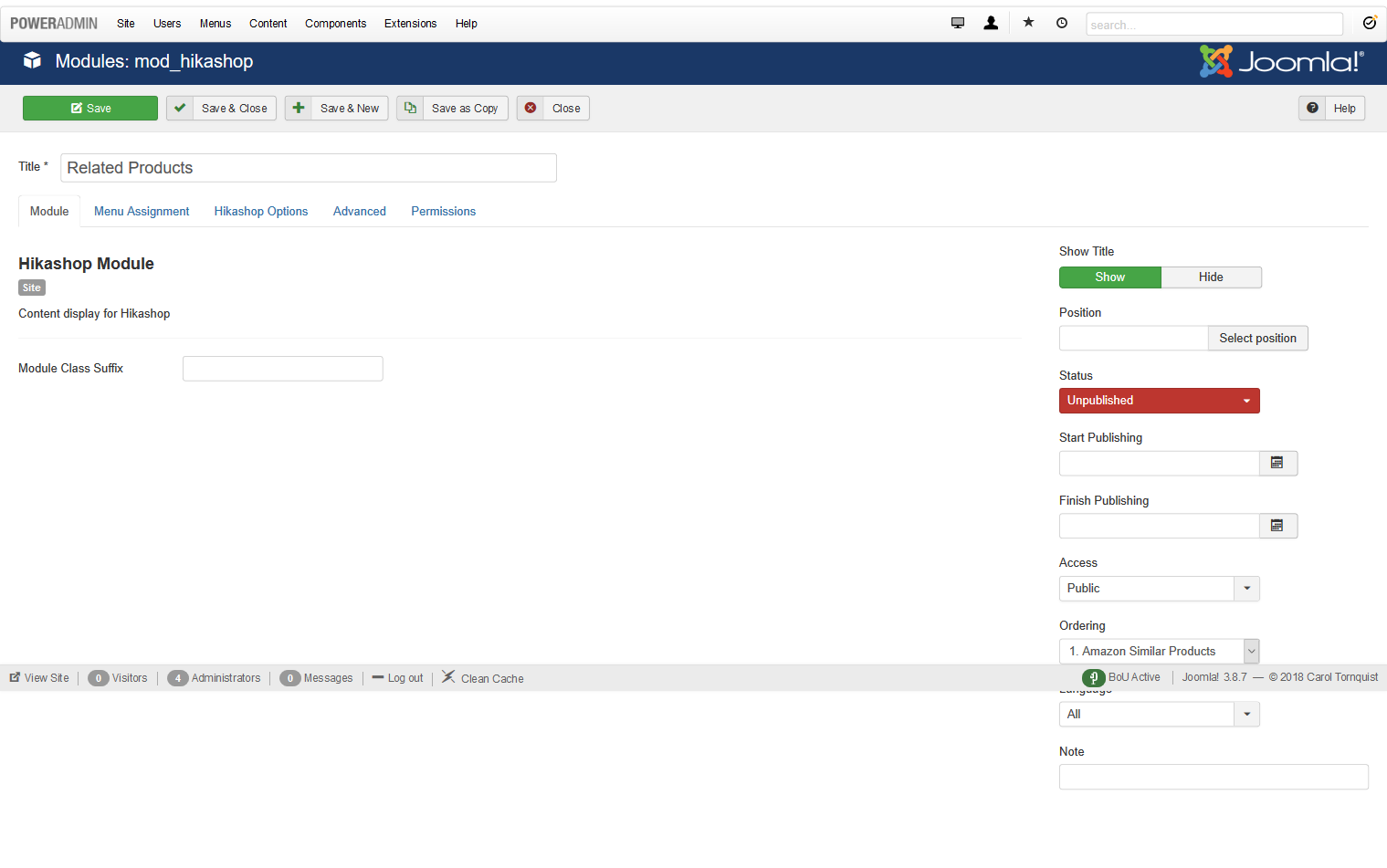

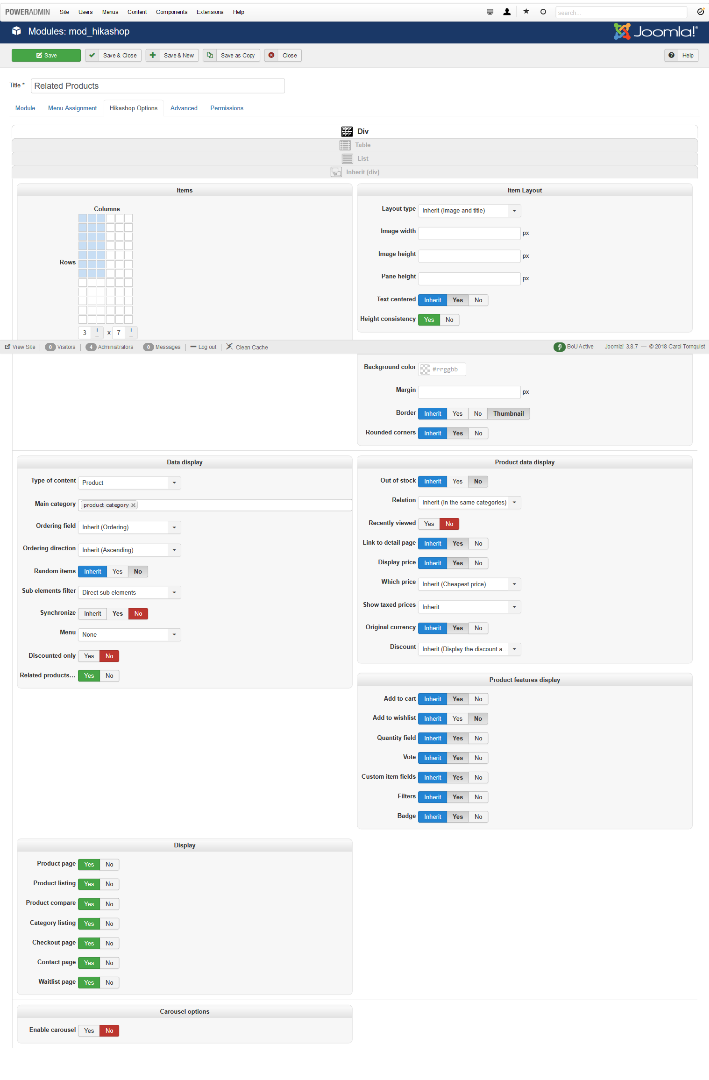

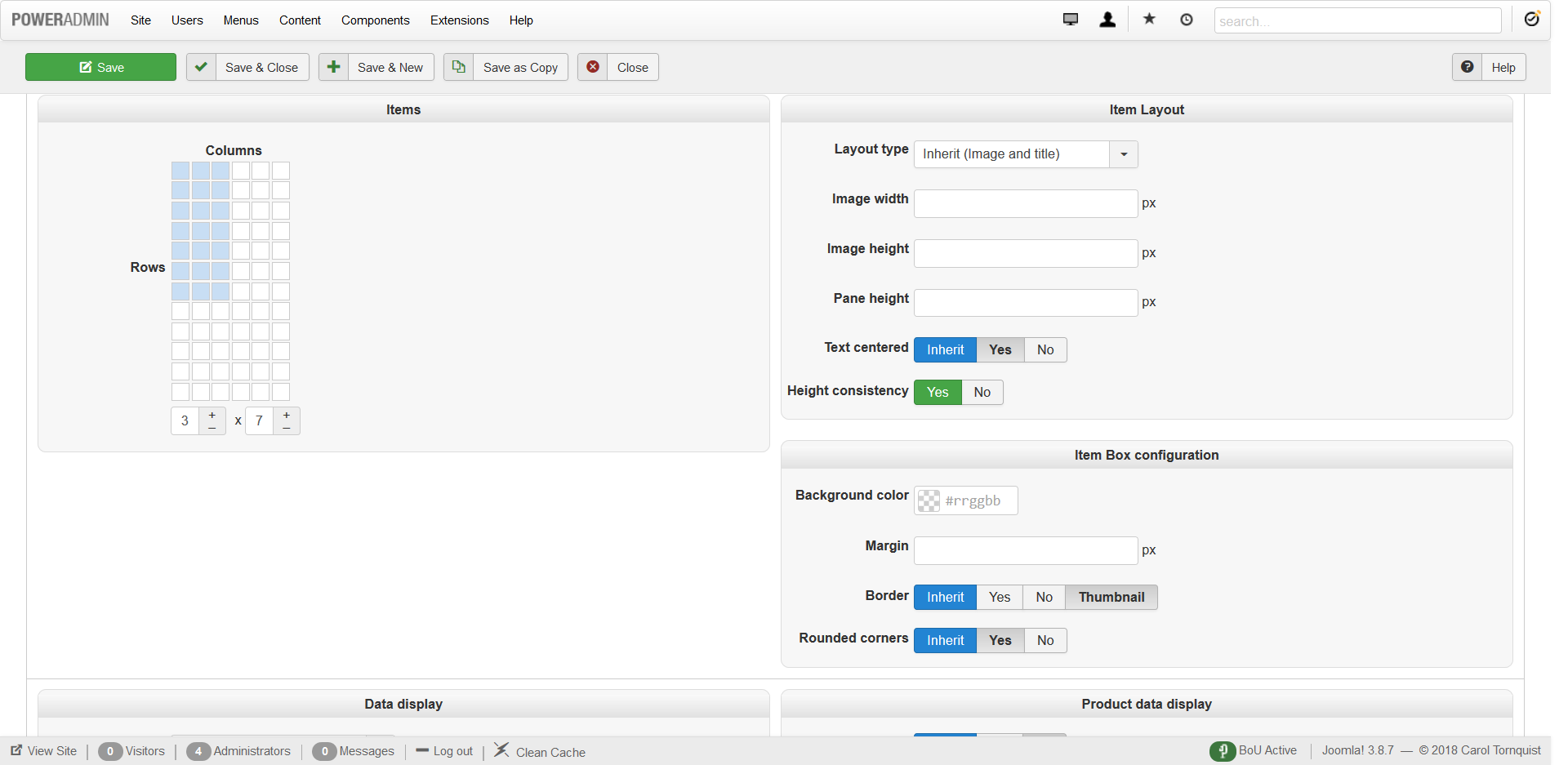

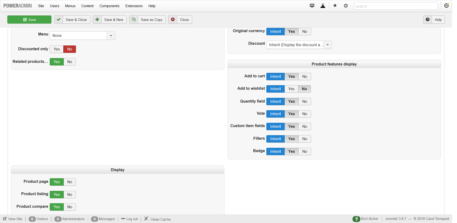

  • Posts: 36
8 years 3 months ago #292794
I went ahead and divided it into 4 parts - so see if that helps :)
  • Posts: 86053
  • Thank you received: 14181
8 years 3 months ago #292795
You have the "related products..." option (complete name is related products of products in the cart) activated in your module and thus in that case, the related products will only display if they are also related to one of the products already in the cart. So you want to turn off that setting.
Also, in the "relation" setting of your module, you want to select "related products". That's this option which allows the module to display related products and not something else.
Finally, in the "sub element filter", you want to select "all sub elements" so that not only the products directly linked to the main category are taken into account but all of them.

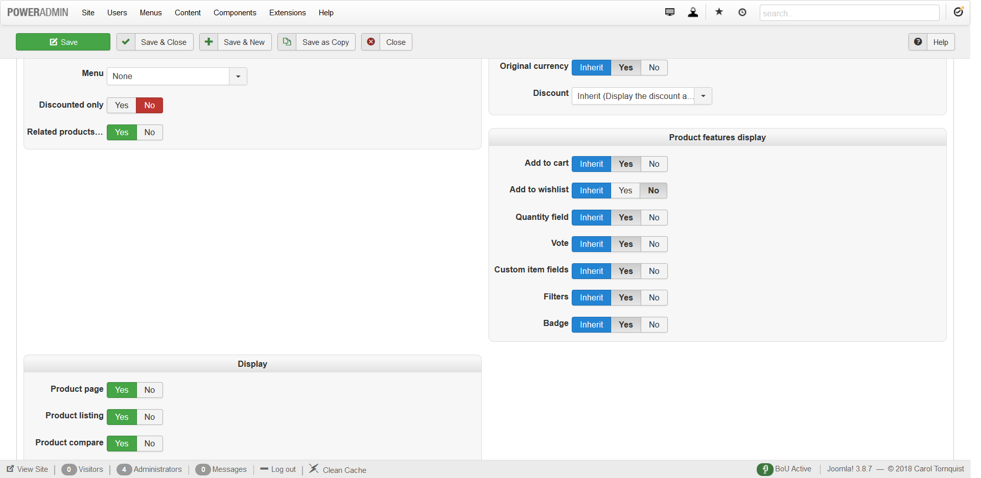

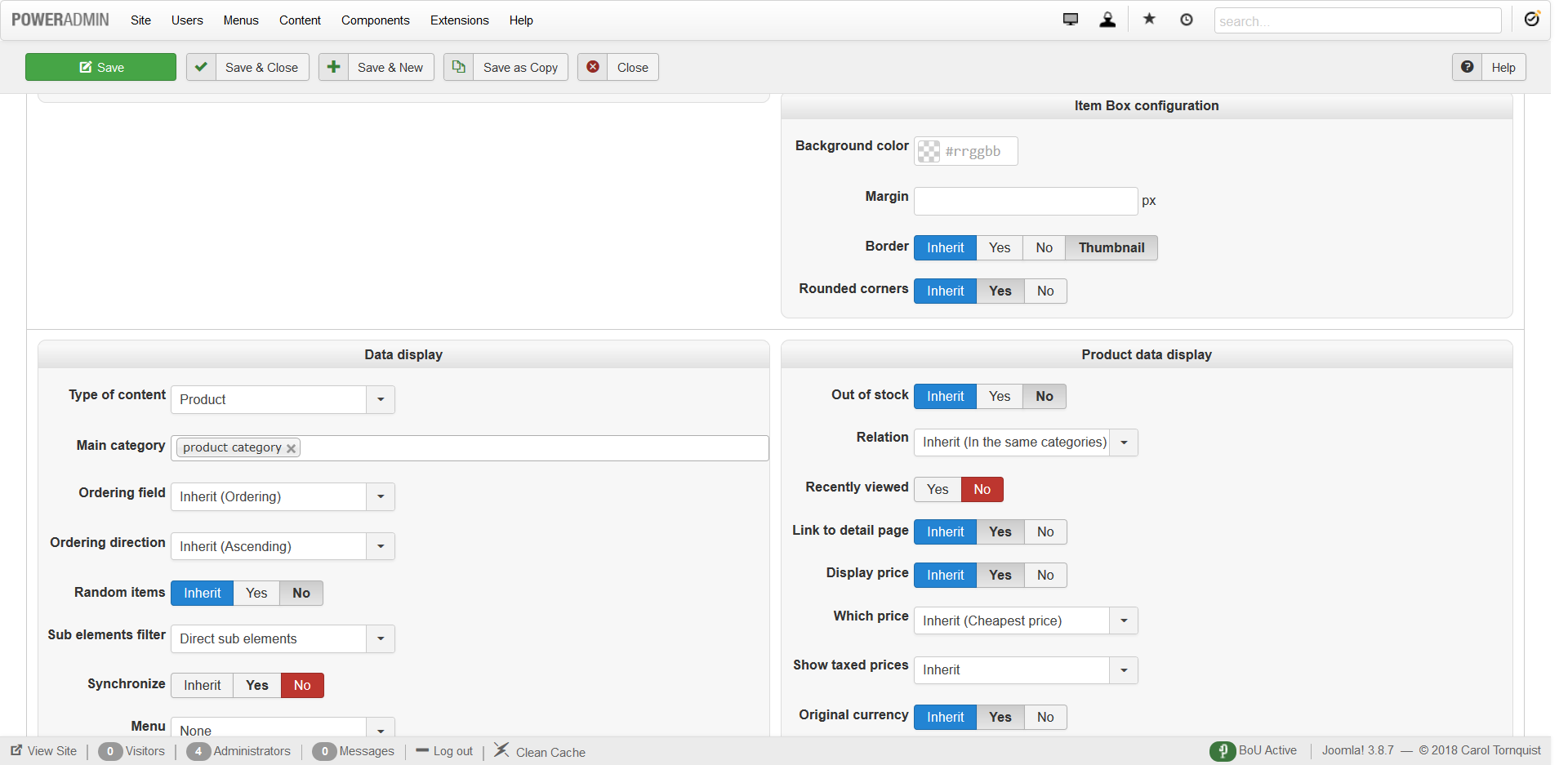

  • Posts: 36
8 years 2 months ago #292981
Here you go...
  • Posts: 86053
8 years 2 months ago #293019
The "synchronise" option must be activated. Otherwise, the "relation" setting will be ignored.
I think it's the last thing missing. The rest is fine.
