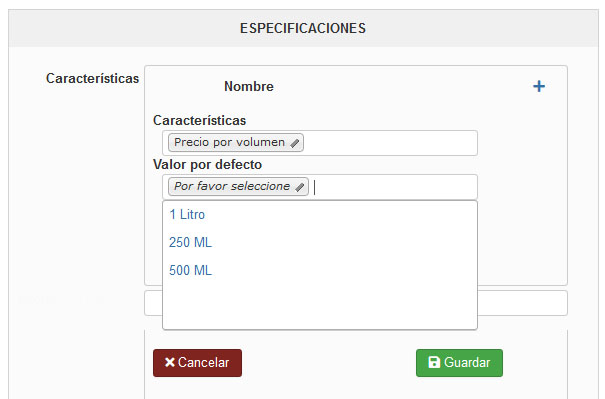

  • Posts: 15
7 years 6 months ago #303631
For me, the solution was to create product variants: 250 ml, 500 ml and 1 liter.
See attached image.
