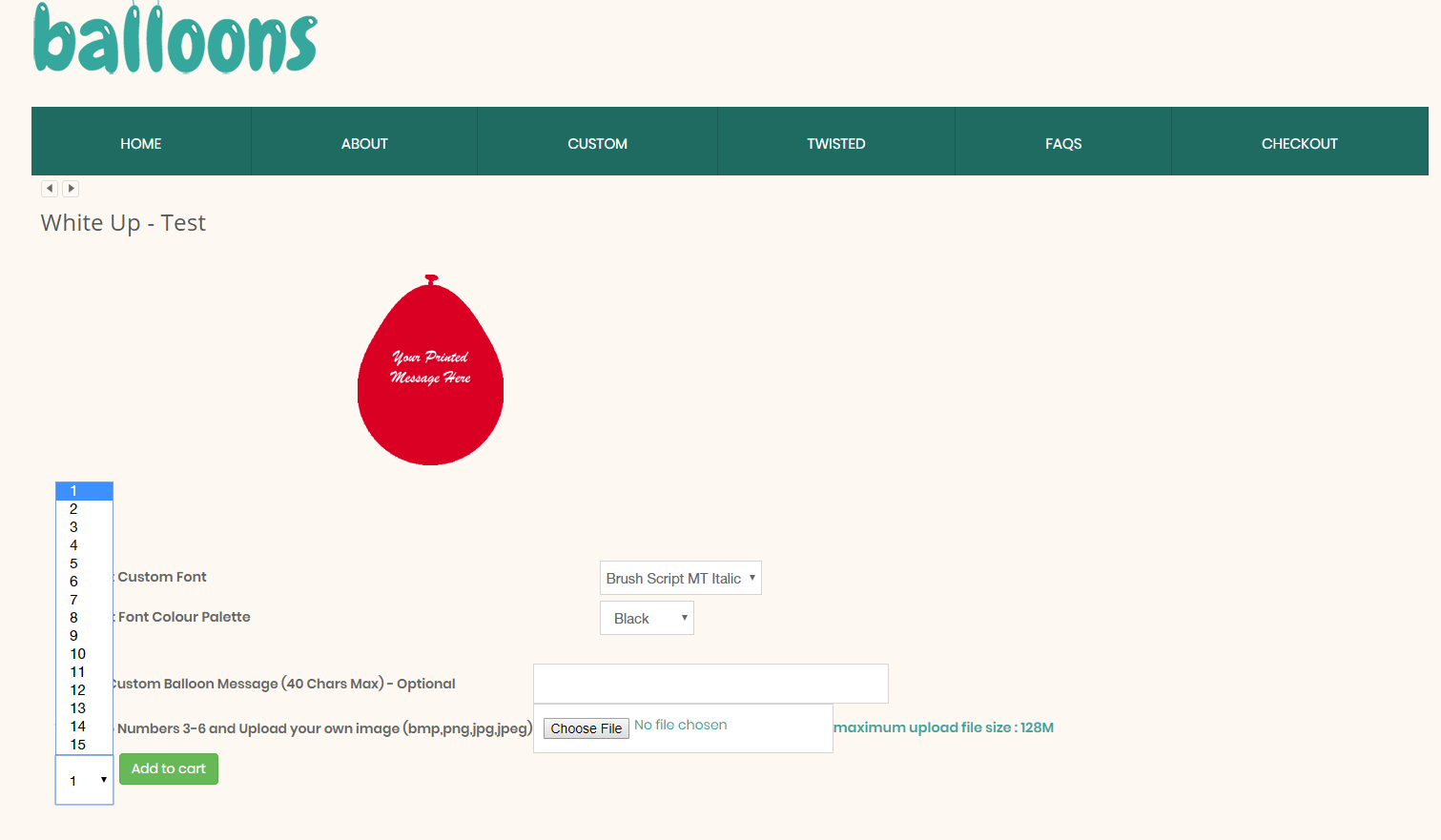

Is there a way with variants or characteristics to set up my products to have a value of 3..6..9..12 or 1000 only
I am trying to setup a Balloon selling site for a client and they balloons in numbers not 1's
Is this possible in Hikashop?

8 years 3 months ago #293877
You could do it with variants and characteristics and hide the quantity input.
But there is better I think.
You could just change the "quantity input method" of the product to "show select" and set the "quantity per order" minimum value to 3 and you would get a dropdown for the quantity of the product with multiples of 3 automatically.

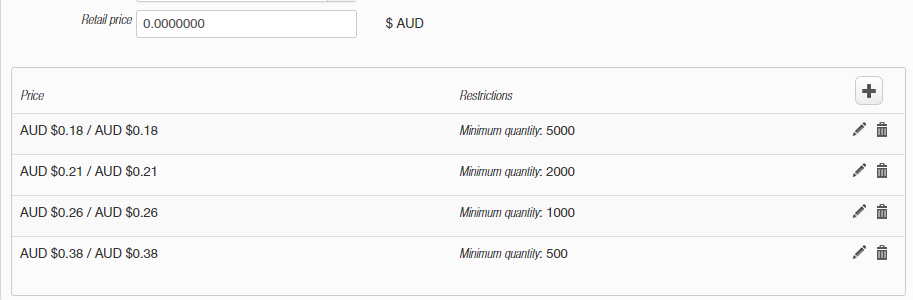

8 years 2 months ago #294829
Then you could select "show select price" isntead of "show select" in the "quantity input method" setting of the product and in the prices list of the product, you can enter the different quantities you want in the quantity dropdown.
Of course, as I said before, you can also use variants / characteristics for that if you want. It's a bit more work to manage the products though.

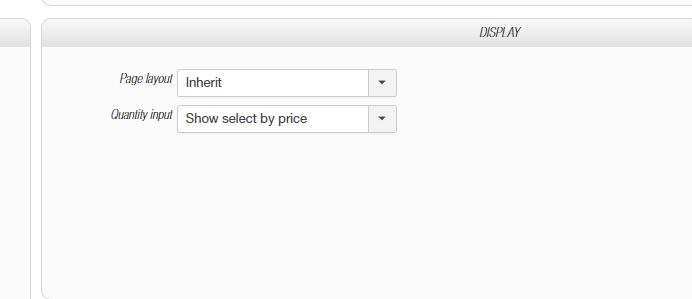

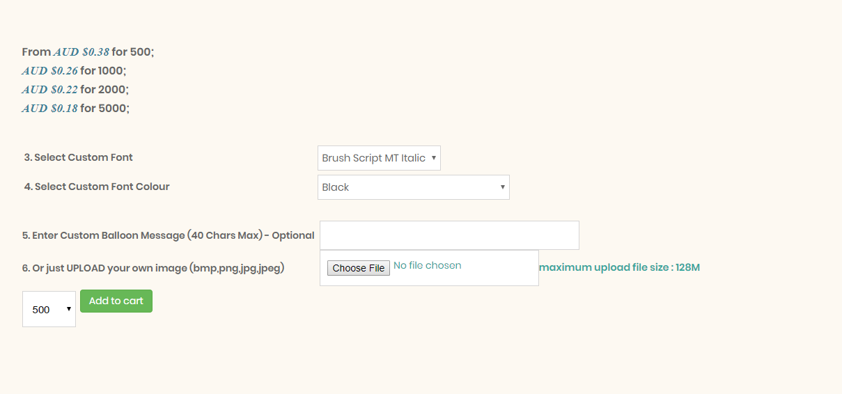

8 years 2 months ago #294903
Thanks Nicolas,
Sorry to be such a pain. But I have attached the images after I set the price and the "Select by Price".
I set the price in the main product, and then the Variant, both return the same result.
Please see attached images.

  • Posts: 86113
  • Thank you received: 14210
8 years 2 months ago #294922
I don't see why it would do that.
Could you provide a link to that page, a backend access and a link to this thread via our contact form so that we could have a look ?

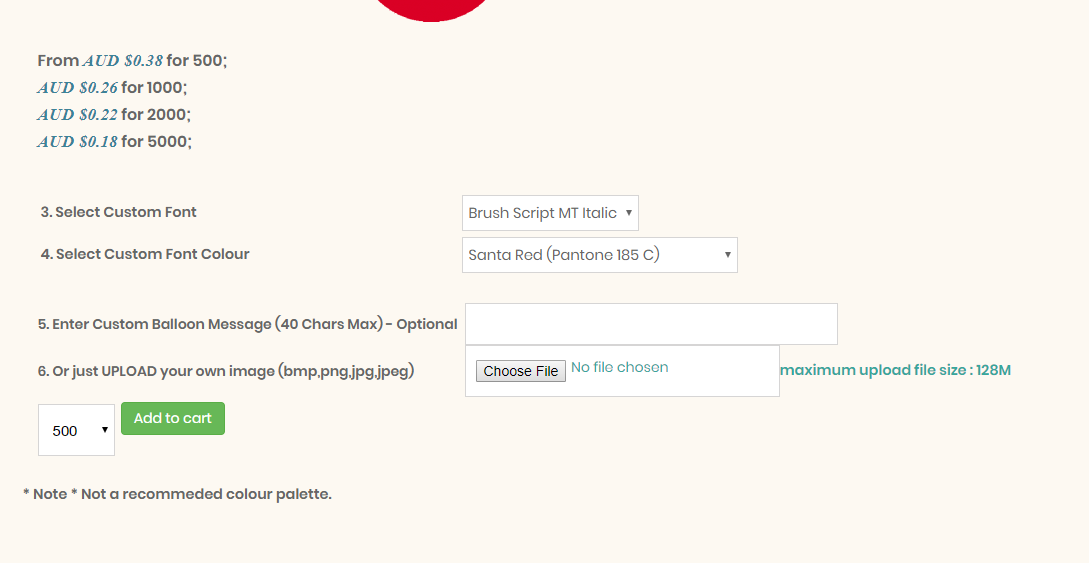

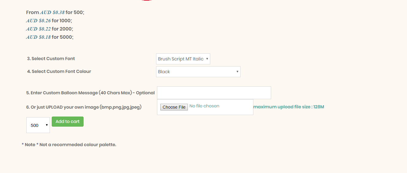

  • Posts: 135
  • Thank you received: 5
8 years 2 months ago #295175
There is no description in the main product.
AS I STATED, its the variant description that is not changing.
Variant #1 Had no description.
Variant #2 Has a description.
Variant #3 Had no description.
When variant #2 is selected the image and description change, when variant #3 is select the image changes, but NOT THE DESCRIPTION.
Has this been over looked ??
variant_desc1 shows variant Black and no description after the add to cart
variant_desc2 shows variant Red and * Note * Not a recommended colour palette
variant_desc3 shows variant Black again and the description from the Red variant is still there !!!
