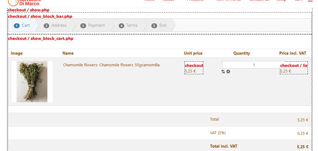

During the check-out process, in the cart step (see printscreen), the variant code is displayed after the product name. How to avoid that? I would like to have just variant name displayed during the checkout process.
One additional question: the width of the quantity field is too long. How to reduce it?

The solution will be to directly set the "Display product code" option to NO through your checkout workflow via "Hikashop->System->Configuration->Checkout".

Hi Mohamed. It works.
What about my second question about the quantity field width? In the cart, this field is too long and it overlap the total price.
I tried to change from 100% to 50% in my css template but it does not work. Maybe I use the wrong css string.. can you please advise?

The issue with the width of that field comes from the CSS of your template.
You can add such CSS to circumvent the CSS of your template:
.hikashop_product_quantity_field{ width 30px !important; }

Although I added the following string, the width of the quantity field is still long.
.hikashop_product_quantity_field input[type="number"]:not(.form-control), select:not(.form-control) {
What is it wrong?

For start we will advice to use a more simple selector, something as :
#page_id .html_element_class {
width: your value;
Sometime some specific selector is of course needed but yours seems to be a little too complicated.

Many Thanks!
