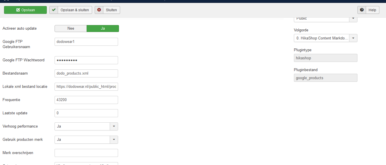

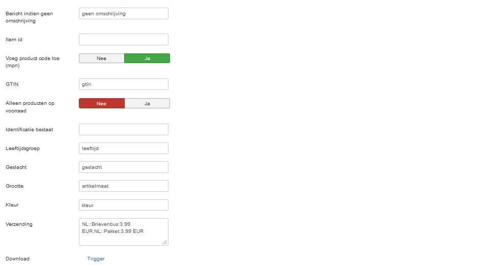

  • Posts: 252
7 years 4 months ago #303499
Hello Nicolas
Hereby 2 pictures of the plugin
I have also sent you a direct mail
  • Posts: 85761
  • Thank you received: 14067
7 years 4 months ago #303514
The settings look fine so I'm not sure.
So since you set the update date to 0, it is still at 0 ?
That would indicate that the plugin is not triggered by the cron.
If the cron is working, then it means that it's not seeing the plugin. And in that case, the only thing left I can see is that you set the plugin access to something else than public, or unpublished it, or something like that.
