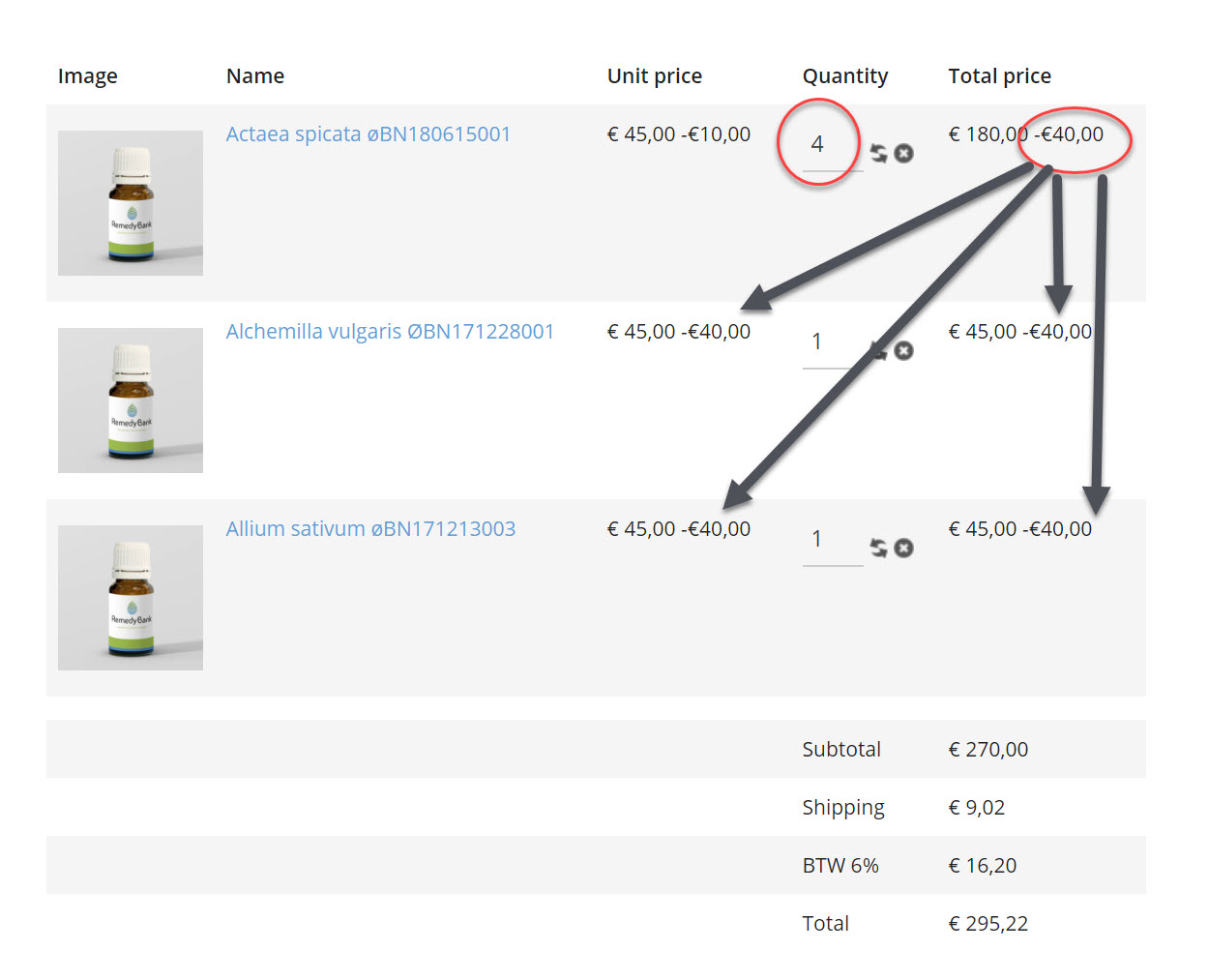

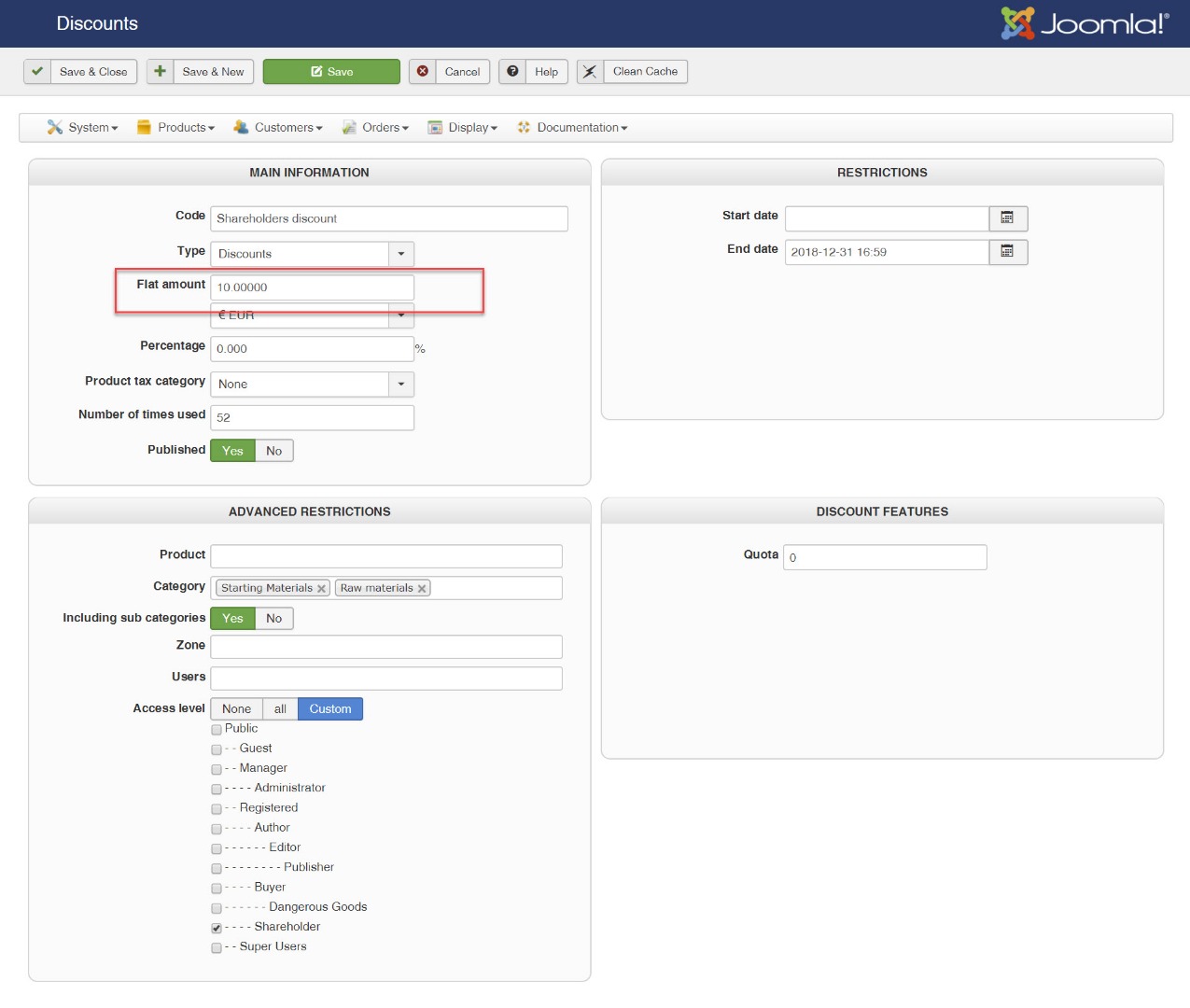

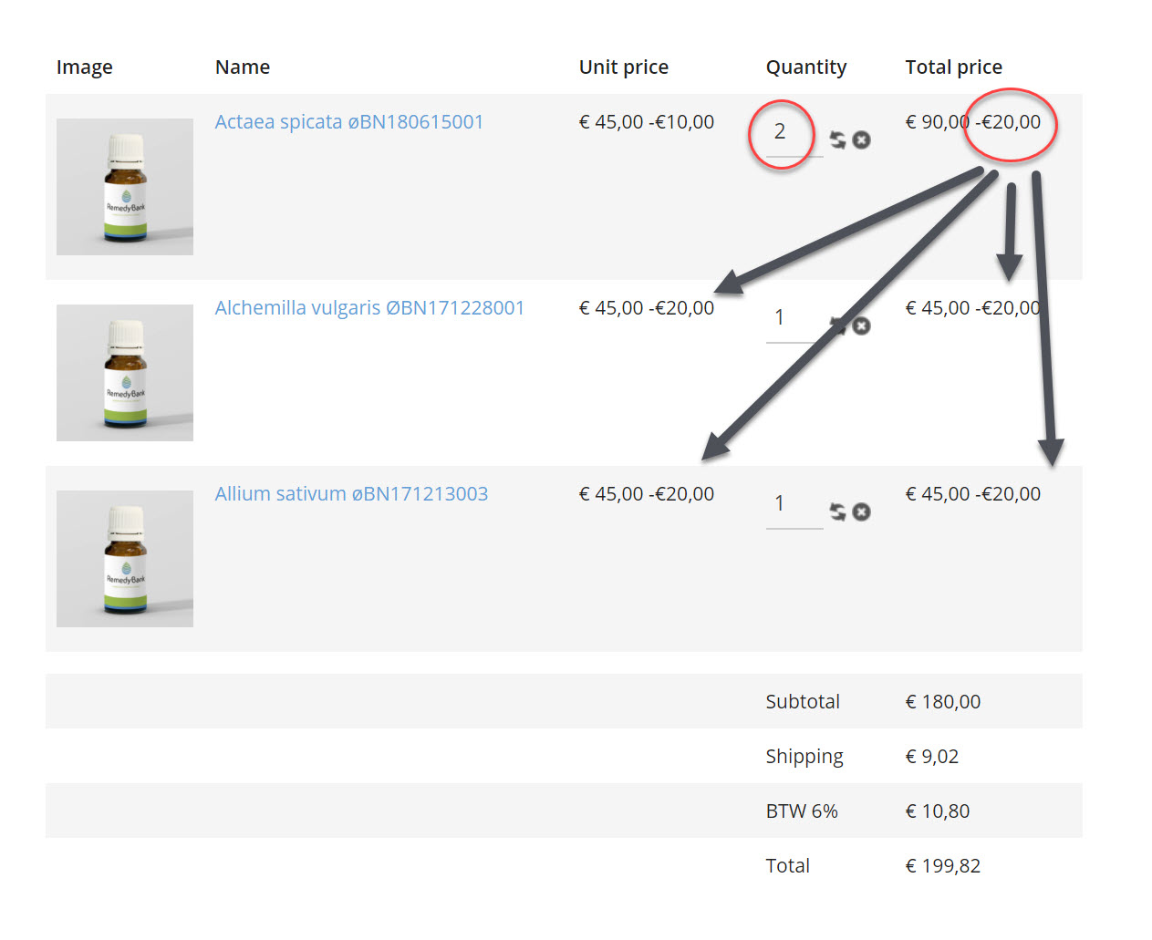

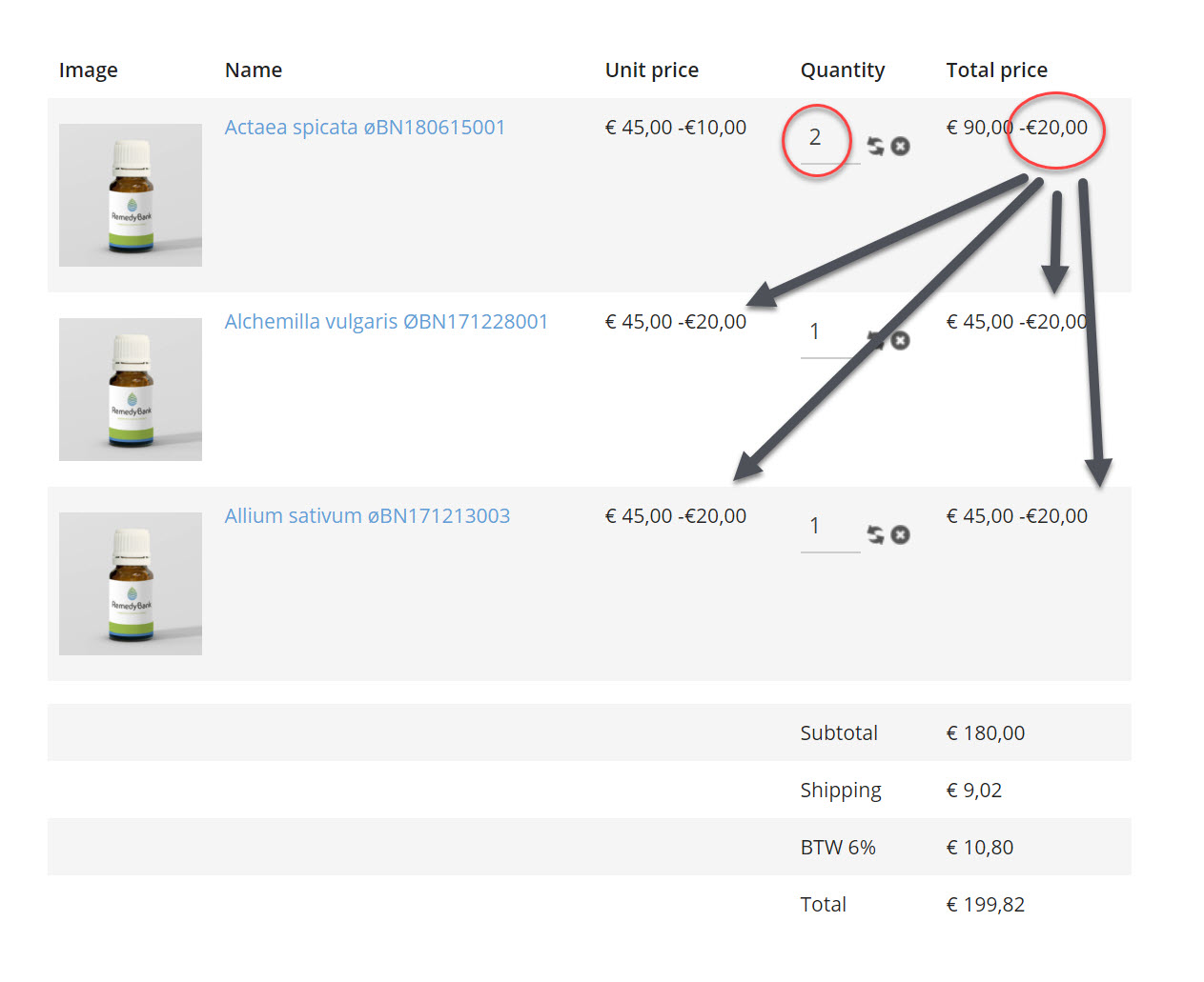

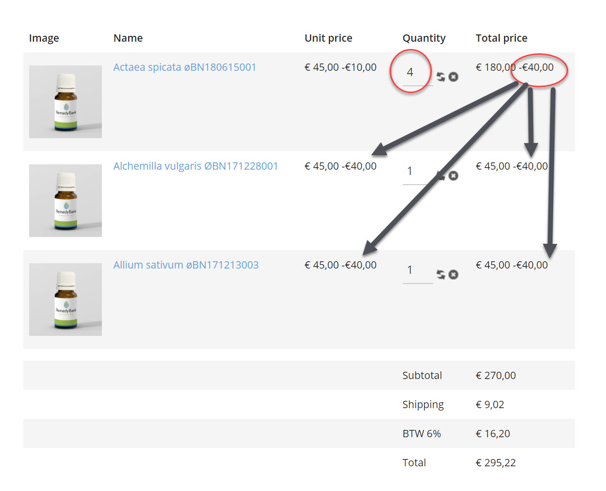

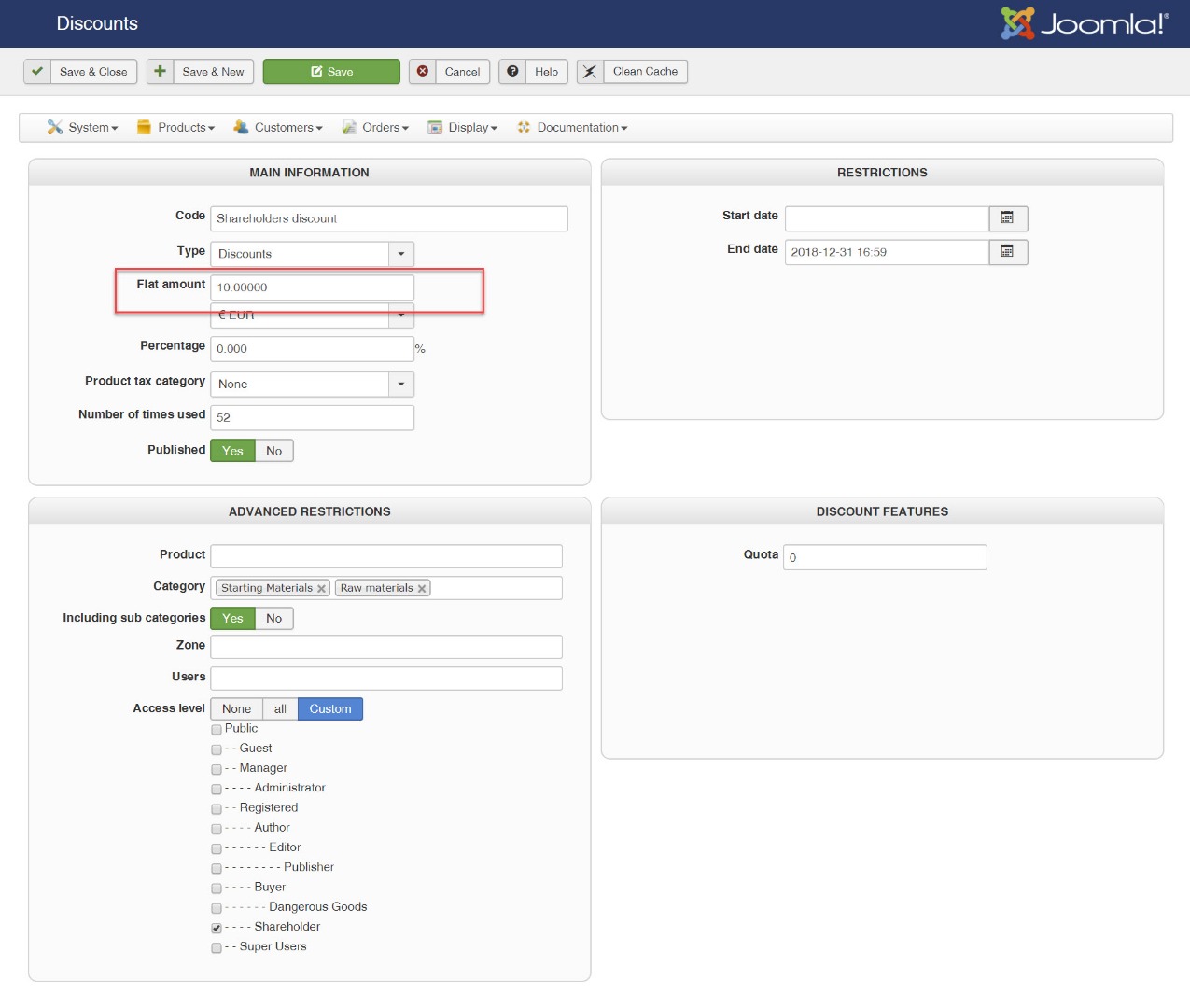

When we have more then one products in the checkout cart and one of the products have more then one items ordered.
I think the discount is not displayed correct. Because the total discount is also set to all the other products.
See screenshot:
Kind regards,
Lumiga
  • Posts: 85762
  • Thank you received: 14068
7 years 11 months ago #295075
Thank you for your feedback.
Change the line:
$product->discount = $discount;
to:
$product->discount = hikashop_copy($discount);
in the file administrator/components/com_hikashop/classes/currency.php and that will fix the problem which happens for products with different quantities when the discount applies to several of them at the same time.
We'll include that patch on our end.
