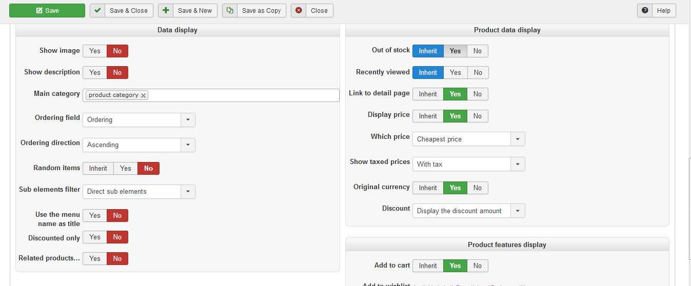

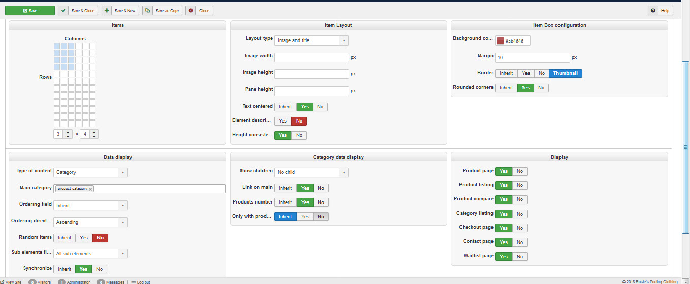

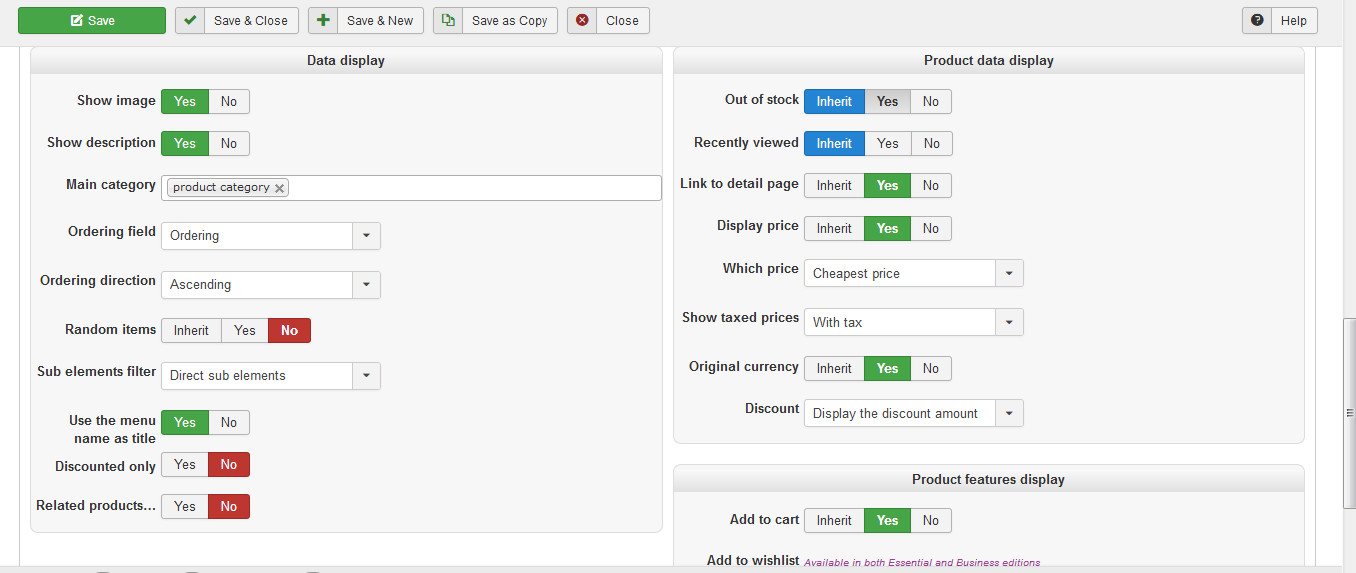

Also, you provided the screenshot of the settings of your module, but the "menu" setting is missing from the screenshot, could you tell us what you have in that setting ? Also, could you provide the settings of the menu item selected in that setting ?
  • Posts: 29
6 years 9 months ago #296205
Your path link is confusing me. There is no html folder inside my templates folder. Its not been required until now. Should there have been one before I installed this extension?
Menu settings:
1. HikaShop 1stModule is asssigned to "Hikatest" menu only.
2. Underneath "synchronize" in the module data display settings the menu is also set to "Hikatest"
I've attached two different settings for the "Hikatest" menu. Both use "Products Listing" as the menu item type.
