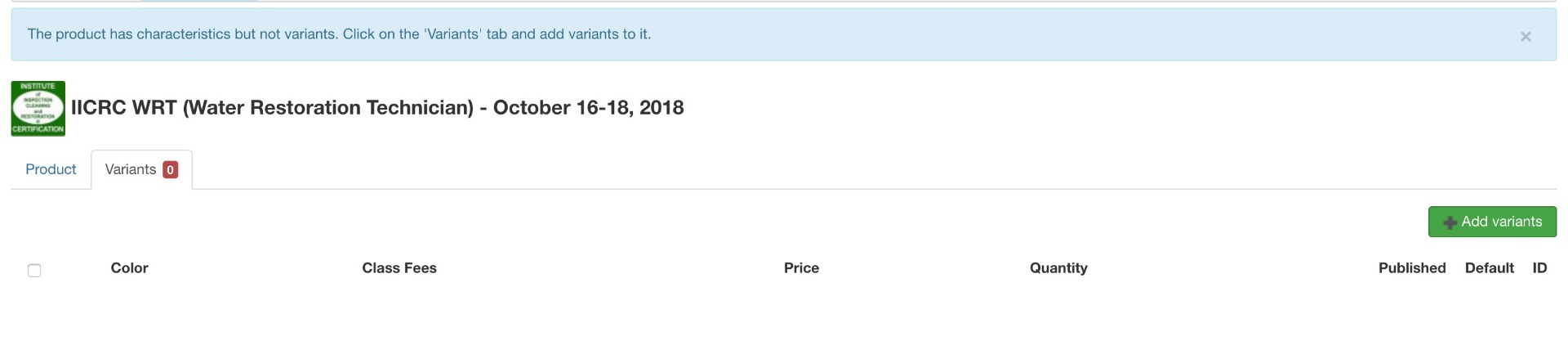

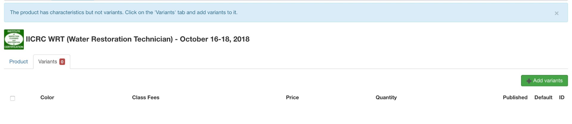

I believe I've fully followed the instruction on how to add a variant to a product. But, when I go to the "Variant" tab in the product and try to "add variant" after selecting the options... I click "Save"... and NOTHING??? The page just refreshes and nothing adds or shows on the product page.
Any help would be greatly appreciated. I can send login info via if it would be needed?

7 years 10 months ago #296217
I didn't change anything in any database tables? I've attached the screen shot you requested and also sent you (via contact form) cPanel access so you can take a look at the database.

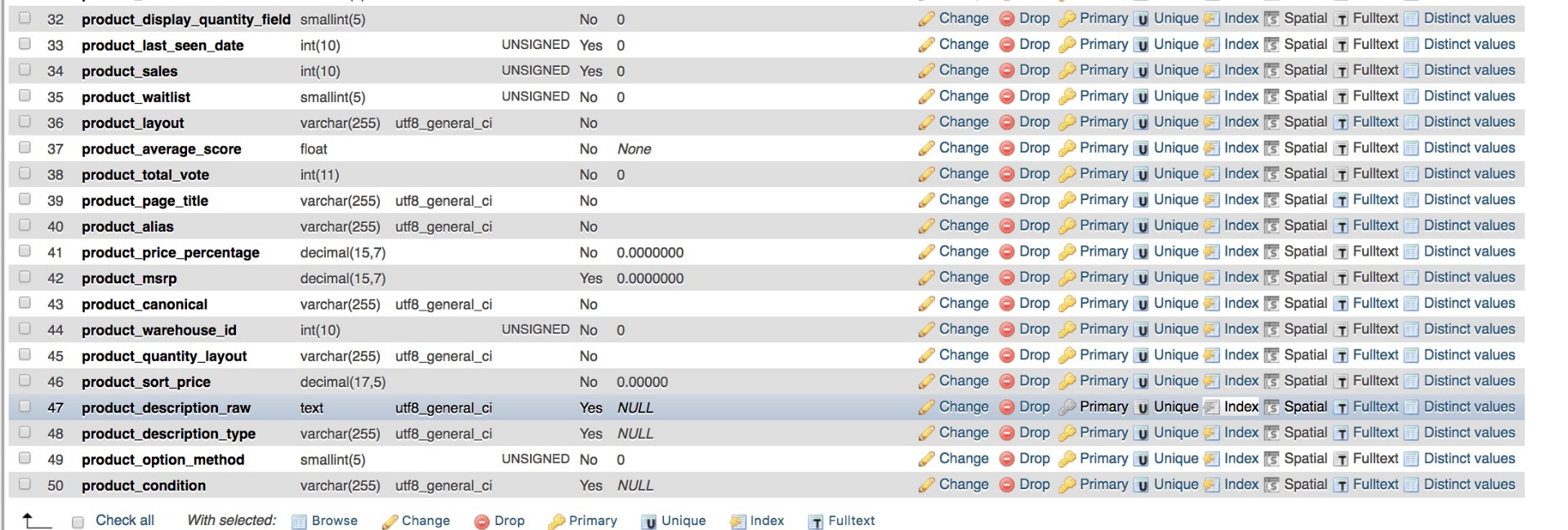

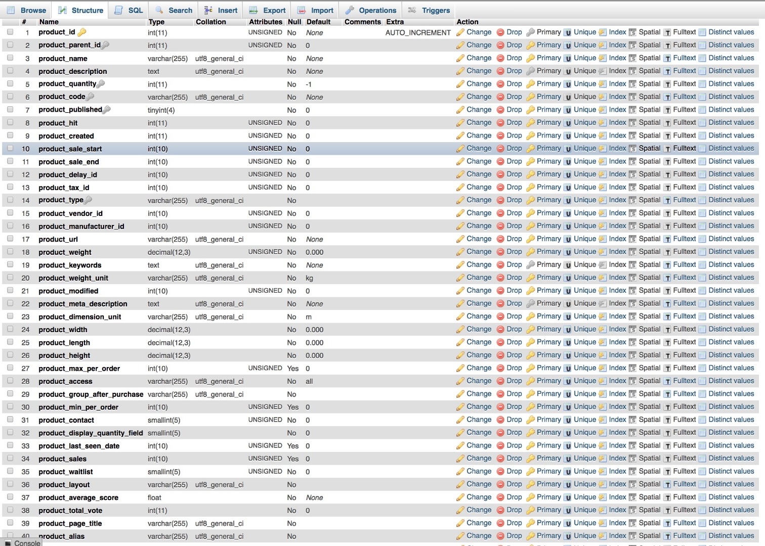

So if I check your phpmyadmin, the highest value for the product_id in the hikashop_product table is 496:
monosnap.com/file/tLPKYKABpnS4PkOyuyW4vv2wXbzgO5
However, if I look at the information area of the table, I can see that the auto_increment value has been set to the value 4,294,967,296 which is invalid as it goes about the type (integer of 11 numbers) of the product_id column.
So I've updated your auto_increment value to 497. After that, everything worked again as it should:
monosnap.com/file/b8N3ytZ23f9klpDgkJANzbvqfpwr8W
So someone or something changed that value. If it's not you, it could some kind of database optimization extension or script gone awry.
