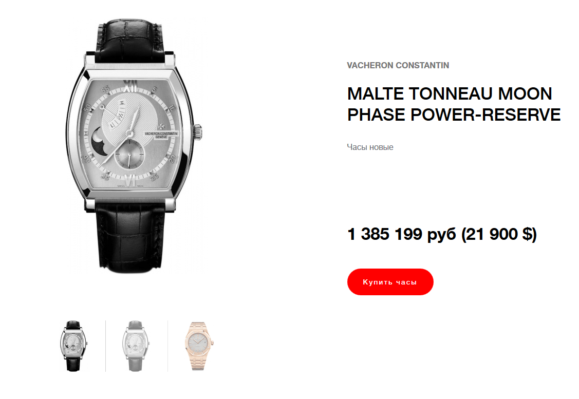

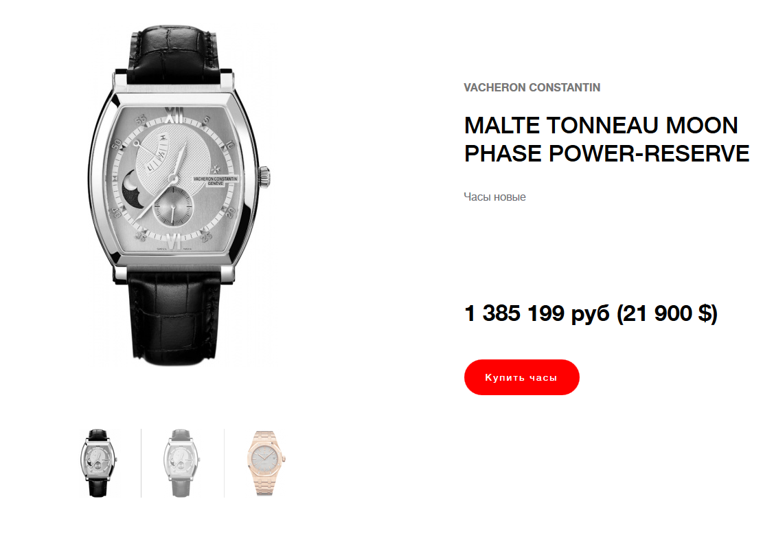

I need to display price in three currencys (roubles, dollars and euros).
If I choose to show main price in dollar it is ok converted to roubles and it is ok.
But if I add price in euro it doesn't even show!
