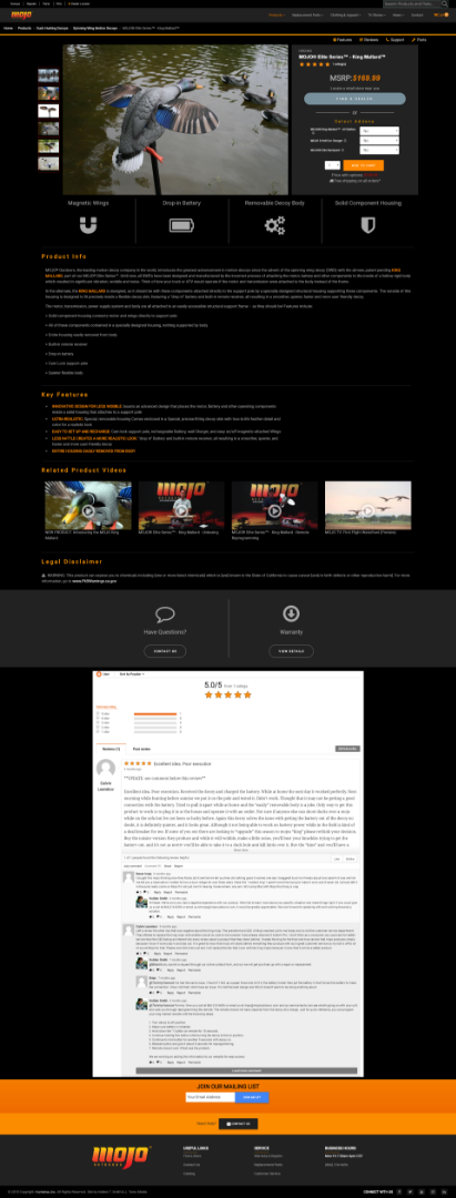

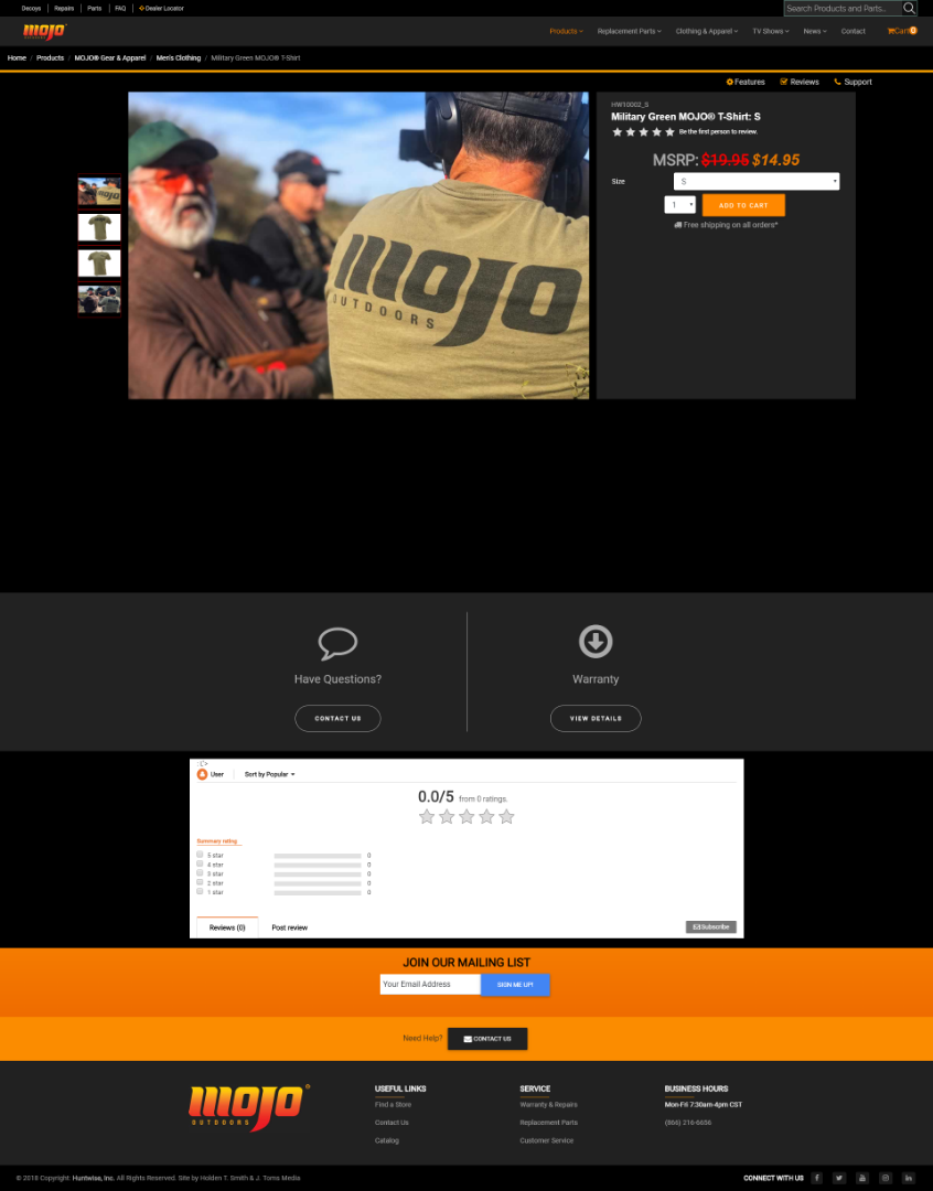

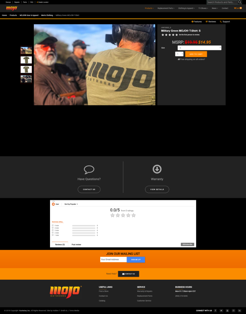

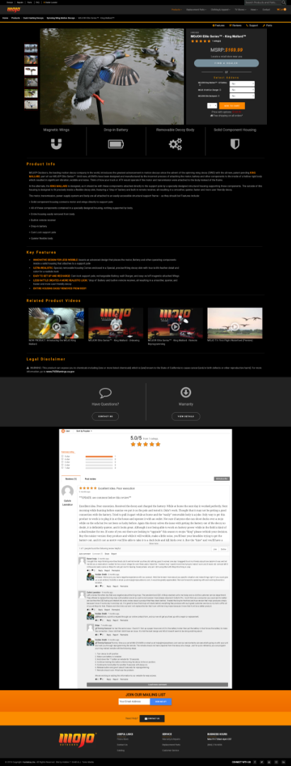

I have a mobile carousel that displays fine for most of my products. I.e., displays normal on desktop then has a bootstrap slider on mobile/tablet.
Example: www.mojooutdoors.com/spinning-wing-decoys/mojo-king-mallard
However, for products with variants, the bootstrap carousel display, but the images are duplicated below the description for some reason. This only occurs for the products with variants.
Example: www.mojooutdoors.com/products/product/70...category_pathway-135
Any thoughts on why this is occurring for the variant products only? Also, i should note that I do not have images for the product variants. They are all on the main product page.

7 years 11 months ago #297920
It only displays on the mobile version, not desktop.
I use simple css rules to hide the carousel on desktop, as well as, hide the normal image display with thumbnails on mobile. Does this make more sense? Sorry for the confusion.
