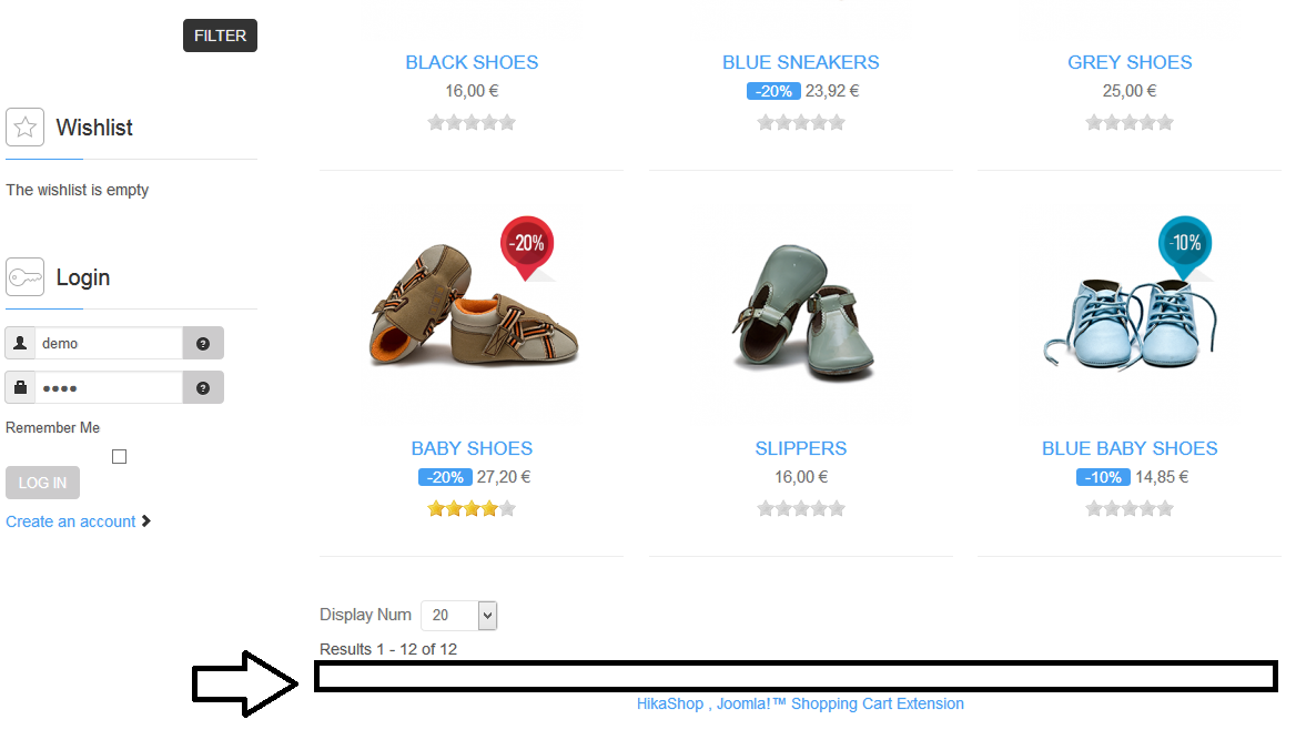

By default the category description box is showed at the top of the page. Which is good, but I would like to create a second category description box underneat the page, just above the pagination (see screenshot). I managed to realize this at former websites, unfortunatly i could not provide an example. I used this threat to accomplish this: www.hikashop.com/forum/product-category-...e-category-page.html . But at the latest version of hikashop this solution provides me an error. So help is much needed.
i created a custom field with table: category, field type: text area.
But i need it to show at the productlisting page. Which i probabaly need to edit the com_hikashop/views/product/tmpl/listing.php ?
