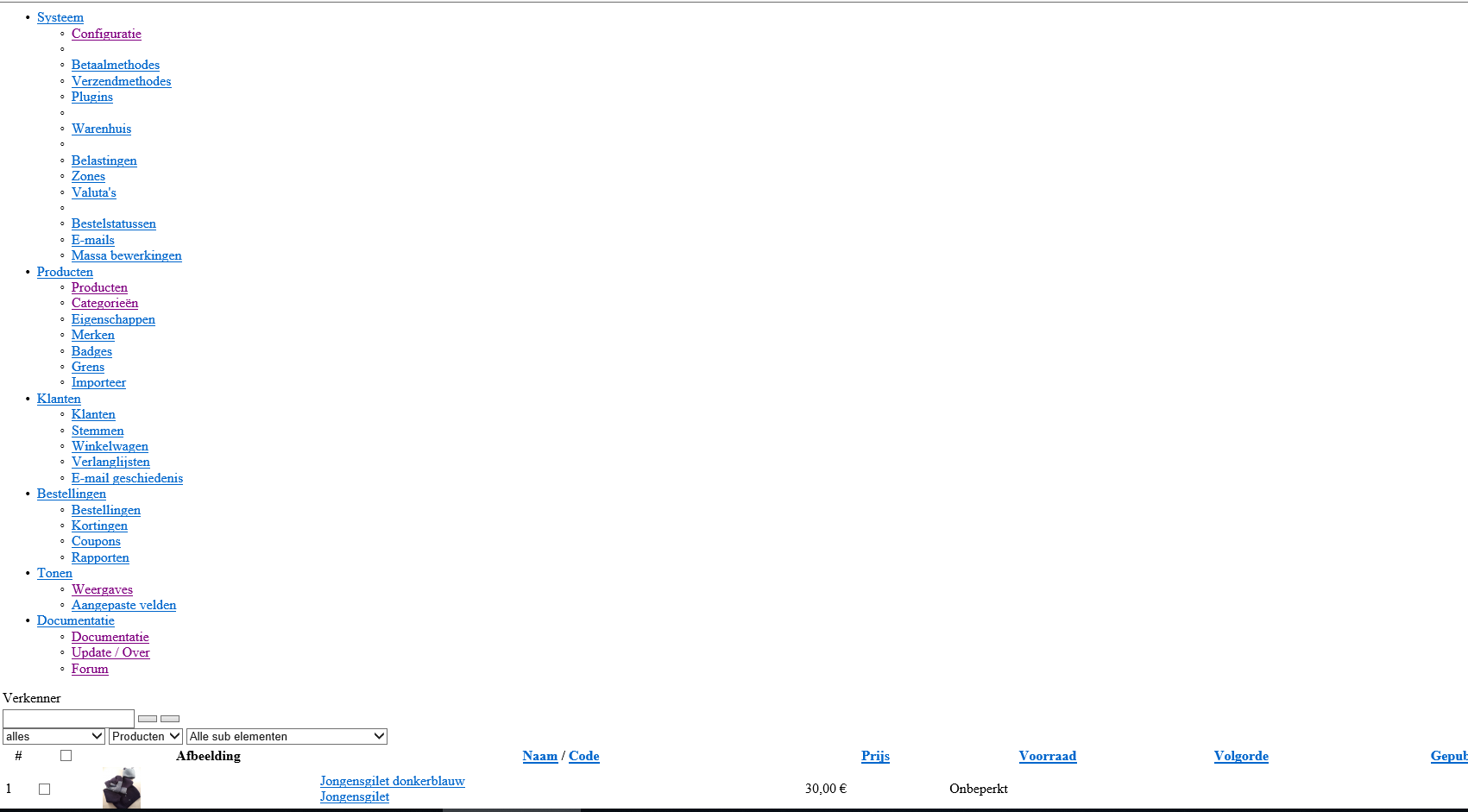

Since recently I'm experiencing the following problem when I click on the products tab in the Hikashop backend the layout is all messed up (see screenshot) what can I do to change this?
Thank you in advance.

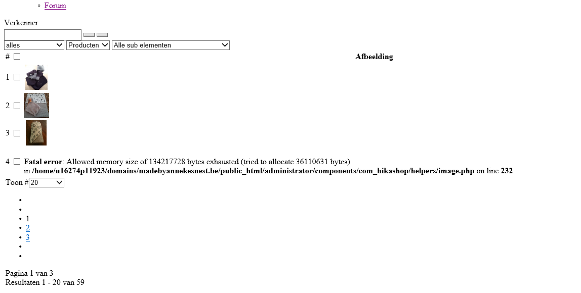

This indicates that you have a fatal error.
Please enable the "error reporting" and "debug mode" settings of the Joomla configuration and check the error message that will appear at the bottom of that page.
Please provide that error message and we should be able to tell you what to do.

Thank you I managed to turn on error reporting and the following is shown.

I found the problem.
someone had uploaded 2 images of 15mb which are ofcourse too big.
I managed to find and delete them and now it works again.
Thank you for your help.
