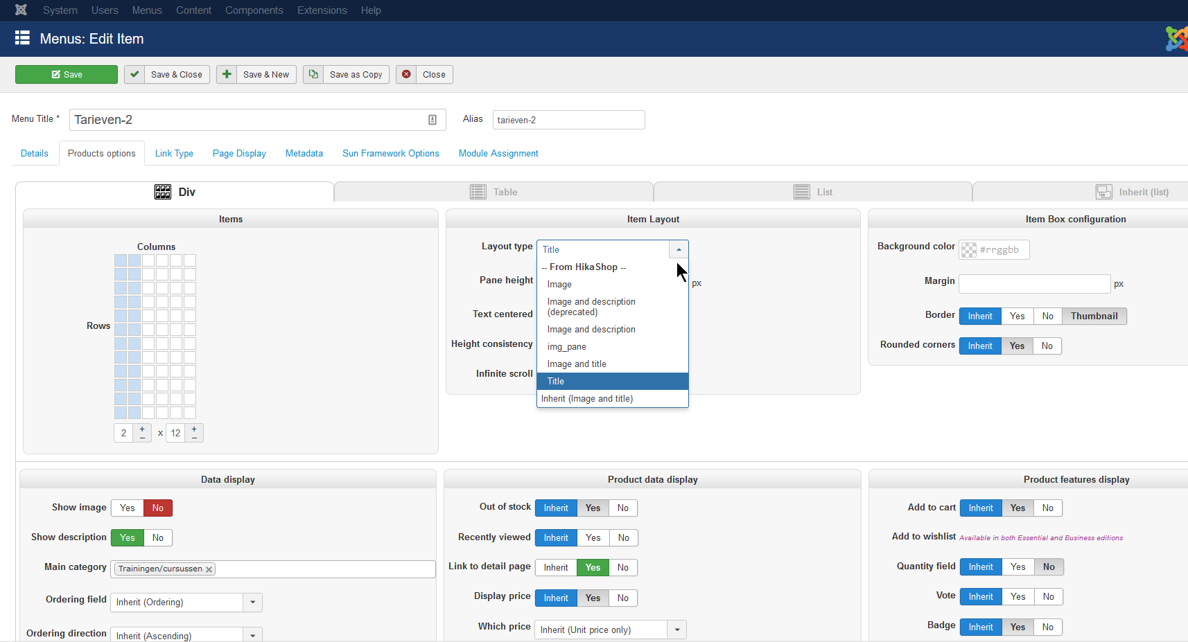

  • Posts: 20
7 years 8 months ago #301108
I think I have choosen the correct settings, but there is no option for Title and description.
For the menu item I select Product List.
And at the Product Options tab I set it as you can see in here:.
Is that the same as you wrote about?
Best regards,
Wouter
  • Posts: 20
7 years 8 months ago #301112
OK never mind.
I figured it out by changing the grid (Columns) to 1 x 12 in stead of 2x12.
Best regards,
Wouter
