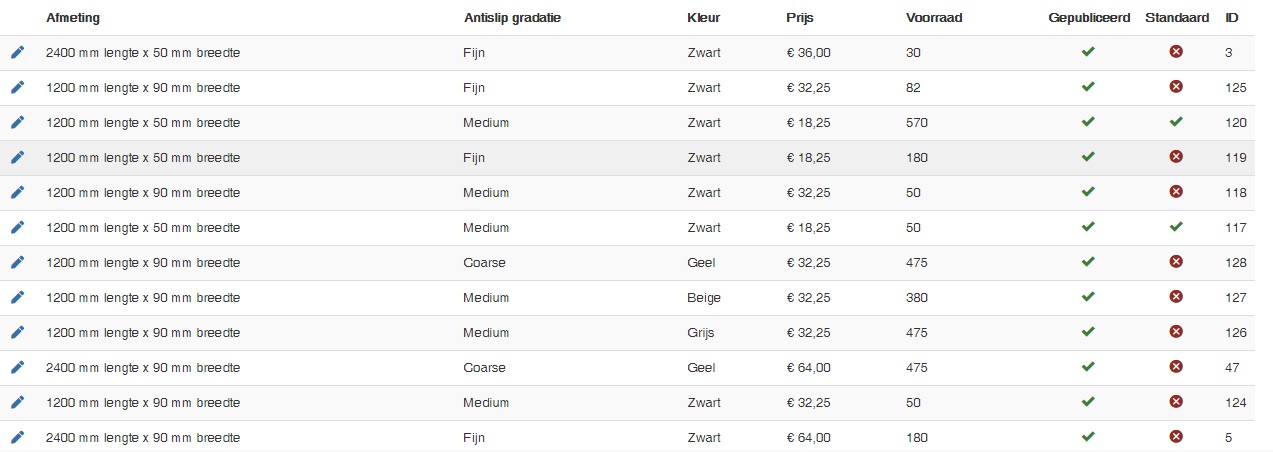

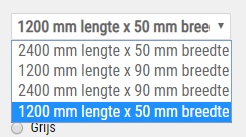

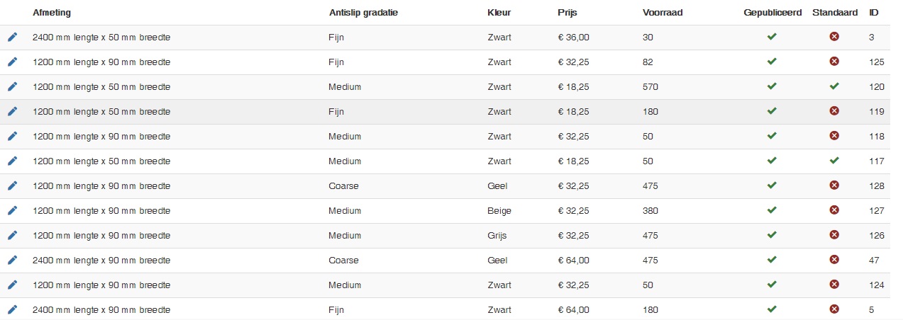

I have a question about the ordering of the variants...
My client is selling anti slip strips and they come in different sizes. I want that the sizes will be presented from small (1200mmx50mm) till large (2400mmx90mm).
I don't know how to control the order, because when I created all variants everything looks just randomly added.
I hope you know what I mean and I hope you can help me with that :-).
Martijn
  • Posts: 86052
  • Thank you received: 14180
7 years 7 months ago #302366
The order depends of the order of the values in your characteristics. So edit the characteristics and check the "order" column of your values listing.
If you left 0 as it is by default, the order is indeed random.
