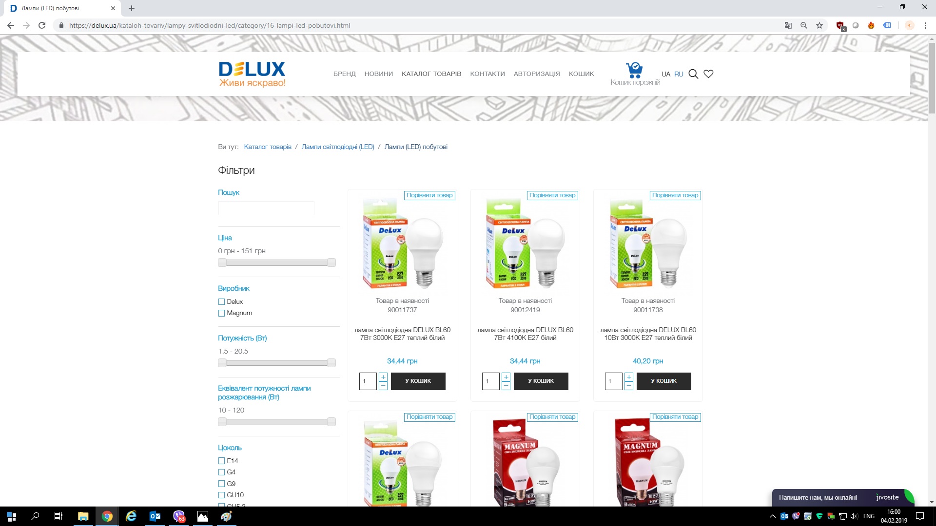

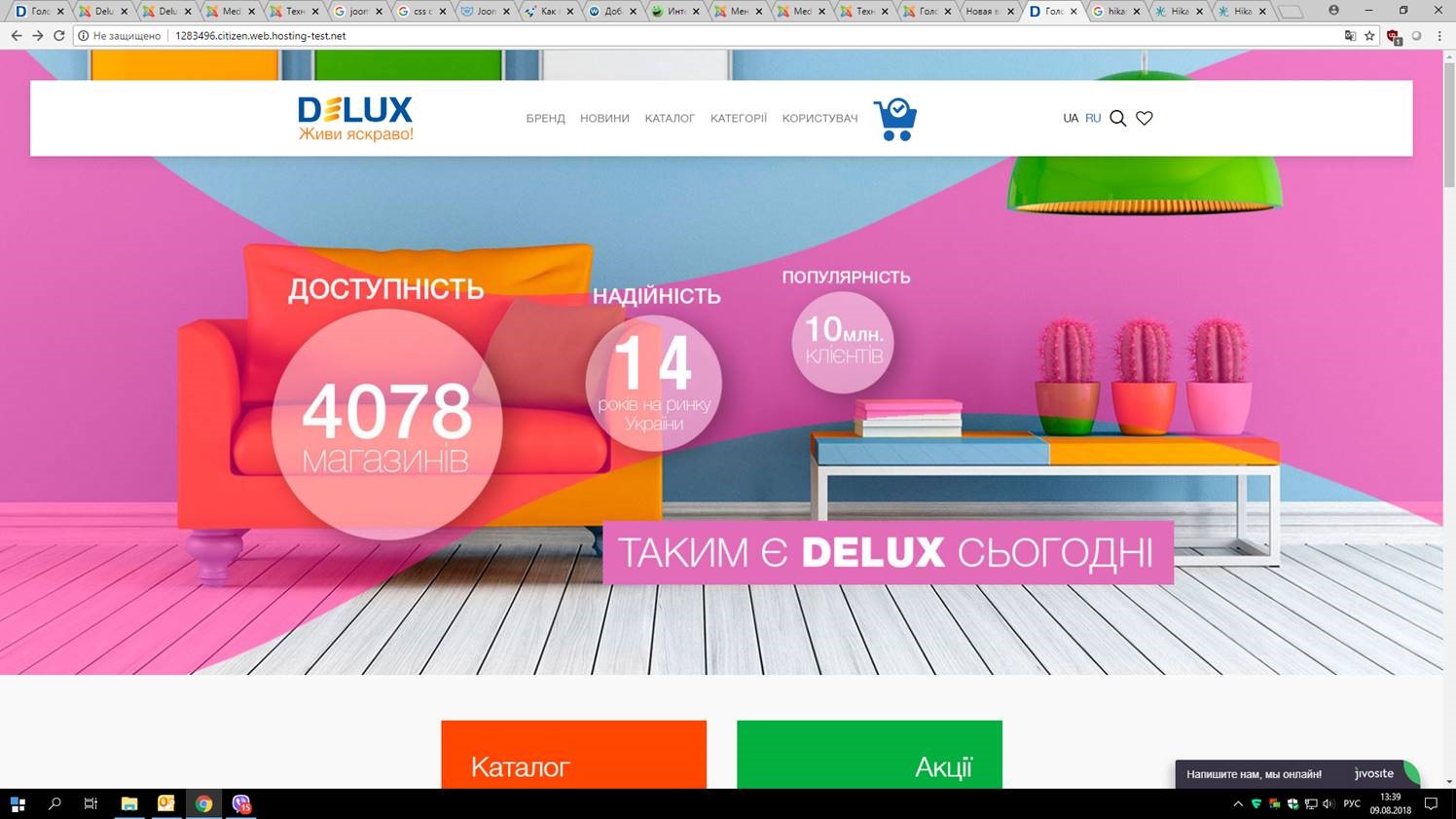

1. I read some of the older topics and documentation, but still haven't understood how to visualize Hika Shop Cart Module as an icon via CSS. Maybe it's because I'm not IT specialist, but i'd really like to do it, if possible. It should look somewhat like on the screenshot, I have the svg image availible.

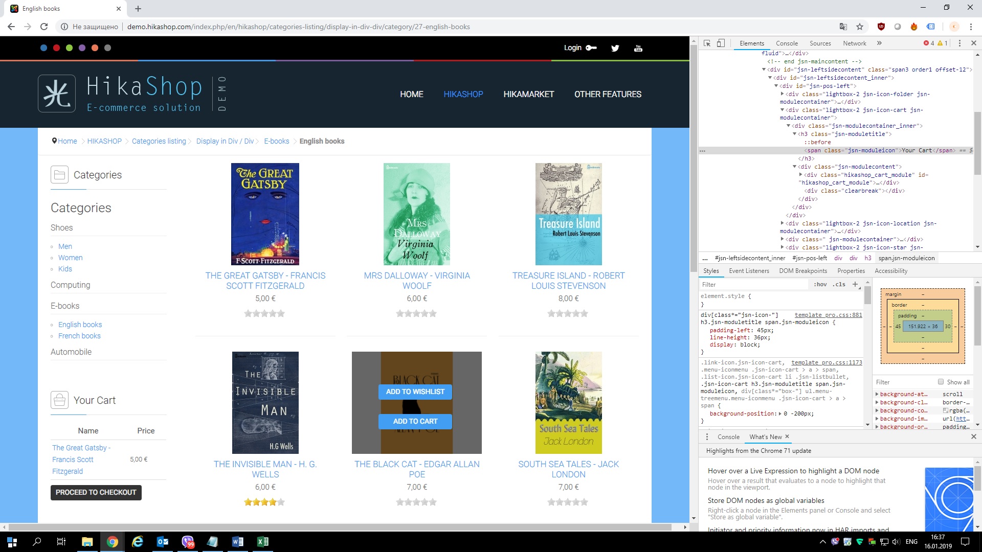

If I understand right I should copy this <span> code from your demo website and insert it in the product cart php file. But yet I don't see where is the line in the CSS, where I should be able to paste the path to the cart icon.
2. I don't know, if you can help me with this, but I'd like to add this cart module into the menu and for that I would need to add a specific position in my template near the position "lang". If you could advise me also on that, I would be very greatful.

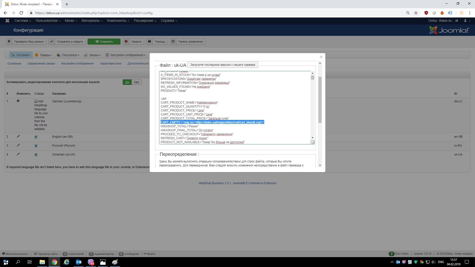

And finally, you want to do a translation override in order to change the different texts displayed by the cart module 'mini' mode to display instead an image:
So for example, for the "The cart is empty" message that you see when there is nothing in the cart.
You can add such translation override:
Code:
CART_EMPTY="<img src='http://mywebsite.com/link/to/empty/cart/image.png'/>"
That's it. There is no need for CSS or for PHP in view overrides.

Thank you for your prompt answer. So I tried to do as you advised with "CART_EMPTY" state and it worked, it did display my image.

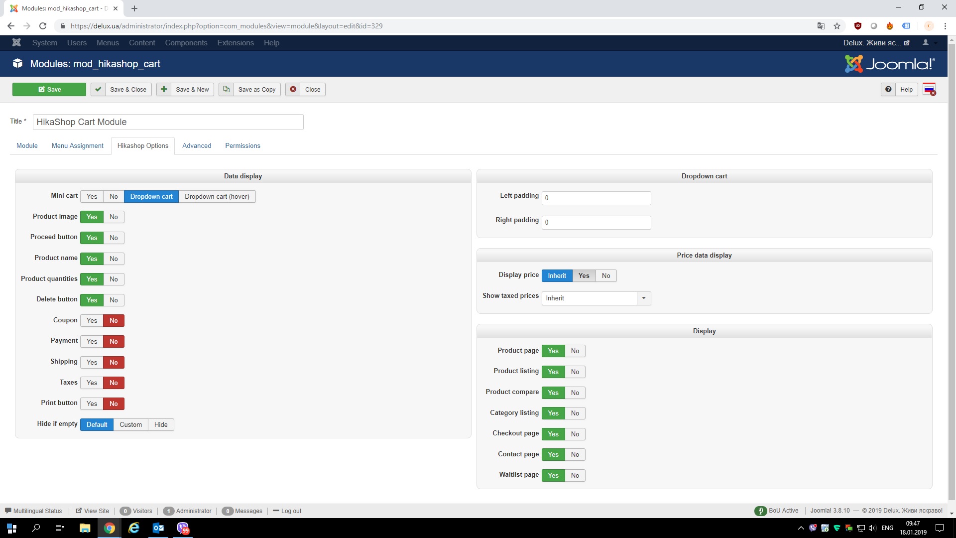

Ok I will try to do what you advise. The problem is I don't exactly know which line responds for what. As I mentioned earlier X_ITEM_FOR_X and X_ITEMS_FOR_X haven't worked out for me. Now, just in case here is a screenshot of the module settings. I like these settings a lot, they are convenient for user, the only thing that's incovinient is displaying this module as image.

No, earlier, you talked about the translation keys "X_ITEM" and "X_ITEMS", and not the translation keys X_ITEM_FOR_X and X_ITEMS_FOR_X that I was talking about in my message.
So from what I understand you didn't change the correct translation keys and that's why it didn't work.
Please double check.

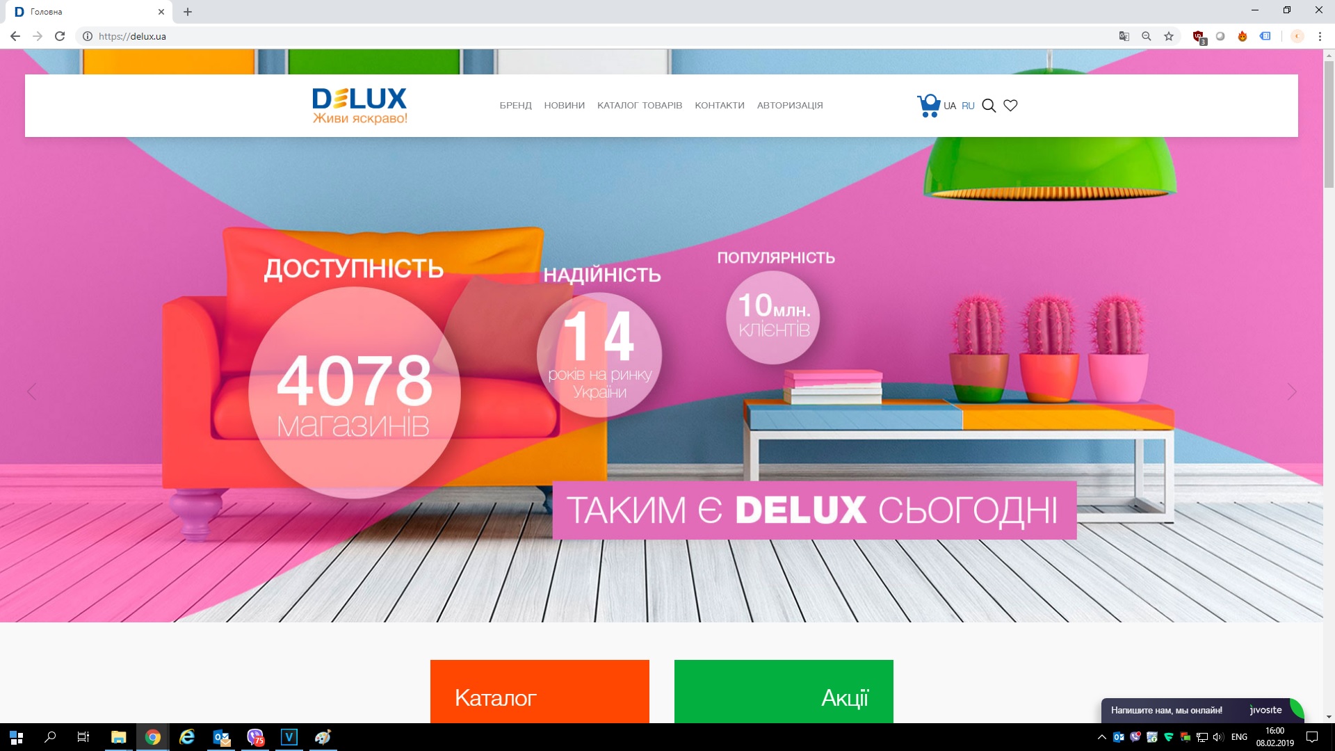

The main problem with that is the image begins to float around and I just want it to stay in it's position and the text to be displayed just like it is on my 3rd screenshot, only the image has to stay where it is and maybe not use the font I used in the image.

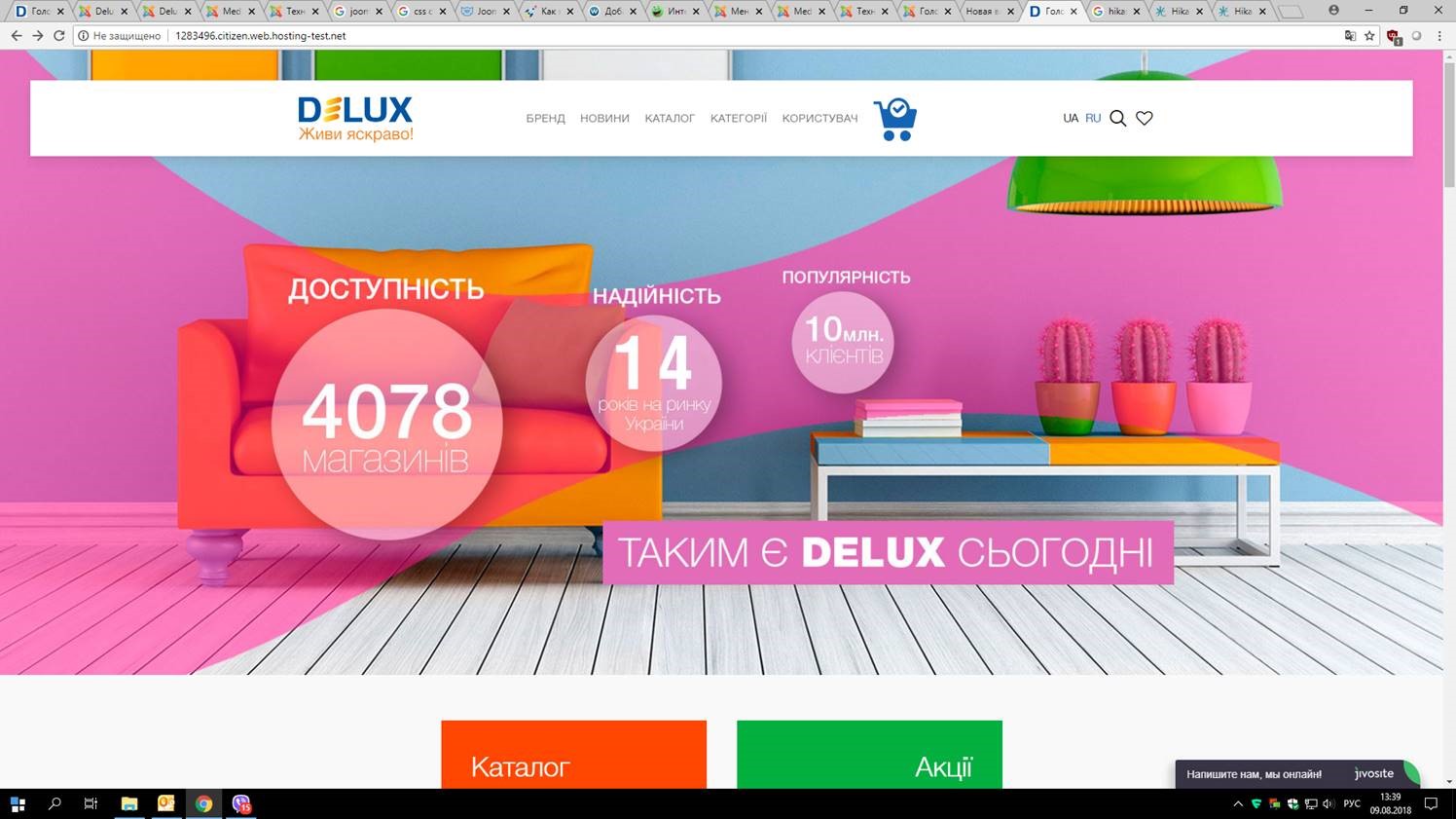

7 years 8 months ago #303610 by Vlad Boch
Hi, Nicolas.
We decided to stop on using a slightly different image for empty cart for now/ It is more fitting and much more good looking than displaying the text. Thanks again for providing all the necessary hints that helped us to come up with the best suitable decision!
