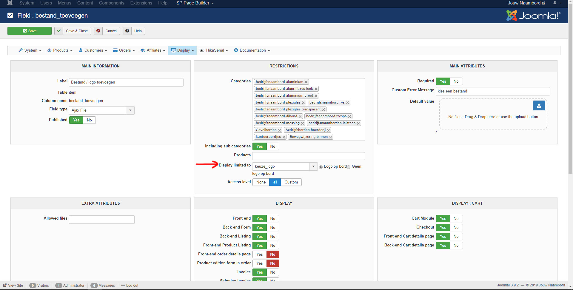

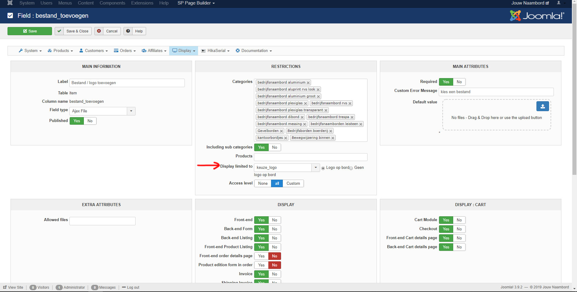

I have AJAX uploadfields on productpages that doesn't show anymore after my last hikashop update. The field is dependent on another radiobuttonfield. Just after changing the radio to "Geen logo op bord" and then back to "Logo op bord" it's showing again. I changed the productpage to a default template first to eliminate the error being triggered by the custom template.

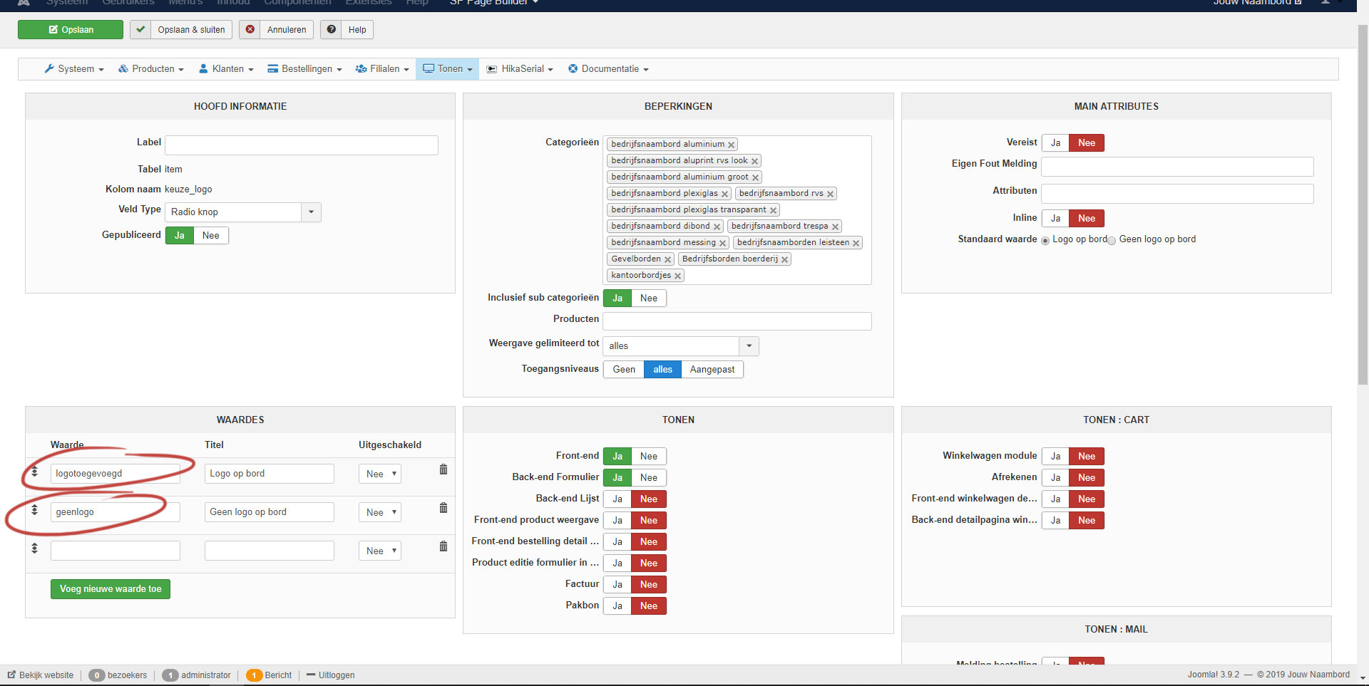

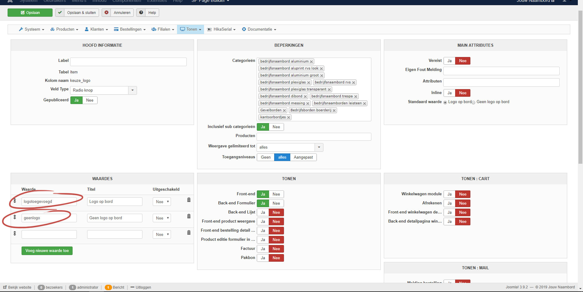

As far as I can see, the issue is with the values of your "keuze_logo" custom field. They have spaces in them and because of that, the ids of the input elements end up being: "keuze_logo_logo toegevoegd" and "keuze_logo_geen logo". But ids aren't supposed to have spaces in HTML so I suppose that the javascript is not able to find the inputs when initializing the elements on the page.
I would recommend to try again with values without spaces and it should help.
Please let us know how it goes.

Well, tried that, but with the same result...

We found the issue which was actually linked to the type of the custom field and some changes we had to do for the separation of the address custom fields for shipping and billing addresses back in 2018.
I've added a patch for that. Download again the install package on our website, install it on yours and clear the cache of your browser and your website (if any) and that should work.
