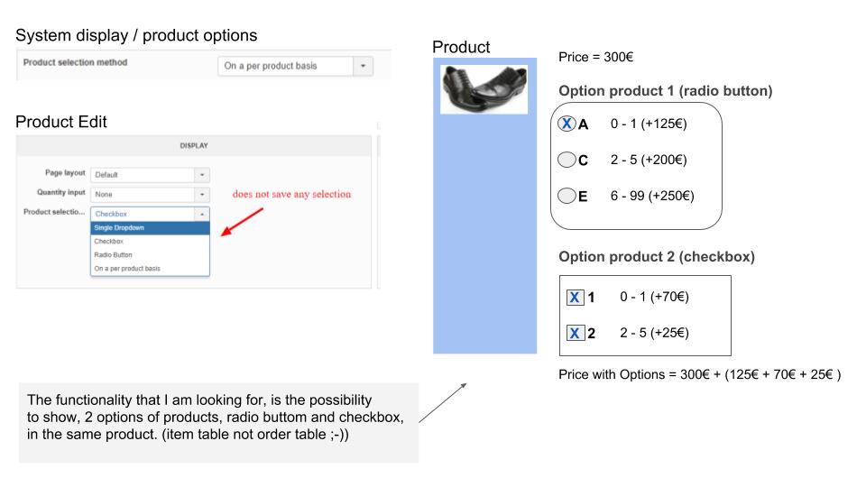

I am trying to learn the operation, hoping that this utility allows me to design products with product options working at the same time with checkbox, single and radio buttons. (options product selection method multiple)
But I think the drop-down (see image) does not work correctly. I have tested it in 2 sites, one in production and another in demo environment and the selected option is not saved. (product selection method)
When I select any value, it is not saved.
Best regards
Javier

Thank you for your feedback. There is indeed a problem with the saving of that option due to changes that were made at some point.
You'll have to run that MySQL query in your database via your phpmyadmin:
ALTER TABLE `#__hikashop_product` CHANGE `product_option_method` `product_option_method` VARCHAR(255) NOT NULL DEFAULT '';
where #__ is to be replaced by the prefix of your joomla tables.
Then, it will work fine.
We'll add a patch for the next release to run that MySQL query upon update.
