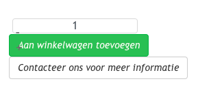

when i select left and right i am getting this.
adding your line to custom css only results in allign the amount number to the left.

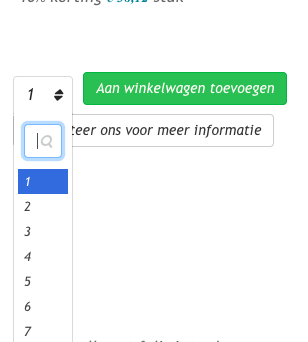

the only working option is Show selected..
then i get this.. (for now its good)
7 years 6 months ago #305207
by nicolas
Replied by nicolas on topic how to change the quantity field
You need to use the left/right quantity input method AND the CSS I gave. If you only add the CSS I gave without selecting the left/right display as philip proposed before, it indeed won't work properly.
I did the test on my end and it works just fine. Now, if you still have some display glitch after that, then it means that the CSS of your template is interacting with the quantity input and the buttons. But we can't say exactly what you could do to counteract the CSS of the template without directly analyzing the CSS on the page.
