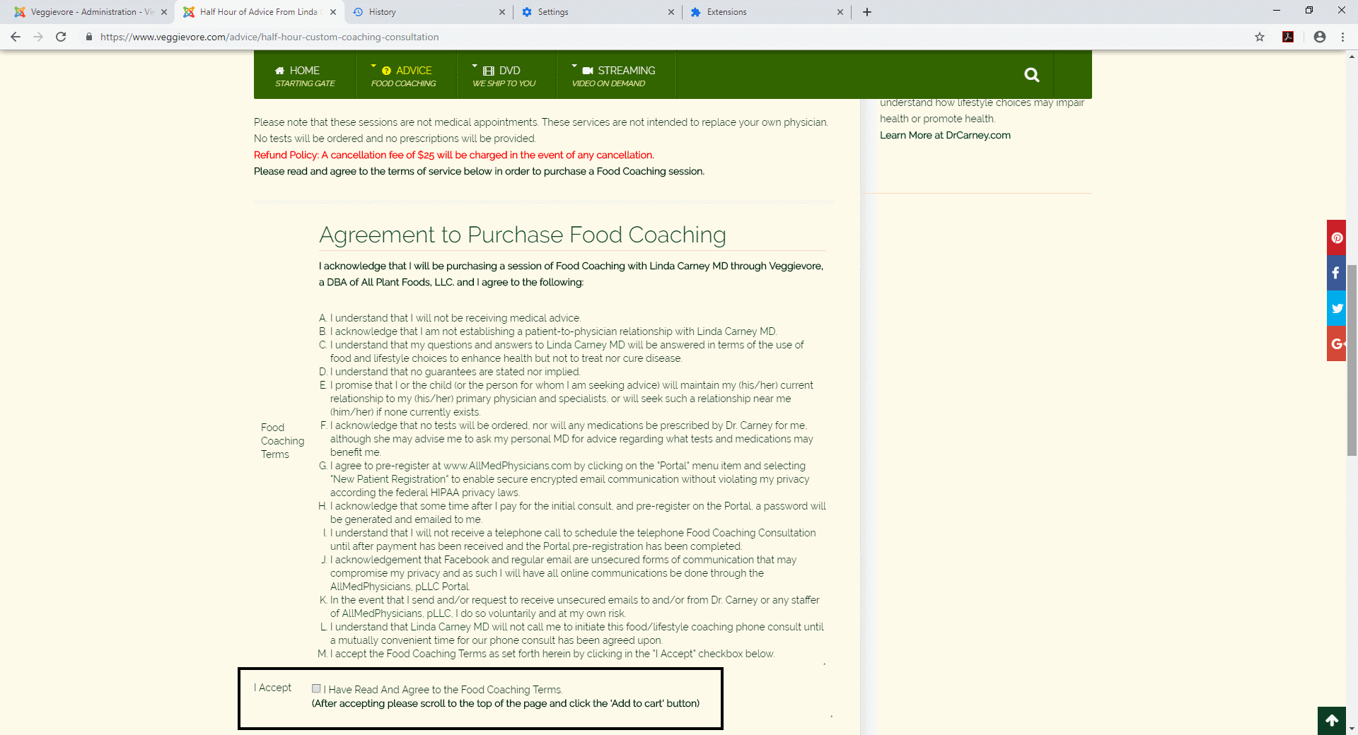

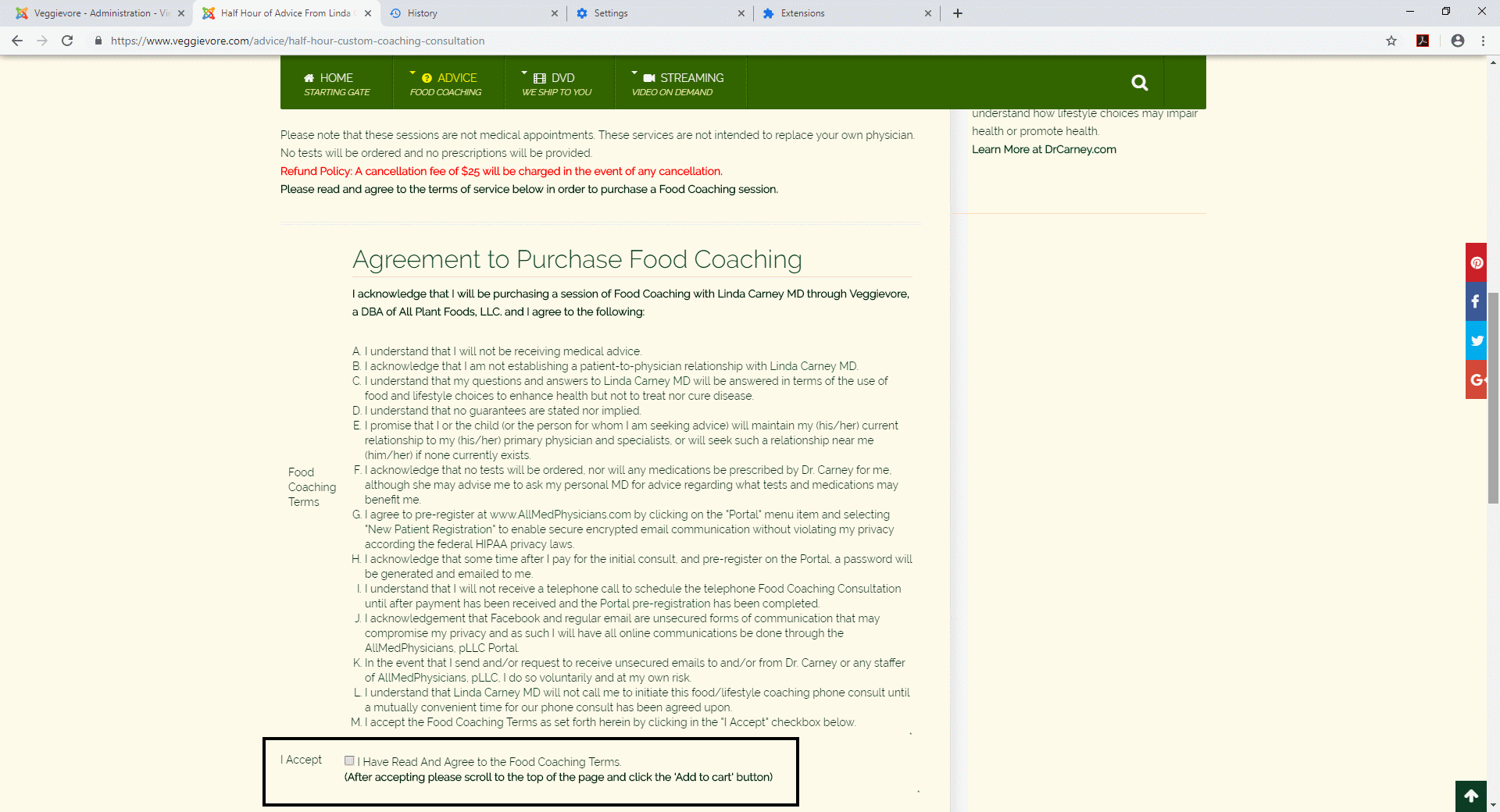

I have created an item that displays on two product pages which is named "I Accept" whiich is a checkbox that needs to be checked in order to purchase the products. Currently I have that checkbox at the bottom of terms for an agreement to make the purchase. But, it is awkward because right now I have people getting confused.
When they click on the Add to Cart button a popup displays a message asking them to read the terms and then click the I Accept checkbox. But, they then have to scroll back to the top of the page to click on the Add to Cart button.

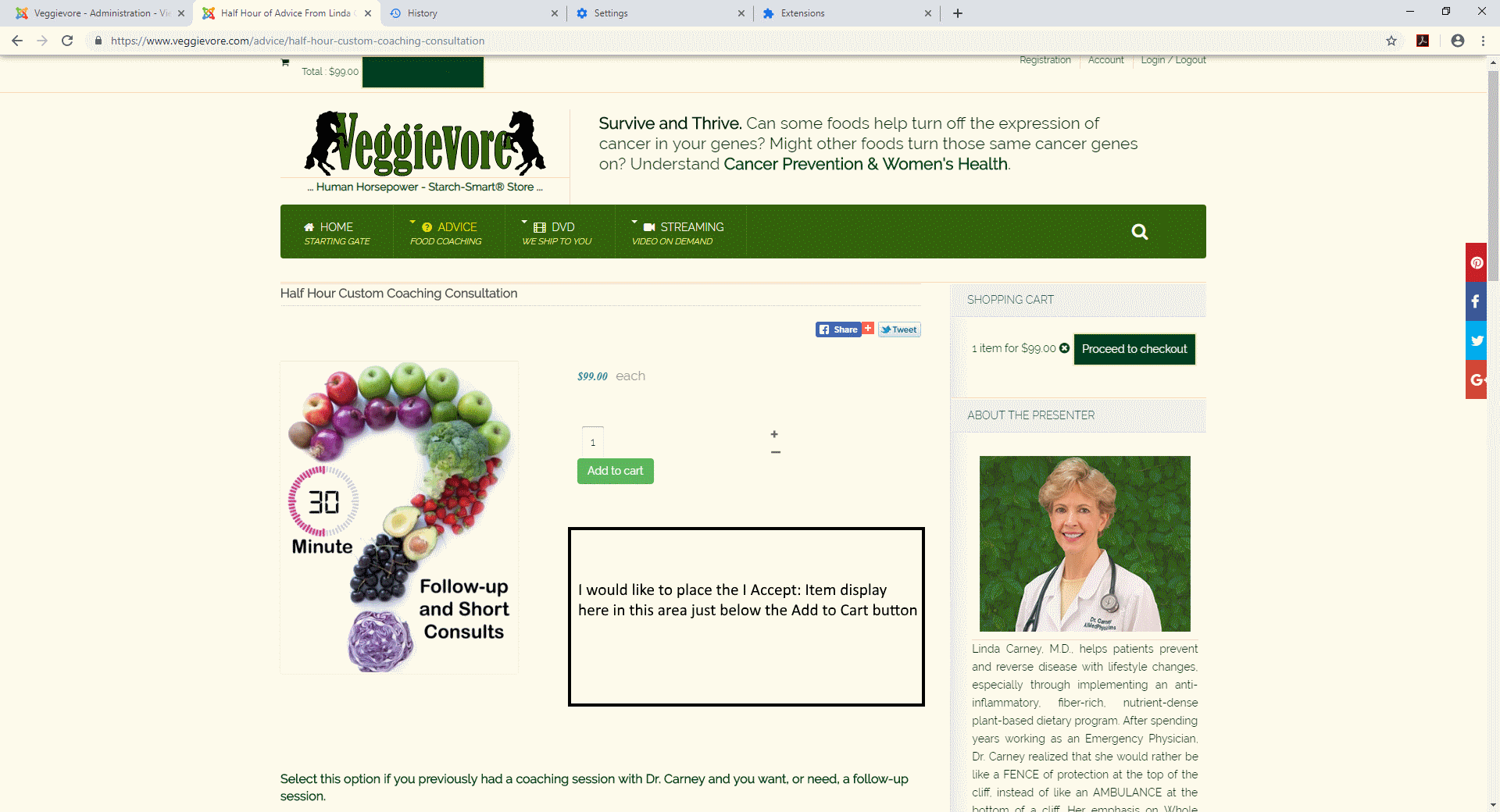

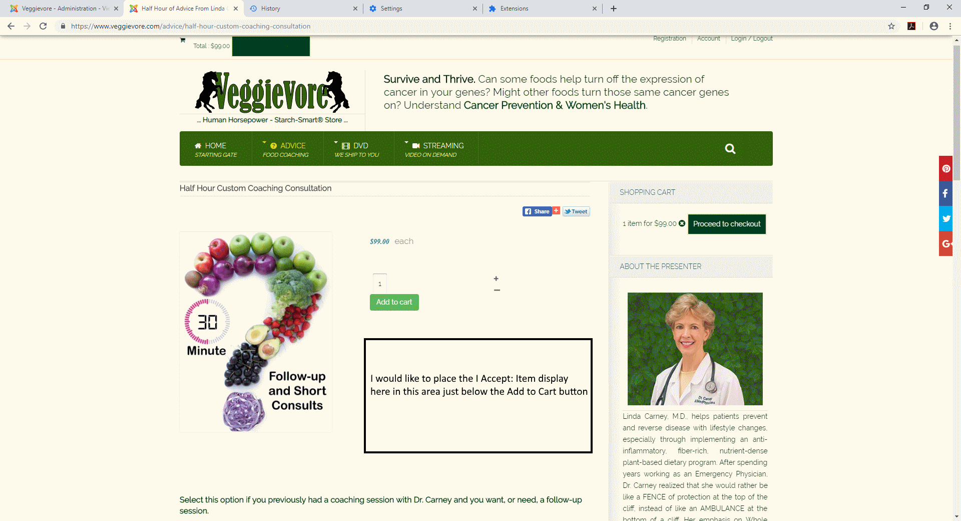

I would like to do one of two things both of which seem like reasonable solutions to me.
Option 1: Move the I Accept checkbox and text to just below the Add to Cart button.
Option 2: Add an additional Add to Cart button just below the current "I Accept" item.
