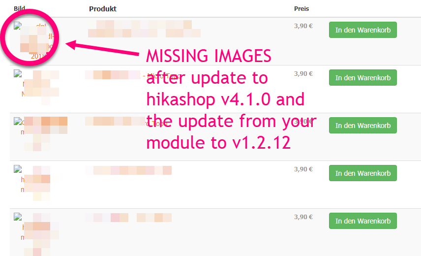

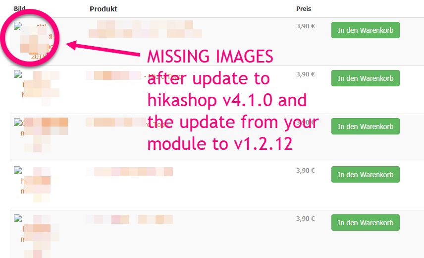

-- HikaShop version -- : 4.1.0
please have a look to my shop:
the system want to load the thumbnails in the webp format from existing images, put there is none:
on all list views and module views the path to the images are wrong.
i guess it has something to do with the webp image function what you have implemented in the v4.1 version.
how can i fix this? Is it possible to deactivate the webp standard?
Last edit: 7 years 2 months ago by n00bster.
  • Posts: 86052
  • Thank you received: 14180
7 years 2 months ago #307067
Please check the folderimages/com_hikashop/upload/thumbnails/250x250/ of your website via the Joomla media manager in the backend.
If you see the webp image there, then the image was generated and the issue is that you have something in your htaccess or your web server config blocking access to files with the webp extension. So you need to change that.
If you don't see the webp image there, then normally the webp image HTML shouldn't appear on your frontend and you should see the normal images. So this case shouldn't happen.
  • Posts: 103
  • Thank you received: 5
7 years 2 months ago #307102
hi Nicolas.
in the thumbnail folder are no webp images stored.
how is this system working?
does hikashop generate also for existing images webp versions or only for fresh uploaded when i update my shop to 4.1.0?

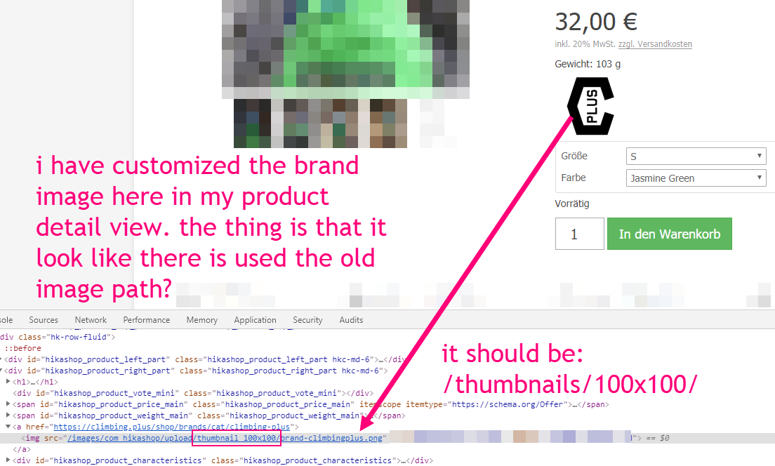

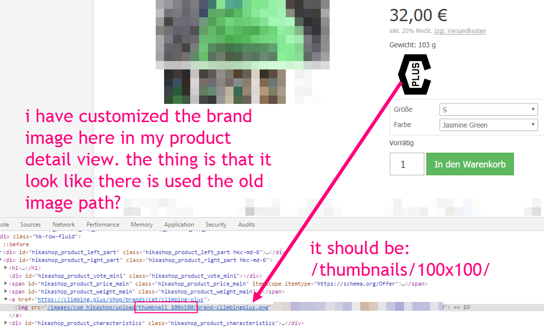

7 years 2 months ago #307424
nicolas wrote: The first folder is the old folders for thumbnails. It shouldn't be used anymore.
That's why you don't see the webp images there.
hi, i noticed that the old folders, after i deleted them, are generated again with a brand thumbnail in it soon as i reload a product detail page with an brand (see the image).
what could be the problem that the old folder is generated?
  • Posts: 86052
7 years 2 months ago #307441
The issue comes from your customized code.
The function $this->image->display($manufacturer->file_path,false,$manufacturer->file_name, '', '', 100, 100) is the old function we had before to display thumbnails.
The new function (new since HikaShop 2.5 or something like that) is getThumbnail. With it, it's up to you to add the img tag.
So you want something like this now:
		$image_options = array('default' => true,'forcesize'=>$this->config->get('image_force_size',true),'scale'=>$this->config->get('image_scale_mode','inside'));
		$img = $this->image->getThumbnail($manufacturer->file_path, array('width' => 100, 'height' => 100), $image_options);
		if($img->success) {
			echo '<img src="'.$img->url.'"/>';
  • Posts: 103
7 years 2 months ago #307674
ok thank you for clarification.
i found this code to display the brand image what does also link to the brand page in the forum here.
when i use your code i lose my link (href) around the image. do you have any code sample from the new code after 2.5 hikashop version?
  • Posts: 86052
7 years 2 months ago #307692
Well, it's the same as the old code, but you just replace the display function call with the img tag of my code above...
So it's like that:
		if($img->success) {
			echo '<a href="'.hikashop_contentLink('category&task=listing&cid='.$manufacturer->category_id.'&name='.$manufacturer->alias.'&Itemid='.$Itemid,$manufacturer).'"><img src="'.$img->url.'"/></a>';

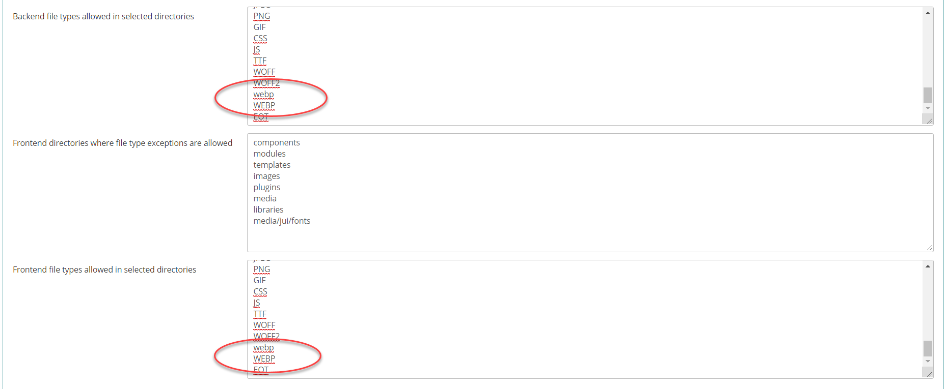

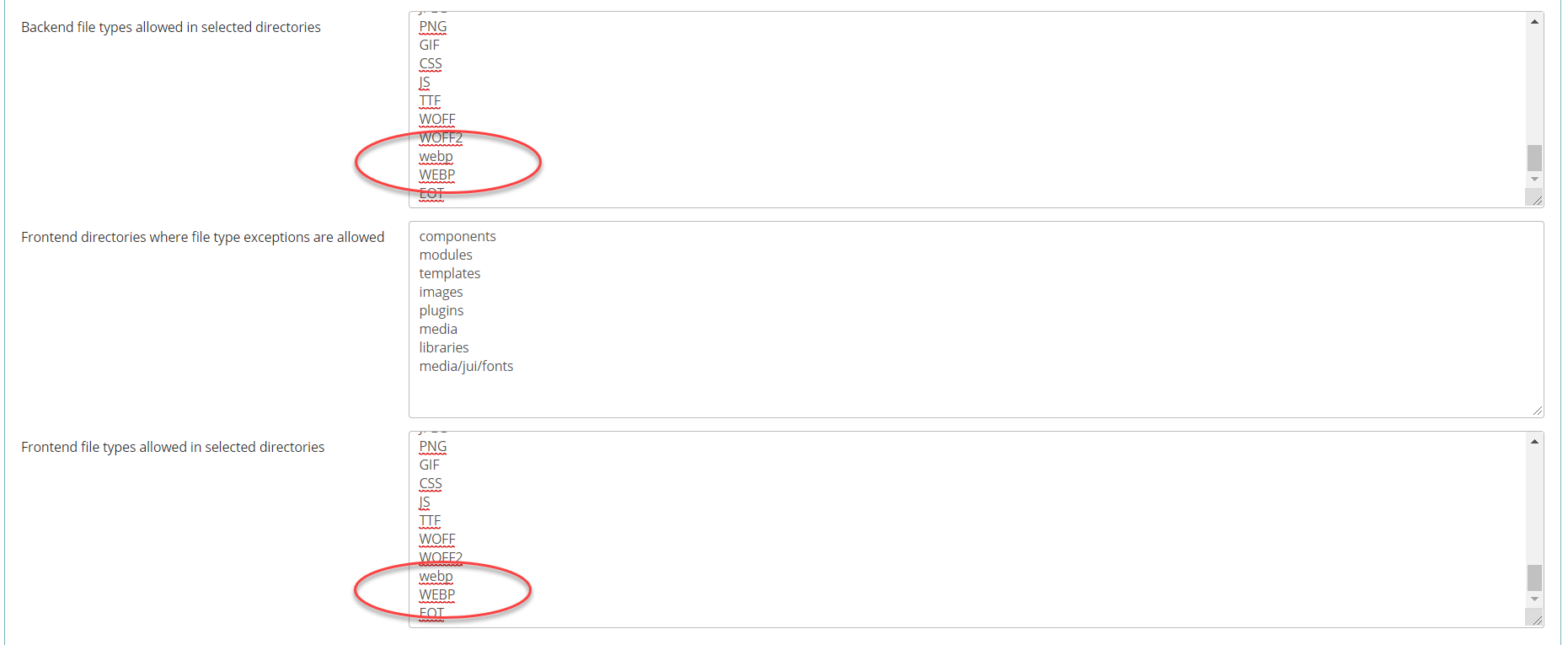

  • Posts: 637
  • Thank you received: 26
7 years 2 months ago #307710
For people with Admin Tool .htaccess maker:
Just Add in Upper and Lower case, webp and WEBP to your allowed file formats area.
Kind regards,
Lumiga
The following user(s) said Thank You: n00bster
  • Posts: 103
7 years 2 months ago #307734
Thank you a lot Nicolas.
the old image folder generation has stopped after i changed the depending code for showing the manufacturer image.
@Sailfin73 you right, thank you for your input :)
