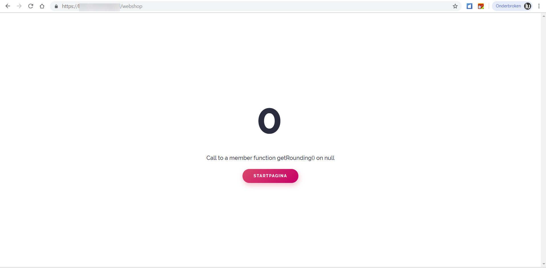

-- Error-message(debug-mod must be tuned on) -- : Call to a member function getRounding() on null
Hi Support,
When we activate the plugin (cart module design) we get this error:

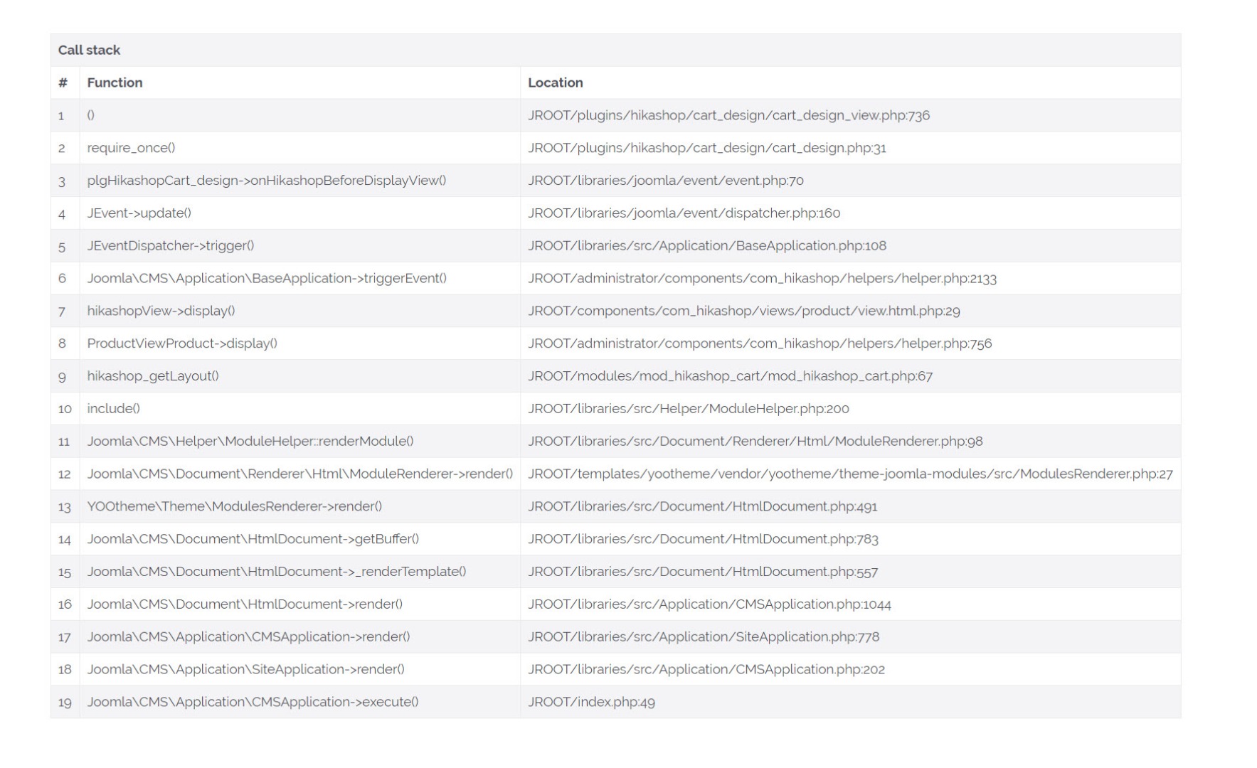

When we set debug system on YES en turn on the error reporting on Maximum we get this inomation:
We use a Yootheme Pro template:
yootheme.com/
Hope you can fix this error.

7 years 2 months ago #307195
Thanks for your return and sorry for this, there were some little mistake that can only appear when you display Tax in module cart.
It seems that you are the first !
To get the correction you can update the plugin and install it again to get the correction.
Sorry again for inconvenience !

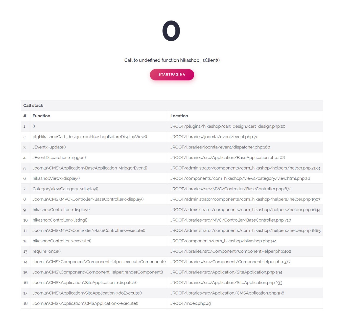

7 years 2 months ago #307211
Hi Philip,
No problem, but when I download it again and install it again the issue is still not solved.
The error now is: Call to undefined function hikashop_isClient()
Hope you can fix it.

7 years 2 months ago #307239
Ok other issue that need to be correct then... It come from you use an earlier version of HikaShop 4.1.0.
You don't have an hikashop function set in your HikaShop Helper.
I will help you to solve the issue on your side, step by step :
1. Go to YourWebSite\plugins\hikashop\cart_design
2. Open cart_design.php file
3. Add this :
if (!function_exist('hikashop_isClient')) {
	if(!HIKASHOP_J40){
		function hikashop_isClient($type) {
			static $test = array();
			if(!isset($test[$type])) {
				if($type == 'administrator')
					$test[$type] = $app->isAdmin();
				else
					$test[$type] = $app->isSite();
			return $test[$type];
	} else {
				$test[$type] = $app->isClient($type);
To have this, take care it's important that you add this code at this specific location, view my screenshot :
Note that this will be of course added to our code on our side.
Sorry again for inconvenience...
