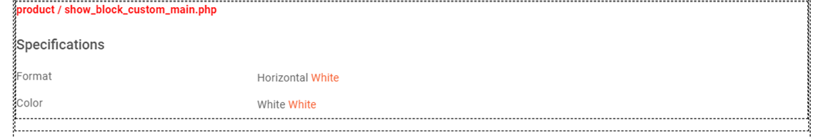

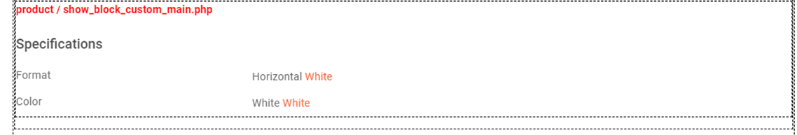

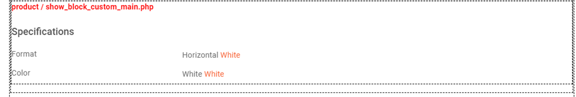

Hi Nicolas, thank you for the explanation – your proposal is ok, however if I have more than one custom field on Product Page Specification this link appear next to all values of all custom fields – what should I change to have different link for different custom fields ?
I have attached image how it looks at this moment (red "White" is a link generated by the code).

7 years 2 months ago #307389
It's not my code doing that. It's the location where you added it which does that.
You should turn off the display of that custom field (in the settings of the custom field) and move my code at the end of the show_block_custom_item.php view file. You can prepend it with the label of the field.
