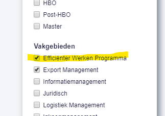

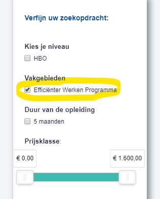

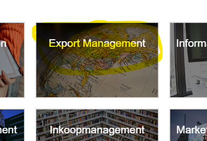

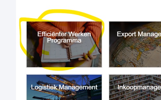

I know it is bad practice, but some users do use the back-button in the browser.
In Google Chrome there is a strange behaviour when using the back-button and filters. Google Chrome remembers the first filter when you use the back-button in the product list and then use another filter. In Firefox the behaviour is as expected: the first filter is deleted.
See the screen-shots.
Peter
-- Joomla version -- : 3.9.6
-- PHP version -- : 7.1.25
-- Browser(s) name and version -- : Chrome 75.0.3770.80
-- Error-message(debug-mod must be tuned on) -- : No error, but strange back-button behaviour
Peter
