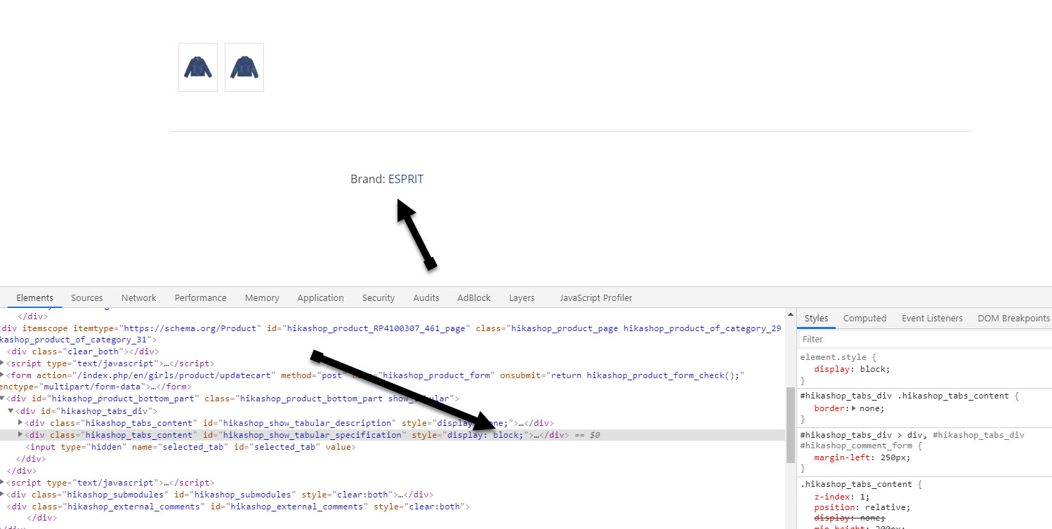

7 years 3 months ago #309428 by nicolas
Replied by nicolas on topic Not showing Brands
Well, from what I can understand it should come from the file templates/YOUR_TEMPLATE/html/com_hikashop/product/show_tabular.php which modifies the tabs system incorrectly.
What you can do is to add such CSS on your website to prevent that:
#hikashop_show_tabular_specification{ display:block !important; }
7 years 3 months ago #309435 by Crashbandi
Replied by Crashbandi on topic Not showing Brands
Thanks Nicolas, the css worked.

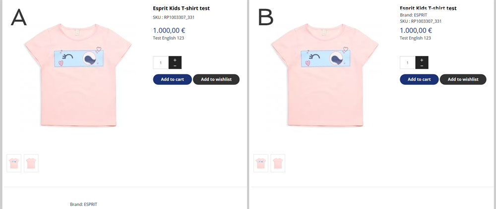

It displays the brand near the bottom of the page. Could you let me know how to display near the top, just above the SKU?

7 years 2 months ago #309472 by Crashbandi
For info an example is HERE
I have attached a screenshot.
'A' is the current view with the Brand at the bottom of the page.
'B' is how I would like it to look with the brand just above the SKU.
Thanks.
Colin.
7 years 2 months ago #309476 by Mohamed Thelji
Replied by Mohamed Thelji on topic Not showing Brands
In that case the solution will be to directly edit the "show_default" file of the "product" view of your front-end template via "Hikashop->Display->Views", and move that code where you want it to be displayed :
Code:
<span id="hikashop_product_url_main" class="hikashop_product_url_main"><?php if(!empty($this->element->product_url)) { // DISPLAY the manufacturer echo JText::sprintf('MANUFACTURER_URL', '<a href="' . $this->element->product_url . '" target="_blank">' . $this->element->product_url . '</a>'); } ?> </span>

7 years 2 months ago #309585 by Mohamed Thelji
My bad I mistook the brand url and the manufacturer url.
The modification was added through the "Show_tabular" file of the "Product" view of our front-end template.
Kind regards,
Mohamed Thelji.

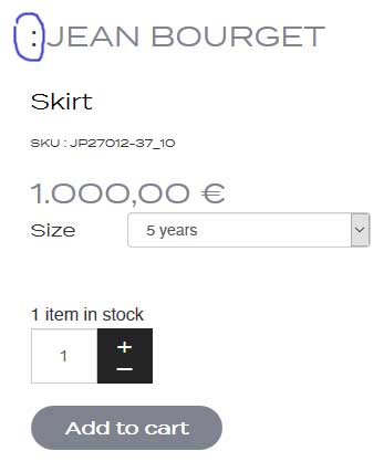

Just a quick one. Where can I delete the colon just before the brand name. As shown in the attachment.
Colin.
7 years 2 months ago #310014 by nicolas
Normally, it's from the line:
Code:
echo JText::_('MANUFACTURER').': '.'<a href="'.hikashop_contentLink('category&task=listing&cid='.$manufacturer->category_id.'&name='.$manufacturer->alias.'&Itemid='.$Itemid,$manufacturer).'">'.$manufacturer->category_name.'</a>';
in show_block_dimensions.php
However, as your product page layout is customized, it might be in another file of the product view.
