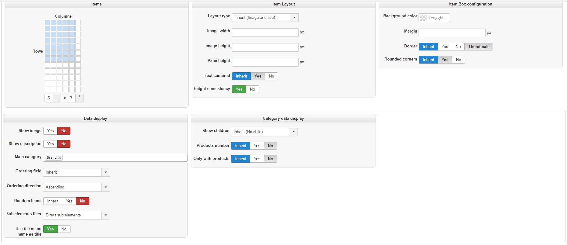

I have created a menu item in which I want to display all my brands, though the "Brand".
I cant move to the second page, when I try to navigate.
The Menu Item Type is "categories listing".
Thank you in advance.

I tried to setup a similar menu item on my end and the pagination worked just fine.
So I would recommend you to do two things:
- download again the install package of HikaShop Business on our website and install it again on yours. That will add all the latest patchs including several we made since the first build of the 4.2.1 to fix some issues with the pagination system that might be related to your issue.
- look for the file templates/YOUR_TEMPLATE/html/pagination.php via FTP. If you find it, then try renaming it in order to deactivate the pagination customization of your template and see if that helps.

The update solved the problem.
Thank you very much nicolas.
