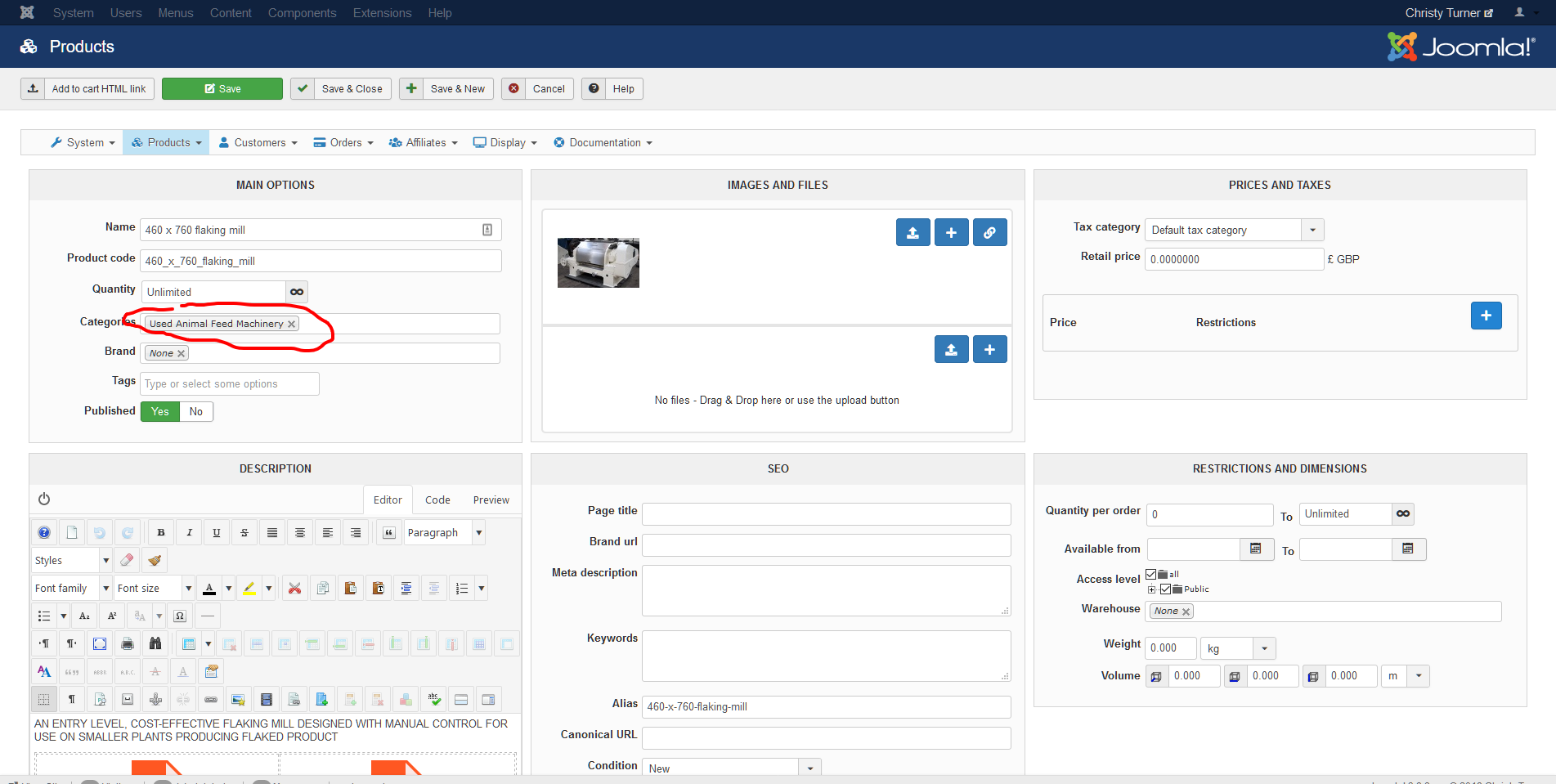

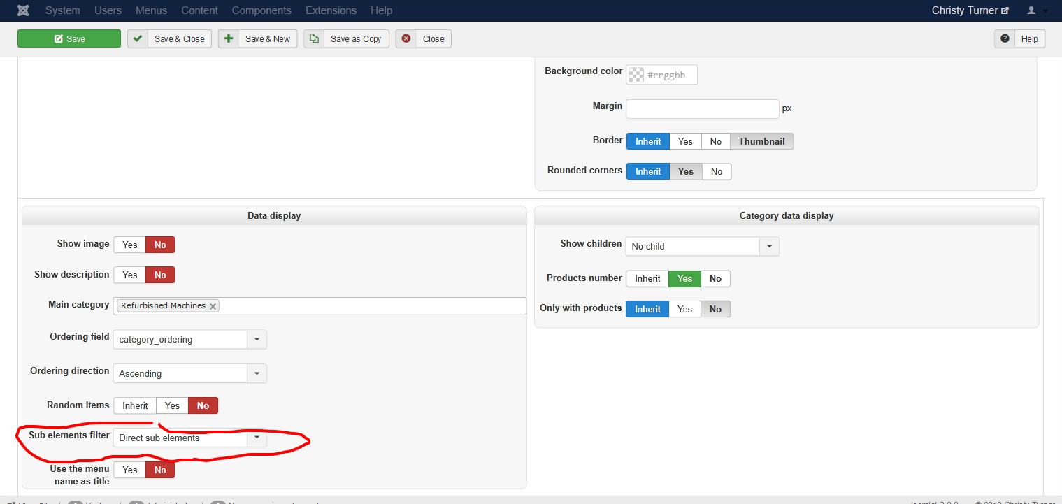

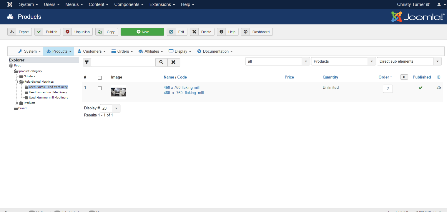

here: www.christy-turner.com/new_site/index.ph...=listing&Itemid=1744 is seems even though the product is in the sub category its still displaying in the main category.
Please see images for categories/settings. Any help would be appreciated.

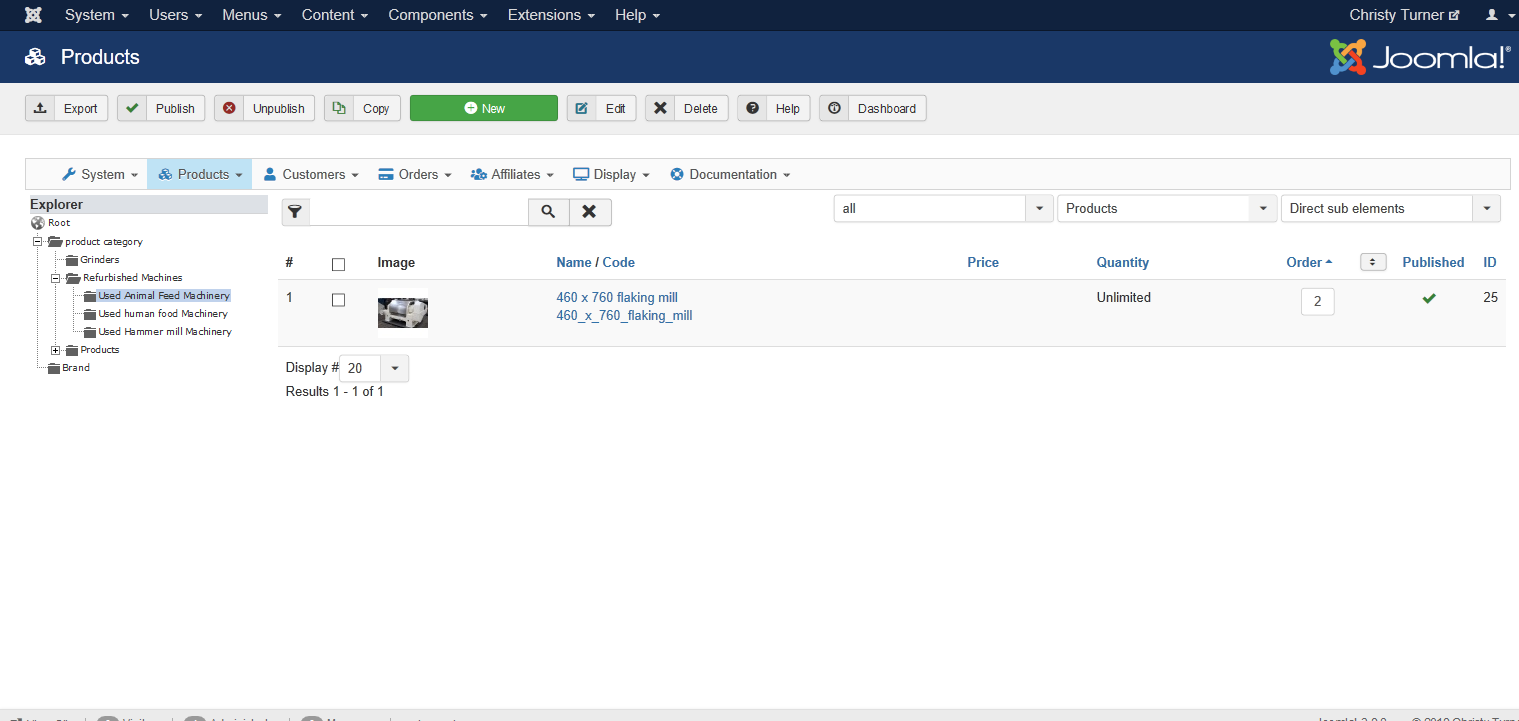

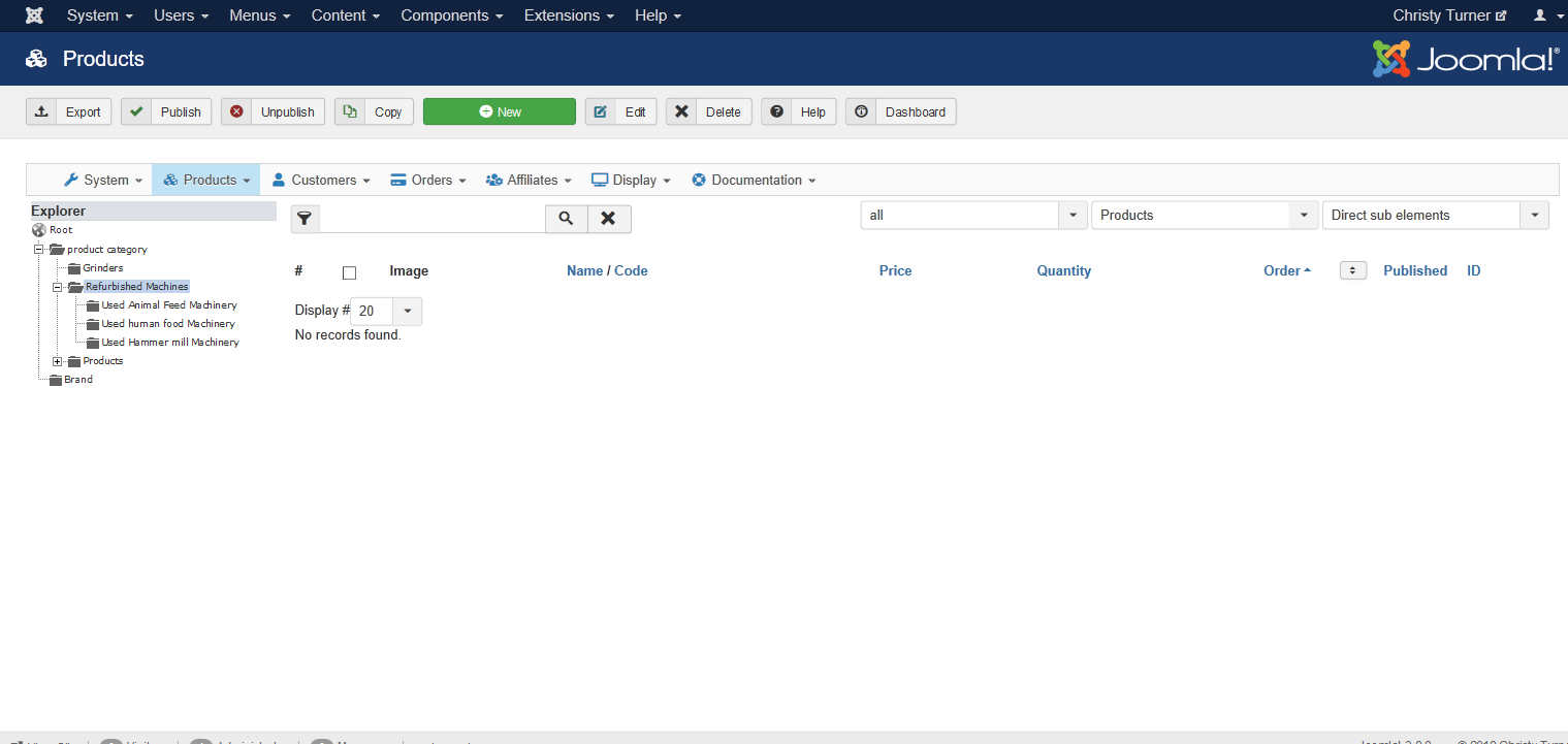

I'm sorry but for us, everything seems to match your configuration, see my screenshot to better understand my point :
Your Item Menu display the category called "Refurbished Machines" and only the direct sub-elements as configured.
Can you precise what seems wrong to you with more details because I suspect a misunderstanding.

The product is a direct sub element of Used Animal Feed Machinery and NOT Refurbished machines. It should ONLY appear in the Used Animal Feed Machinery category and not in the Refurbished Machines category. thanks.

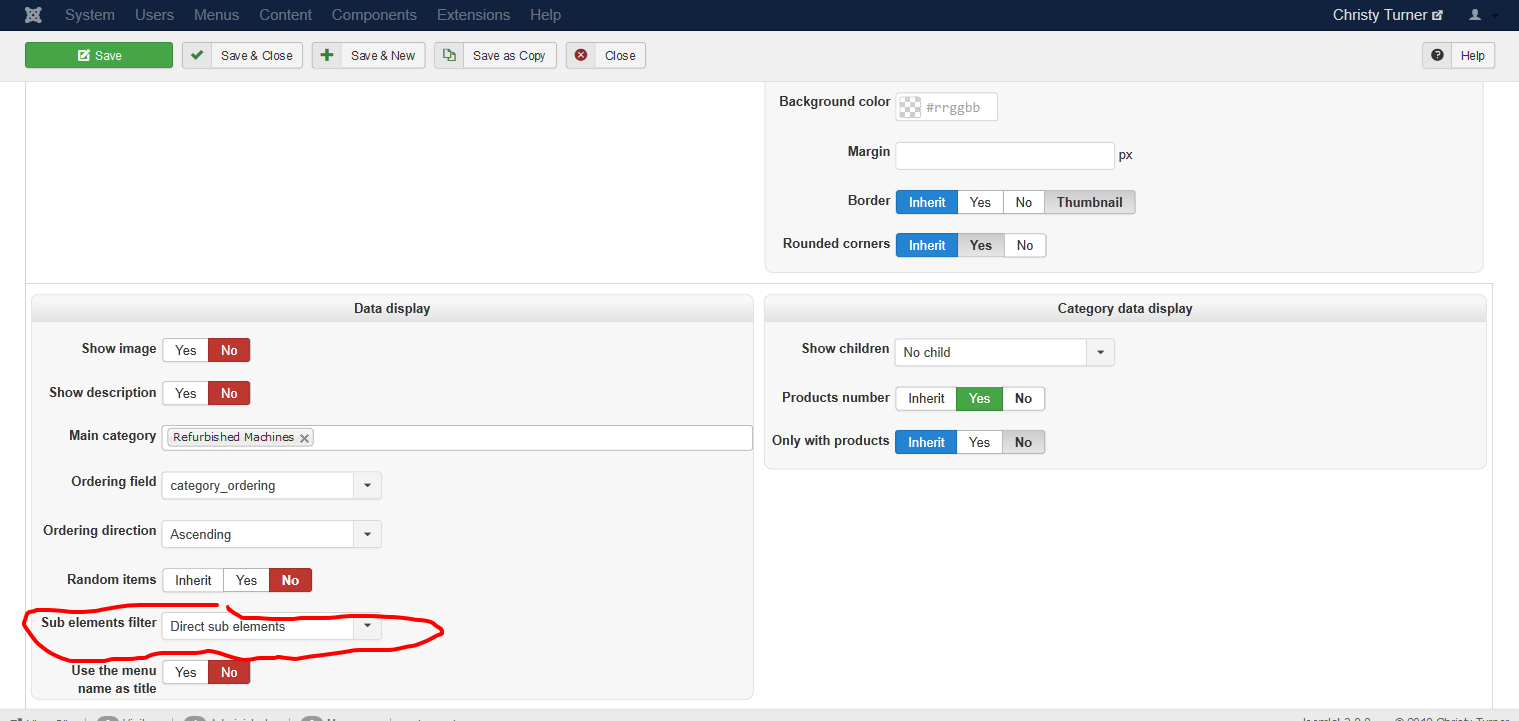

Looking at the screenshot www.hikashop.com/media/kunena/attachment...erAdministration.png you're looking at the "sub elements filter" setting under the "categories listing", not at the "sub elements filter" setting under the "products listing" tab.
Check that this setting is also set to "direct sub elements".

Sorry you are correct Nicolas - what a numpty I am! thanks.
