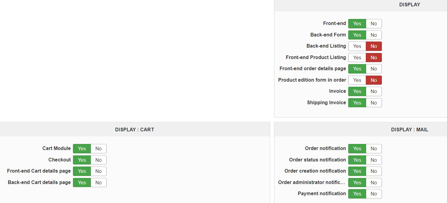

I have setup the ordered_length Item custom field to display in Order and Mail. But it is not displayed on either of them.
Please see the attached screenshot.

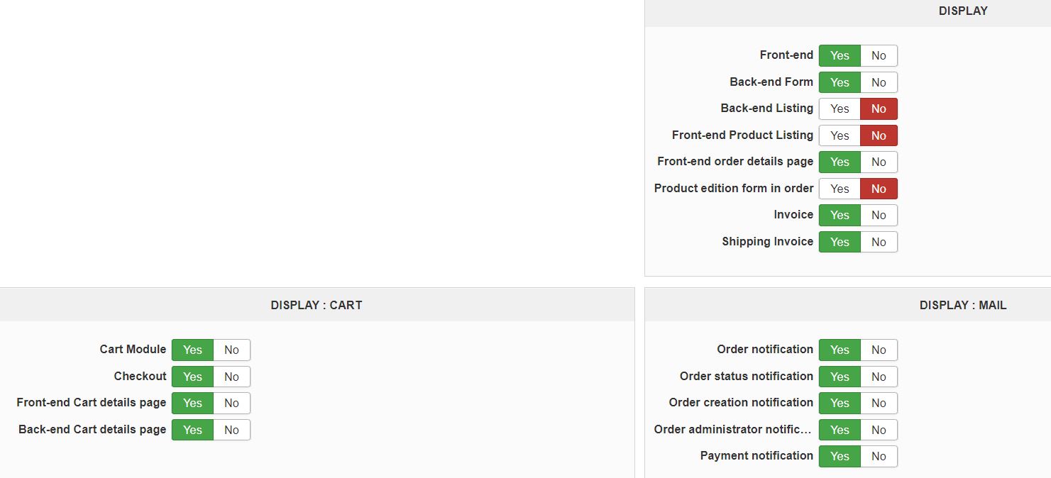

  • Posts: 66
6 years 11 months ago #311706
I found the solution by trial and error: I had to activate every option in the "Display" box of the Item Custom field options. See previously attached screenshot.
Please take a look at the screenshots we upload.
