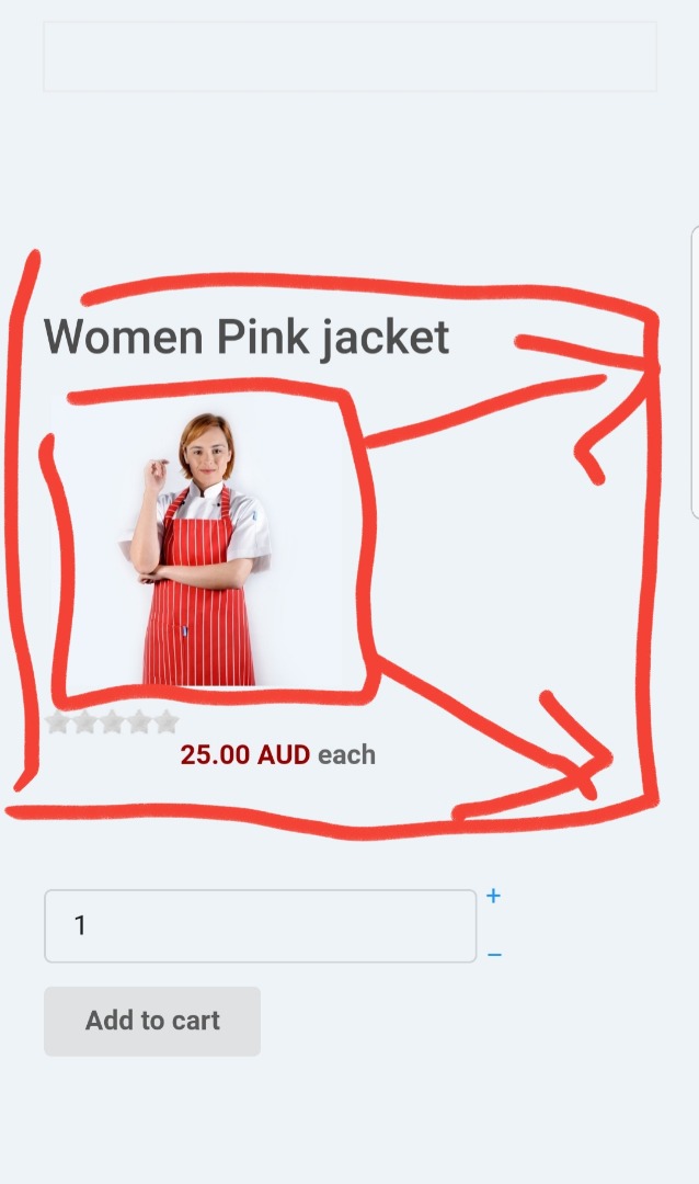

  • Posts: 39
6 years 10 months ago #312733
Hi Nicolas.
Sorry I would had been more clearer.
I meant product thumbnail image in single product page in mobile device, not pop up image.
In mobile device, the product thumbnail does not fit to the width of page where it should be given that the normal thumbnail size is 400 x400 in settings config.
I look forward to your reply.
  • Posts: 86096
  • Thank you received: 14200
6 years 10 months ago #312735
Your screenshot looks like from a product in a products listing page, not from the product details page.
For the listings, you need to edit the menu item / module via the Joomla menu items manager / Joomla modules manager and change the thumbnails size settings under the products options tab / HikaShop options tab.
For the product details page, you can find the "Product page image (width x height)" setting in the Images section of the HikaShop configuration.
