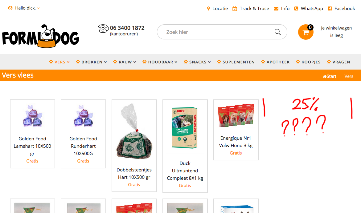

-- url of the page with the problem -- : formidogrijswijk.nl/vers
-- Joomla version -- : 3.9.12
-- PHP version -- : 7.2
Good afternoon
Hikashop has a default (left) position for the filters when they are added by the component.
I use a JoomDev template: JD_Shop
When I opt to use the hikashop filter module (to place the filters in another position) there is still a 25% margin on the right side of the main (component) area.
I have been puzzling where to "fix" this.
I feel it has to do with hikashop... as other components don't produce this padding.
Does anyone have a clue where the setting is?
Thankful for help
Dick

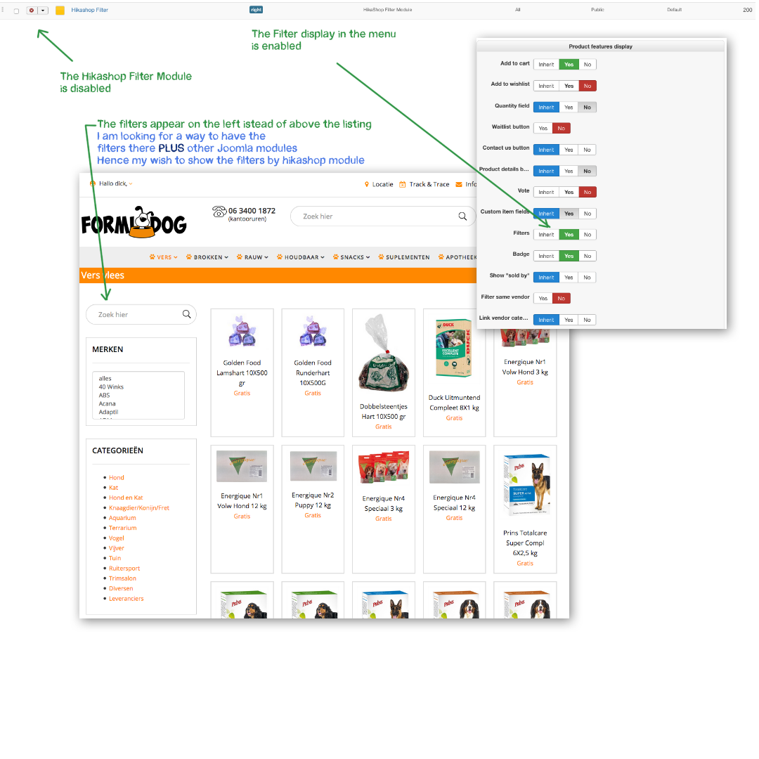

5 years 7 months ago #312772
Thank you for your answer Nicolas
I feel I don't totally "grasp" your answer.
I have tried your option... without the desired effect
Please look at my settings in the attached image.
The result is that the filters show on the LEFT, not ABOVE
You can see it here
Another way
If I publish the Hikashop filter module, but assign it to none of the pages and enable the filter option in the menu... the effect is the same: the filters show in the left poition.
What I desire is: to display the filters in the LEFT position, but by use of the module option so that I can show other modules in the left position as well.
I hope there is apossibillity for this
Dick
Last edit: 5 years 7 months ago by Formidog.
5 years 7 months ago #312777
I think that there is a misunderstood, follow me step by step to better understand the situation :
=> Use a default template like ProtoStar
You will see that the fact that your filter isn't above is only coming from your template, as with the ProtoStar your filter may be above your listing.
In order to have what you requested, we invite you to contact the template creator.
