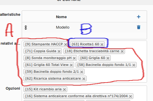

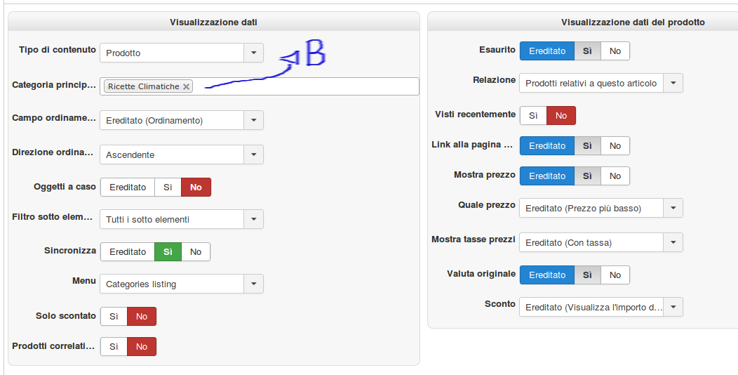

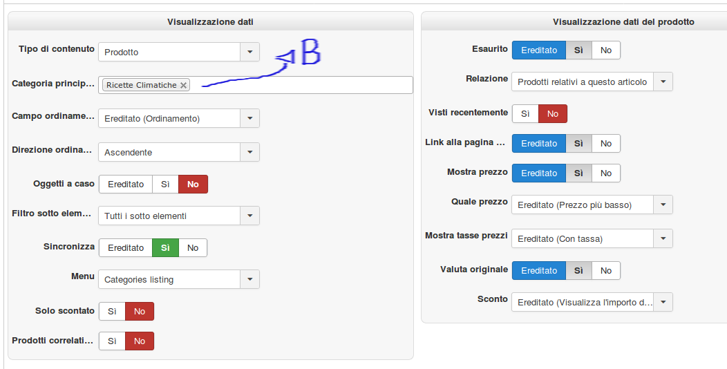

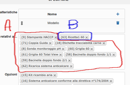

  • Posts: 10
6 years 9 months ago #313350
Hi, in attachments there are my configuration. In 'conf_prodotto_1.png' you can see the related products configured in the product page, one of them is in category B the others in category A. In the second image in attachments there is the module configuration and the main category is 'Ricette Climatiche' (category B). I would like to see in the module slider only the related products that are in category B, but if I understood well your reply, this isn't possible. Or not?

6 years 9 months ago #313353
No, unfortunately it's not possible without custom development.
From how HikaShop works it's either Related product, that is a linked with a product (different process from a classic category) or category A or Category B.
Maybe your solution will be theoretically to create a 2 specific category for your needs, but of course it's a good solution if you have few product with this specific needs.
Sorry for this return.
