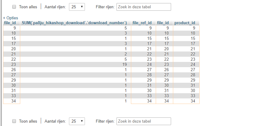

Still a bit struggling with the totals.
But in my phpmyadmin i now get a list of every file_id with the total downloads grouped. (see attachment)
How can i call the right id for a product with the download number within the product listing img view after i call on this first out of the database?

  • Posts: 86187
6 years 8 months ago #314648
Well, first, I would recommend to use Joomla's functions, use LEFT JOINs and aliases. It will be much better.
For example:
$query = "SELECT SUM(d.download_number) AS total FROM #__hikashop_file AS f
LEFT JOIN #__hikashop_download AS d ON d.file_id = f.file_id
LEFT JOIN #__hikashop_product AS p ON p.product_id = f.file_ref_id
WHERE p.product_id = " . (int) $this->row->product_id . "
GROUP BY d.file_id";
$db = JFactory::getDBO();
$db->setQuery($query);
$download = $db->loadObject();
echo $download->total;
