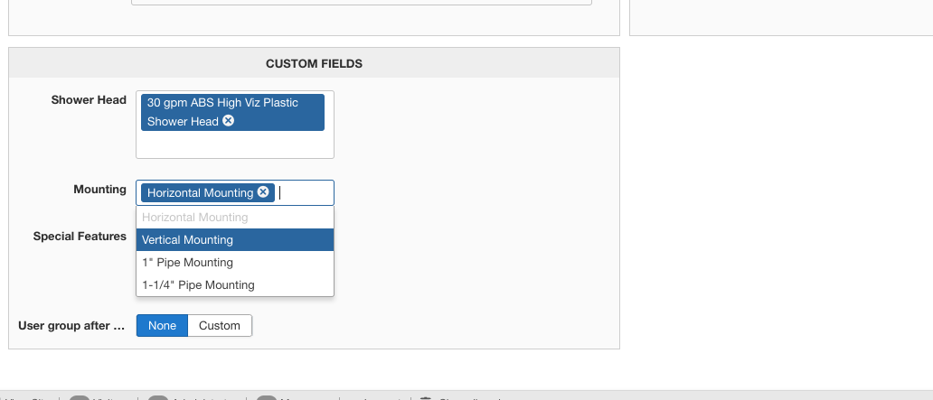

I have a multi-select custom field added to a product. When I navigate to the back-end of the product, make a selection or two from the multi-select and save, some values save and some do not.
An example: Multi-select custom field name "Mounting" with the following structure.
Mounting
- Horizontal Mounting
- Vertical Mounting
- 1" Pipe Mounting
- 1-1/4" Pipe Mounting
If I select Horizontal Mounting or Vertical Mounting or both, the values save into the product. If I select 1" Pipe Mounting or 1-1/4" Pipe Mounting the values do not save. It seems like the double quote in the value is causing an issue. Perhaps the custom field values need to html entity encoded before they're placed into the option value="" in the DOM.

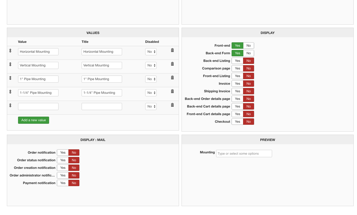

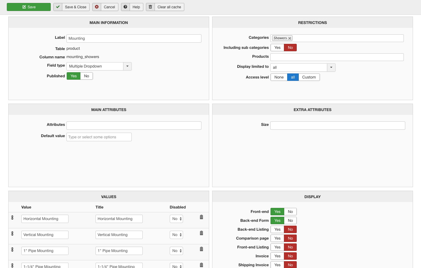

screenshots attached

6 years 10 months ago - 6 years 10 months ago #314721
by Philip
Replied by Philip on topic Product custom field values not saving in backend of product
Thanks for your returns ! It able us to improve our code to manage specific cases like yours, here you have some " and start your value by a number, both of these leads to a bug.
You can now update to have the fix, and your solution.
Last edit: 6 years 10 months ago by Philip.
