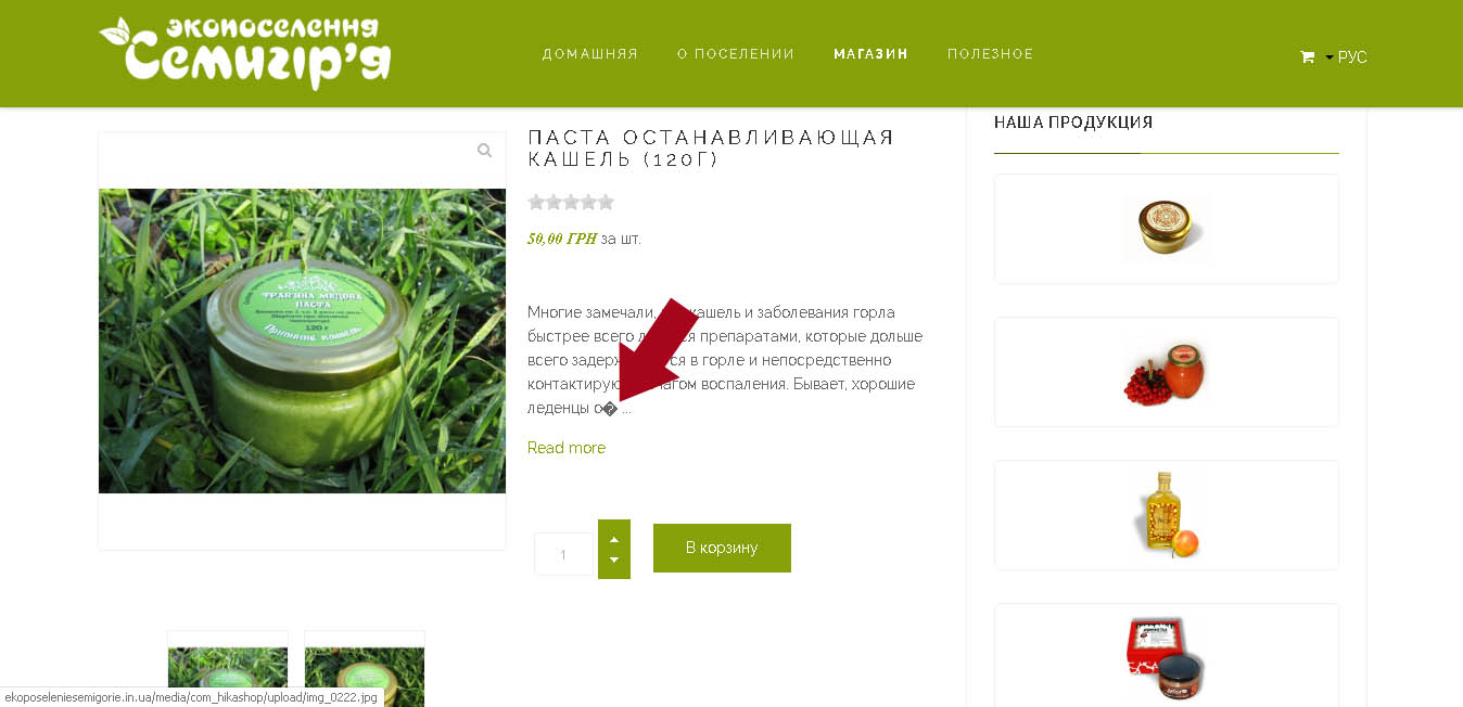

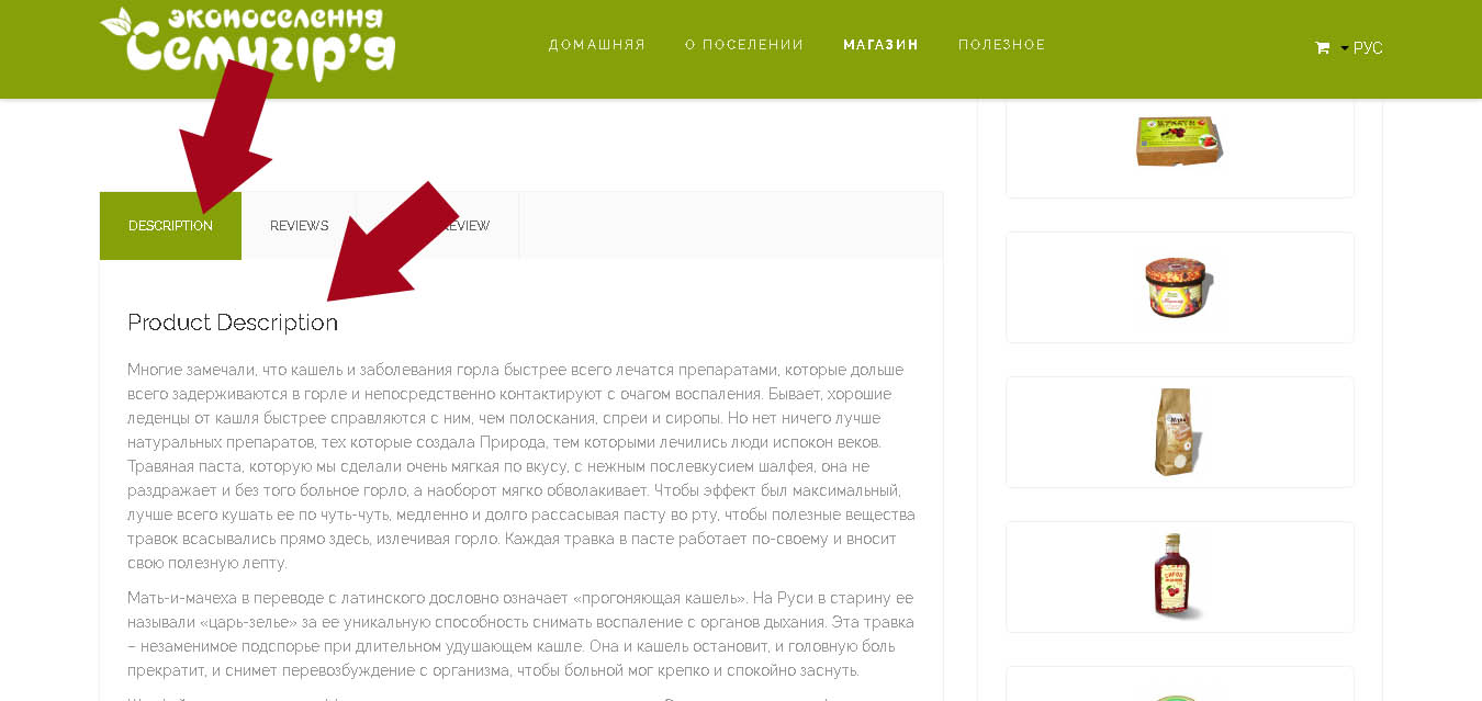

Hello
I could not find a solution for the next two questions:
1) How to remove the symbol at the end of short product description
2) How to display the names of tabs in correct language for multilanguage site
Thank you

1. You have an issue with a special character, unfortunatelly the only solution is modify the code in your view, here, product/show_tabular, let's follow me step by step :
- From your Main HikaShop Configuration => Display dropdown => Views
- Use the 3 dropdown filters with : product / Your Template / Front end
- Find your view show_tabular and open it
- Around line 73, you have this :
if(!empty($this->element->product_description)) {
			$resume = substr(strip_tags(preg_replace('#<hr *id="system-readmore" */>.*#is','',$this->element->product_description)),0,300);
			if (!empty($this->element->product_description) && strlen($this->element->product_description)>300)
				$resume .= " ...<a href='#hikashop_show_tabular_description'>".JText::_('READ_MORE')."</a>";
			echo JHTML::_('content.prepare',$resume);
Replace the "substr" for have this :
			$resume = mb_substr(strip_tags(preg_replace('#<hr *id="system-readmore" */>.*#is','',$this->element->product_description)),0,300);
Here , more details about this technical issue.
2. Before going more far on this subject, you can process a test like try with a default template, like Protostar
=> If that solve your issue, that mean that your template override some part of HikaShop elements (that I guess was translated)
Your solution is to contact your template creator support.
Hope this will help you to solve your issue.

6 years 7 months ago #314754
Thank you for quick reply.
The problem is solved.
