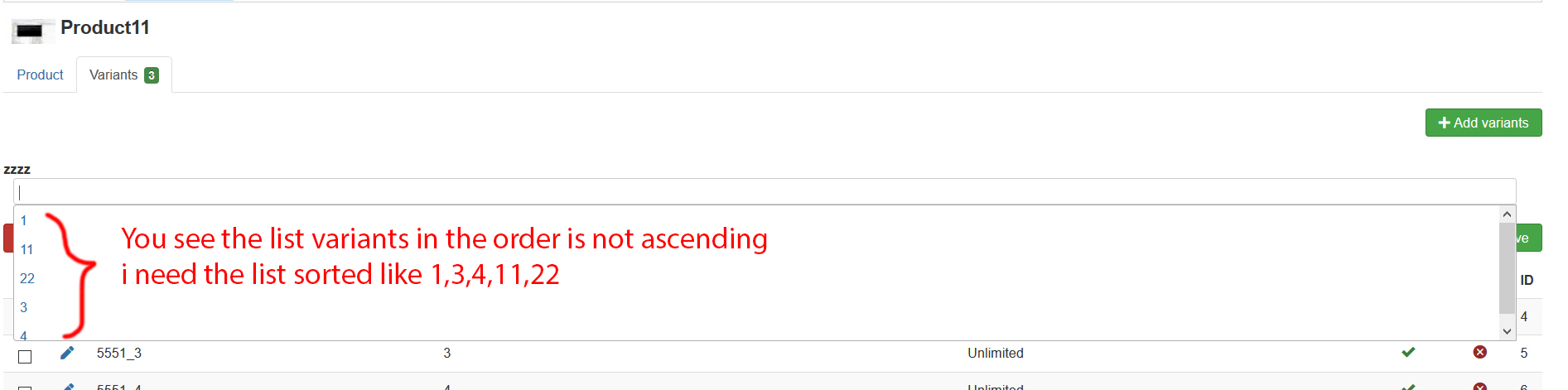

You see the list variants in the order is not ascending (is 1,11,22,3,4)
i need the variants list sorted like 1,3,4,11,22
Please can you write some php code for doing that

What you want to do is to edit the characteristic in the menu Products>Characteristics and use the "order" column of the values listing to tell the system the order you want. Then, in the HikaShop configuration, in the "Characteristics values ordering" setting, you can select "ordering" as it is by default, and the values of the characteristics will be ordered based on the order of the values you configured in each characteristic.

It works only for Products>Characteristics section
But it not working when you select "+Add variants" manually to the product, list shows variants alphabetically (see attached image again), i want in this list variants sorted by id
How can i do that??? Any php code can you write?

That's going to be complex to do. I looked at it on my end for a few hours but basically, it would require complex modifications to the selector system we're using as the data we provide in json is automatically sorted alphabetically and even if we change it to not do the sorting, and modifying the PHP code to sort the data correctly in the json, the data read from the json by the javascript of the selector automatically uses the id of the value for the order of the value in the array ( it's this issue: stackoverflow.com/questions/8924456/how-...i-sort-my-json-array ). And to avoid that will require changing the structure of the json passed to have an additional "ordering" parameter.
Basically, that's a complex issue that will require hours of development. So I'll add it to the todo list, but I believe it's a minor issue compared to the complexity of changing that.
