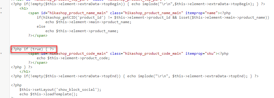

  • Posts: 72
  • Thank you received: 5
6 years 6 months ago #315174
It did what you said (see printscreen), but it does not work yet.
Please help.
  • Posts: 86052
  • Thank you received: 14180
6 years 6 months ago #315185
What do you mean by "it does not work yet" ?
Because when I check the product pages on your website I do see the product code displayed. And if you followed mye instructions from my previous message, you should have turned off the setting to display the product code and thus it would mean that this modification is working.
