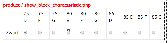

I am looking to disable the button via css or override in the relevant php file for no stock
I just don't see how I can make this.
Supplement:
It is also possible to show the color by default.
And that the measures are then loaded as a dropdown.
And that in that dropdown the out of stock products is disabled.
So that you can indicate all sizes that you can supply

I have already looked at the option you indicate, but it does not meet the need.
We would like to see the color as standard and then the sizes that go with it.
the sizes that are not in stock are not active.

If you set the "characteristics selection method" setting to "table", then you'll have a 2D table with only the variants with stock with a radio button. The others will have a cross icon.
Your first screenshot tells me you already have that setting configured like that, but you have a display issue on your website leading to both the radio input and the cross icon being displayed for variants without stock.
So that seems to be a glitch, probably related to the template CSS.
I would need a link to that page so check the situation to be able to tell you what's wrong there.
