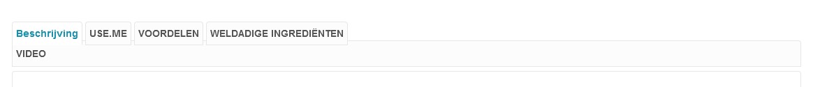

The problem i'm currently facing is bifold
1. All tabs "work" besides the last one. If i click on the last one it "jumps" down from being tab title to looking like text. Clicking on the other tabs then keeps the title of the last tab present and in that position. It's no longer a tab see attachments
2. I have no idea how to add text to each seperate tab. There doesn't seam to be an option for that after doing this when adding/editing a product.

I checked your frontend but I can see two issues:
You use for example the id USE_ME_li in your first li tag. But it should be: hikashop_show_tabular_use_me_li
Also, you're missing completely the code:
<div class="hikashop_tabs_content" id="hikashop_show_tabular_use_me">
<?php echo $this->element->use_me; ?>
</div>
that you should put in the <ul class="hikashop_tabs_ul"> as explained in the FAQ.
That's because of these two things that the tabs don't work.

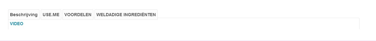

It created an extra tab "Specificaties" on the front-end instead of using the tab "USE.ME" (with id hikashop_show_tabular_use_me_li) itself.
Now here's the kicker.
Adding the shortcode in only the "video" custom field > video isn't rendered
Adding the shortcode in any other custom field AND the video wysiwyg editor > video gets displayed
but still not in the proper tab

- You should turn off the display setting of your custom fields if you don't want them to appear in the specifications tab, since you're displaying them yourself
- you still had incorrect ids in your divs as they had an extra _li at the end of the id. That's why the tabs were not working
- also, you have variants in your product, so you need extra code to get the data from the main product
- also, since you want to replace tags from content plugins, you need extra code to process the content tags
I've done the modifications for you with the access you provided. Please note however that this goes way beyond user support. That's custom development work. If you need our help for similar things in the future, we'll have to charge you for that.

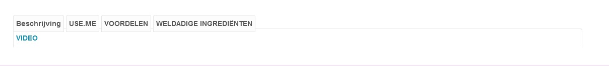

So just tried this but i'm using variants with specifications in the main product remember
<?php if(!empty($main->video)) { ?>
          <li id="hikashop_show_tabular_video_li" class="hikashop_tabs_li ui-corner-top"><?php echo JText::_('VIDEO');?></li>
          <?php } ?>
Seems to be hiding the tab entirely, even for products WITH a video. Ideal option would be to surround the entire section of the 5 custom tabs with a php statement that would work on all tabs, and not require a specific statement for each li
I guess i could change from using the main to variant specific info but considering there's over 100 products, nearly each with 3 or more variants that's a bucketload of work.
Last edit: 6 years 3 months ago by Ch3vr0n.

Your code will display the "VIDEO" tab only if there is something in the custom field "video" of the main product.
I don't see why this wouldn't work.
I guess there is something you're not telling me about the situation. Like you actually want the tab to appear because you display several fields in that tab ?
In that case, you should add the check around the display of the custom field, and not around the tab title.
And around the tab title, you would need a more complex check to display the tab if at least one field is set.

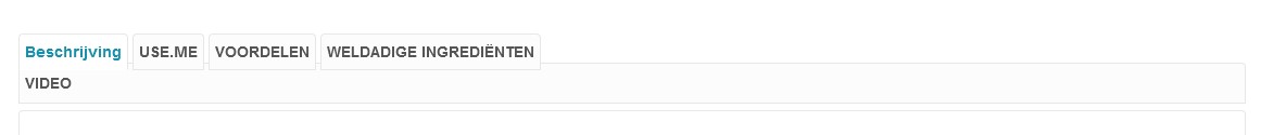

I only want the tab to appear IF the related custom field has been filled in. Any other case i want the tab hidden. I'm not using the variant specific custom field. Maybe that has something to do with it. Currently that code is hiding the video tab for ALL products including the ones that have video (including the ANGEL.MASQUE product being shown here www.hikashop.com/forum/product-category-...nagement.html#318461 )
(You can find that product under the category: Product type > Behandeling > top left one)
It's not a super big deal if what i'd like to do isn't possible without major customisation. It's just that i'd like not to show tabs for that specific product, if the tab has no data for that specific product.
1 last thing i tried is that i have front-end css file set to "default", so figured i'd set it back to "none" but that screws up the tabs completely. They still work, they're just no longer physical tabs.

Well, in that case, either your code is wrong, or the field is not empty for the product you're looking at.
Note that if you use a custom field of the type WYSIWYG, it's possible that your HTML editor adds extra HTML tags, even if you didn't enter anything in the field.
So try to check the type to "textarea" to see if that's the case. If so, it explains why you see the tab even though you believe it's empty.
