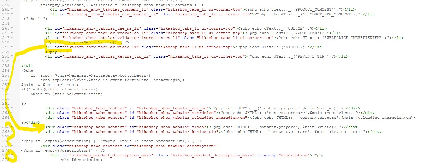

Hmm, didn't get a reply e-mail again. Tried setting it to text and textarea to no effect. Still hides the tab.
Checked out the source code and the code for the tab IS present, as i can see the "joomlaworks allvideo's" comment in it on both wysiwyg, text and textarea setting.
Not using a custom editor, default TinyMCE with zero customisations.
Very possible the code is incorrect, i'm no expert in php and tried to adapt your code mentioned above to work with the main product info

Well, maybe you could provide a screenshot of the whole area of the code where you have your additions so that we can check the situation there ?

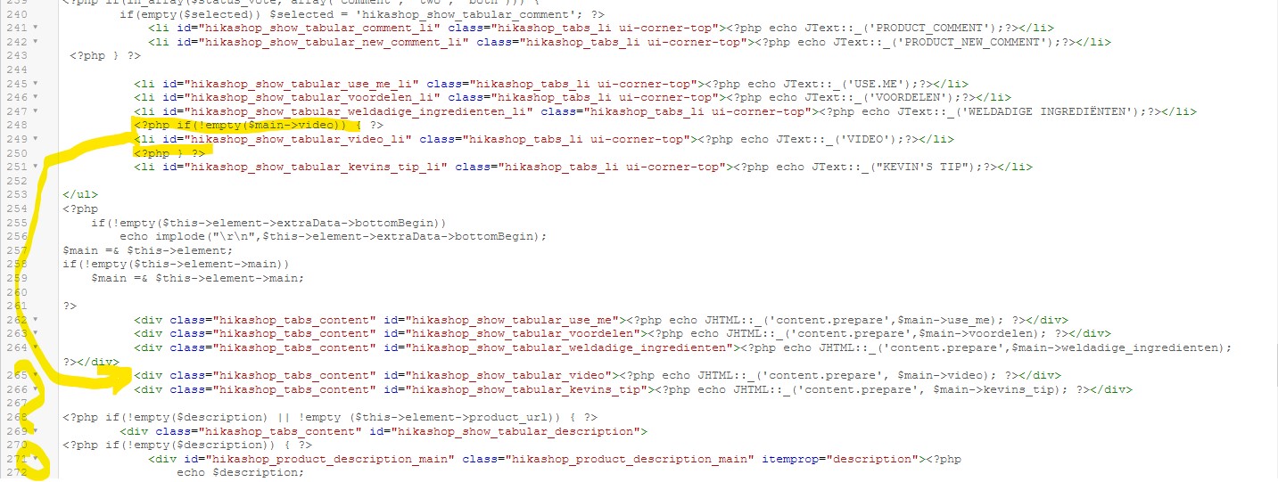

You're using the $main variable before it's being initialized. So you need to move the code to have the initialization before you use it:
monosnap.com/file/Bz9joQsHqKu1mp2SZvFr1nOilnzMe2
Please note that this is outside user support... I've already went twice on your backend for that custom development.
Next time, we'll have to send you an invoice.
Also, I'm not able to access your frontend with the access you had provided before so I couldn't check the situation there and whether changing that code would be enough to solve your situation.
Lastly, I did reply to your quote request 3 days ago, but never heard back from you:
monosnap.com/file/A5CeQe4drXU8yuTXVo6iKoRfEBgw1J
Maybe the email went in your spam folder ?

Your code with the if and the li tag is correct and at the correct place.
What you need to move is the code initializing $main before your code.

Finally had some time to test your earlier PHP code addition. Moving that bit of code to above where my custom tabs begin the video tab is functioning as entirely as desired.
Video's are rendering (as they've been for a while) AND the video tab is only showing on products that have a data in the custom field.
Just wanted to report that back, and your assistance in this matter was/is highly appreciated!
