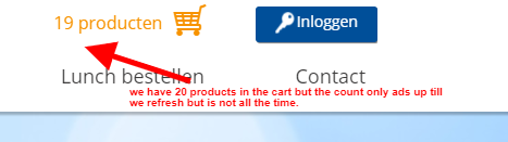

The counter of the shopping cart doesn't ad up the total products constantly. sometimes it says 6 while in the cart e.g. 9 products are.
how can we make it work correctly all the time??

we have exclude the caching for the module and path to cart.. but still after adding multiple products the after 5 or sometimes 10 products the counter will not add a new product to the cart..
So what can it be if it is not the caching.

We have looked at the cache of the pages and per user session, tried different ways. But in our test environment, we set all cache off in the joomla configuration then it looks like it goes well but then after adding 8 products it will stuck on counting 7 products. after putting another product in it the counter then will jump to 9.
Do you have another idea to solve this issue?

Hello to reproduce the problem.. and see that the counter is at an certain moment not counting we did the following.
3 products from this link:
https://janjongerius/aanbiedingen
no problem detected yet,
But when i go to :
janjongerius.nl/boodschappen/aardappel-r...gory/250-aardappelen
Put some more products in the cart the counter will then hesitate to add the next product counter remains e.g. 3 while 6 products are added. After adding again a product counter will count up to e.g. 7 products.
When then to another product group:
janjongerius.nl/boodschappen/koek-snoep-...ategory/311-toastjes
and put more products in it then the same will happen..
This also can happen after adding 20 products, so it is not really stable and all cache is disabled?
Hope you understand..
We tested this in firefox, chrome, opera and edge.
Regards.

I now only see a small glitch as you explain in your last message, whereby sometimes when I click on the add to cart button, the number in the cart module doesn't refresh but if I try another add to cart, or go to another page it is properly updated.
But that only happens on the second and third link you gave, not the first one.
And on the first one, I can see the popup of the add to cart, but I don't see it on the two others after the add to cart.
I think this is linked to the customization you did on the add to cart button of these two other pages.
There, the attribute data-addToCart of the a tag has been changed to data-addtocart. Because of that, the add to cart cannot be done in ajax anymore and it works in degraded mode, redirecting the whole page to the add to cart controller, and then redirecting to the checkout. And to avoid going to the checkout, as you didn't want that, you cheated and added a window.location.reload() on the span around the img tag of the add to cart link so that it stays on the current page.
I would recommend to remove that, and fix the case of the attribute of the add to cart link. That should then work with the ajax mode and the cart module should then refresh properly, like on your first link.
