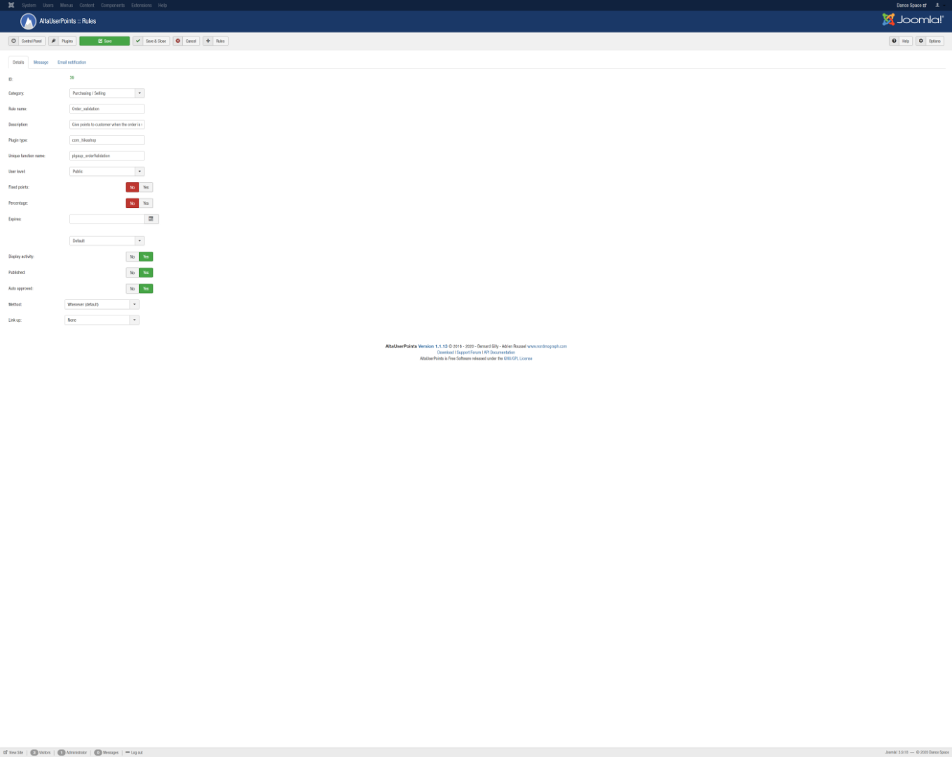

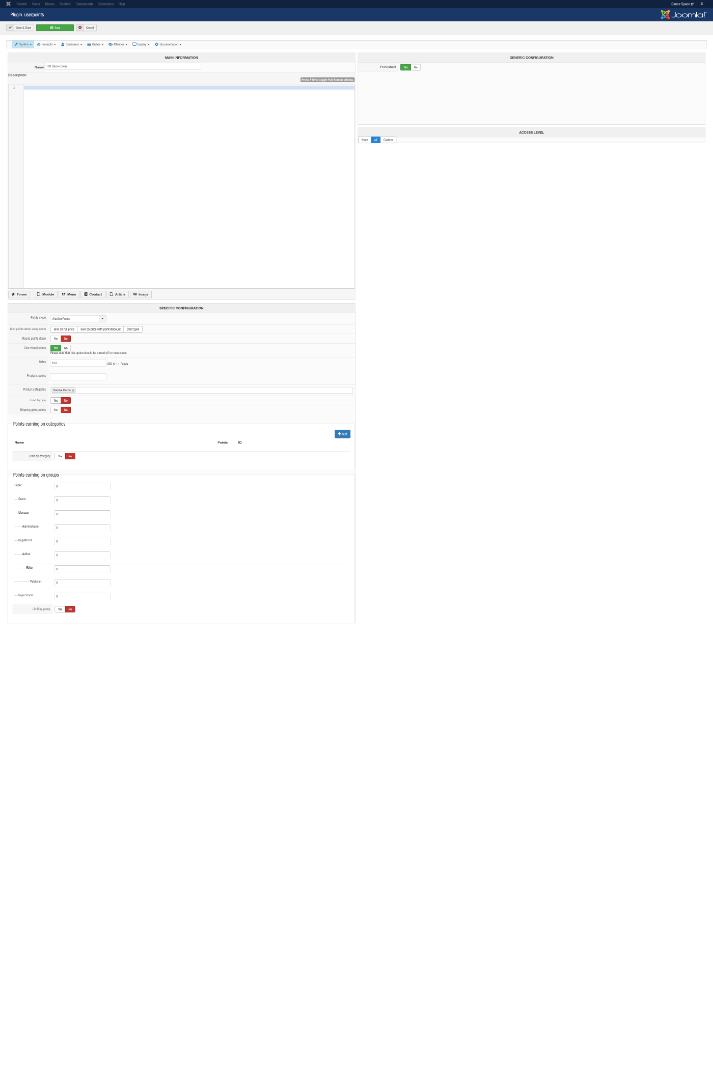

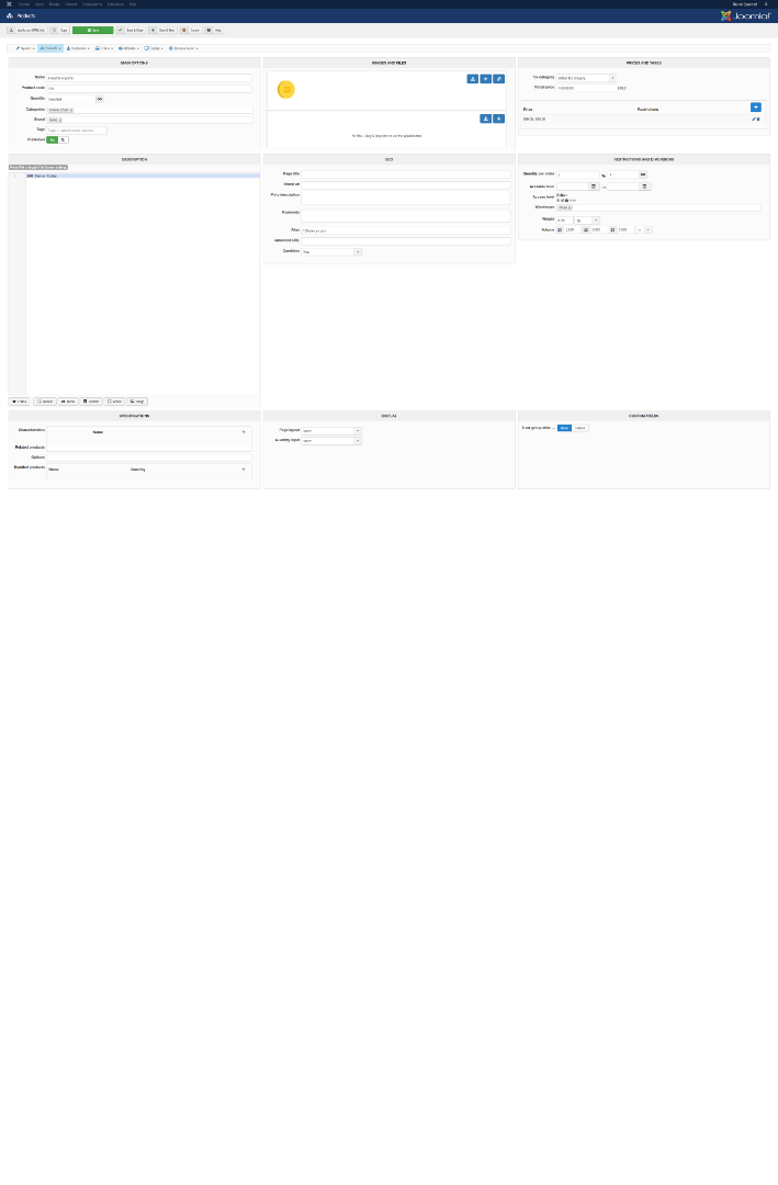

6 years 3 months ago #318231
I tried, as you say .. but unfortunately points were not awarded .. I tried different settings .. read the manual ..((

  • Posts: 86052
  • Thank you received: 14180
6 years 3 months ago #318272
Sorry but we can't read anything on your screenshots. Could you please redo them so that we can read what's written ?

  • Posts: 86052
6 years 3 months ago #318341
I can see that you configured a rate of 100$ -> 1 points in the settings of the plugin.
But in the screenshot of the product, I can see it costs only 10$.
So no points will be awarded for the purchase of that product as per your settings.
If you want to give 100 points for that 10$ product, then the rate should be 0.1
Also, I would recommend to turn off the "give virtual points" setting off in your plugin settings.
