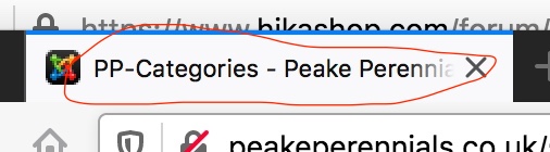

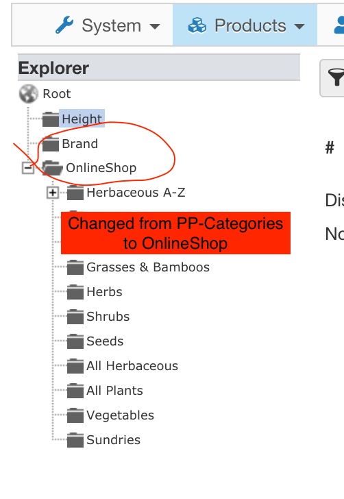

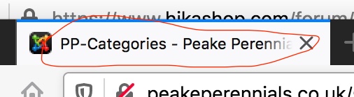

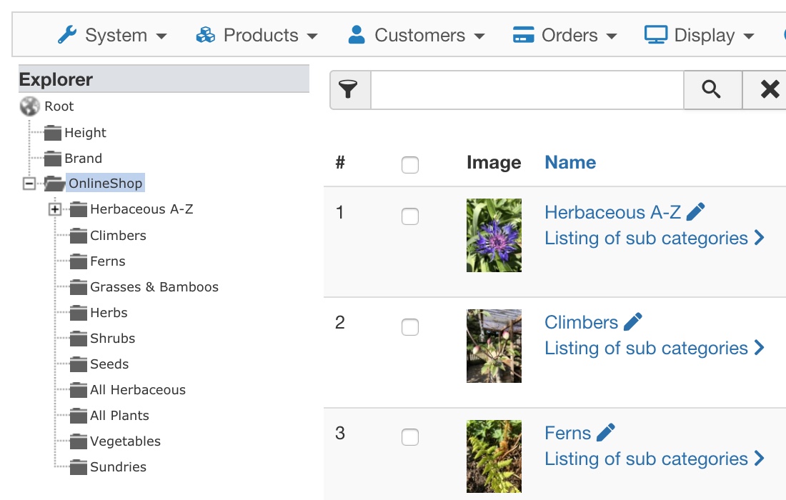

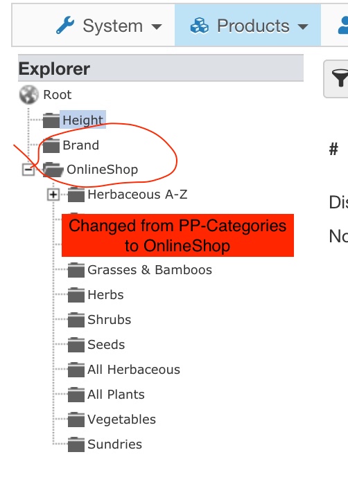

I used to have a Category name of "PP-Categories" but it was showing in the browser tab. So I renamed it in the category tree to "OnlineShop".
But the browser tab name did not change, it stayed at PP-Categories -even though it didn't exist anymore. I rebuild the database, still the same.

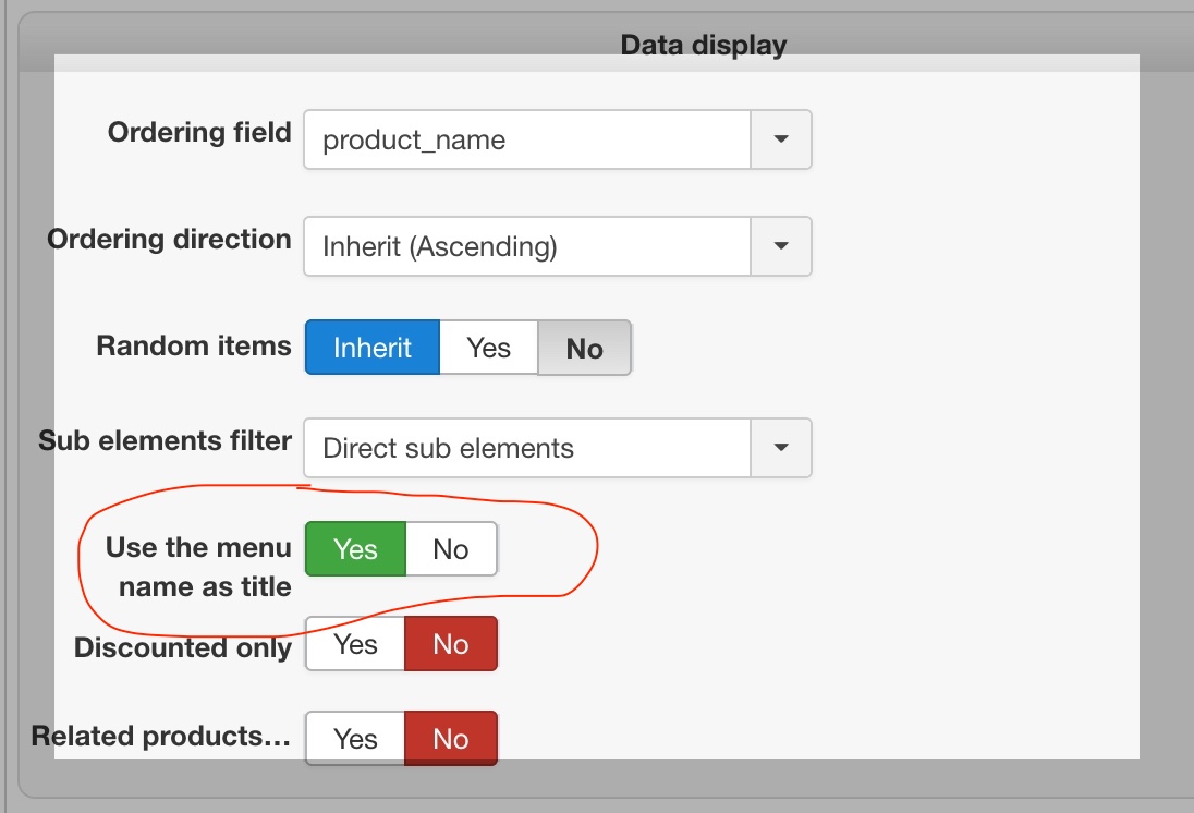

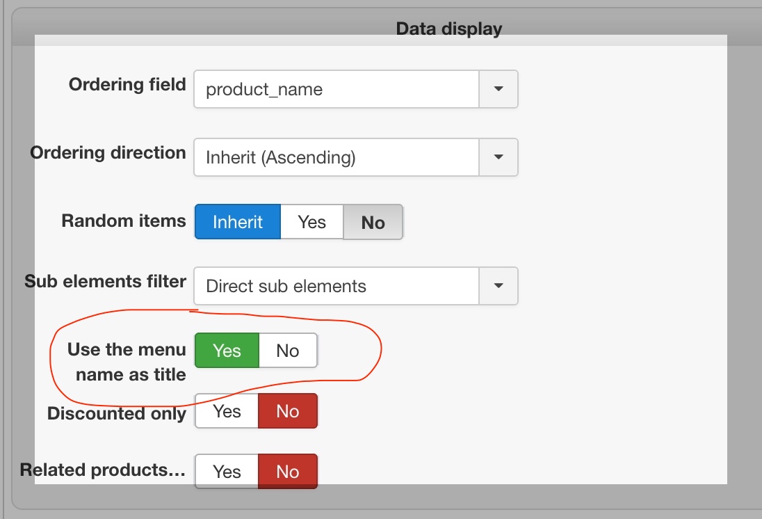

After searching the forum for similar issues I made a number of changes to various settings, both in Joomla Menus and HikaShop. Attached shots of current settings...
But the browser tab name remains at the non-existing category name of "PP-Categories" see below...
Why is it still displayed when it does not exist in HikaShop category listing? Must be a reason, something hasn't forgotten it...

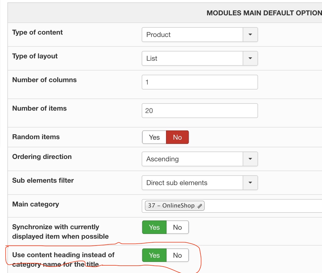

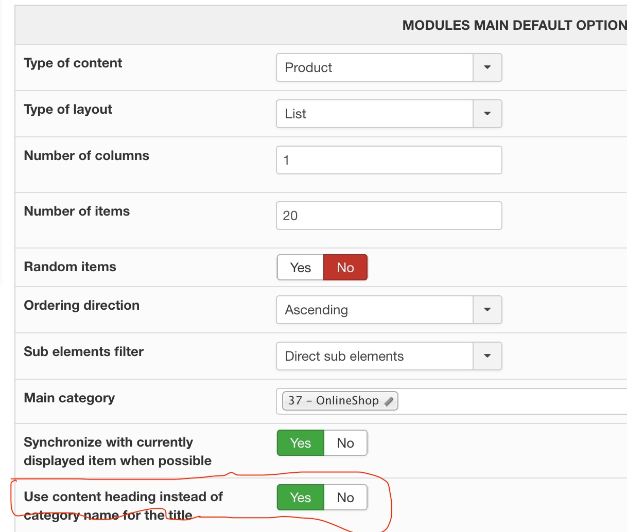

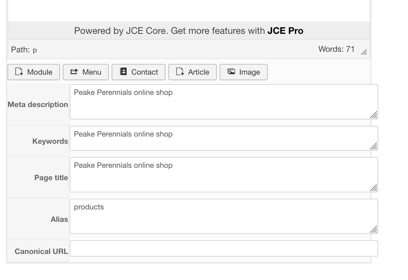

The "use content heading instead of category name for title" setting is used to decide what to display for the "component heading" on the page. But since you have the "show component heading" setting turned off, no component heading will display and thus that setting doesn't matter.

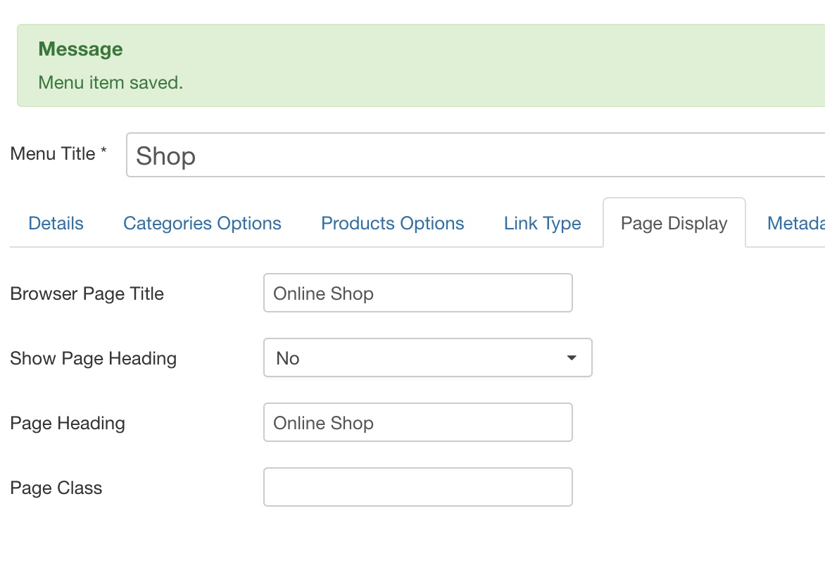

For the page title, which is what is displayed as the "tab title" of your browser, the system will first use the "page title" setting of the category. If that's empty, it will use the "browser page title" of your menu item.
So I suppose that you must still have "PP Category" in the "page title" setting of that category.

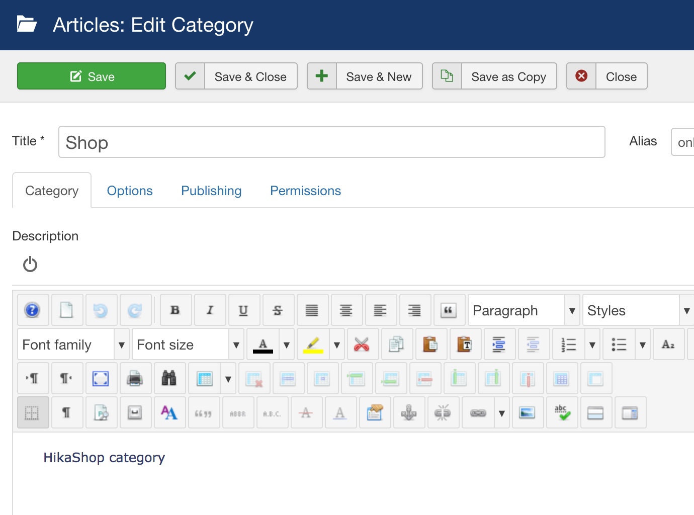

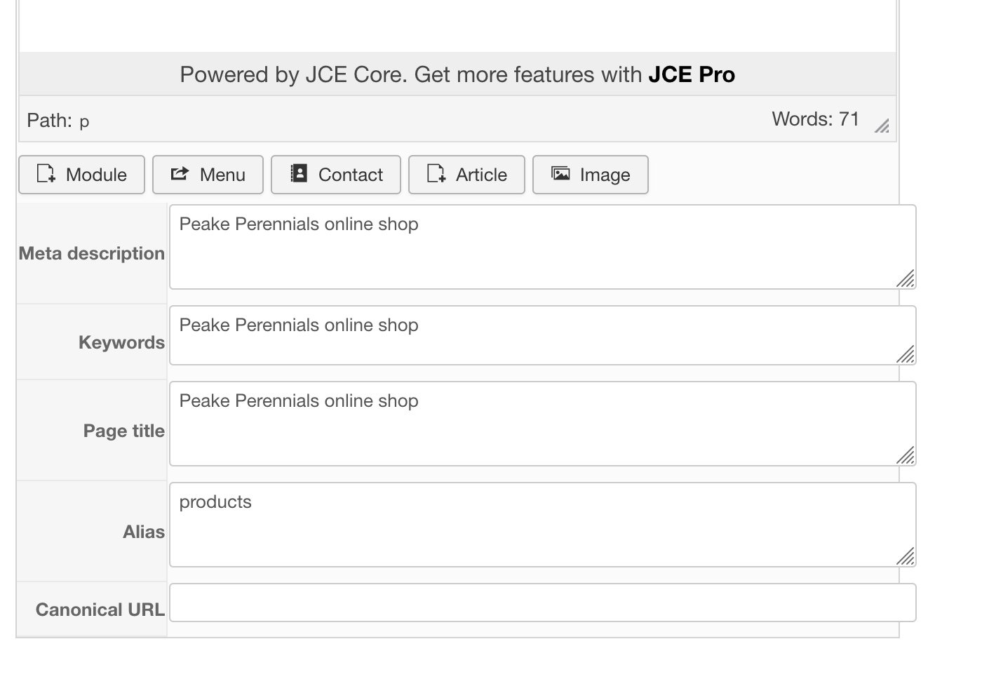

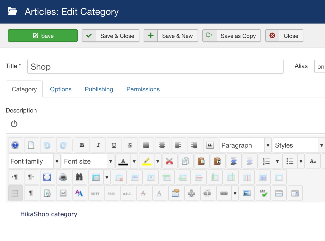

I'm maybe being a bit of a numskull here but I can't find where you suspect I still have "PP Categories" set. You say it's probably in the "page title" of the category... but I'm struggling to find this setting anywhere. I looked in the Joomla Category "Shop" and I don't see it (attached)
Is this where I should be looking?

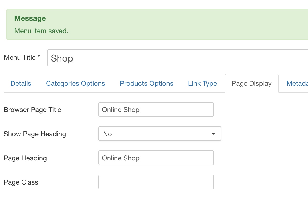

I've looked in the Joomla Menu item settings, can't find it, and I can't see any setting like this in the HikaShop Category for what was the 'PP-Categorgies' (which is now renamed to 'OnlineShop' and has been for some time) -attached.

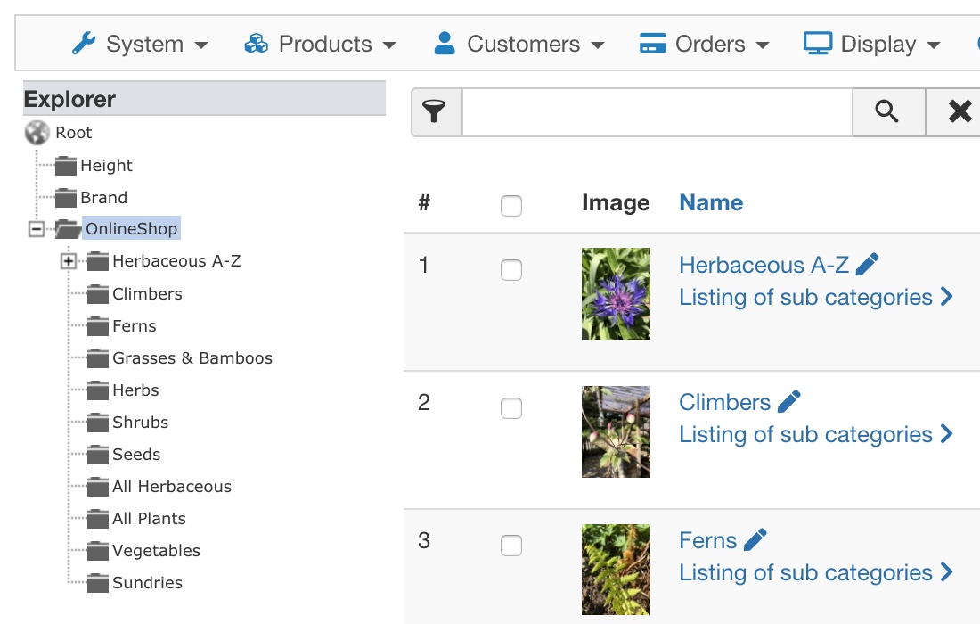

Your first screenshot is of a Joomla article category. These are not used by HikaShop.
On your second screenshot, click on the "root" link of the explorer. Then, on the right side, edit your "onlineshop" category.
It's on that setting page of this category that you should have the "PP categories" text inside the "page title" setting.

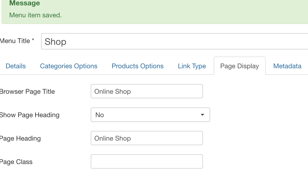

And the "show component heading" setting is under the "page display" tab of your menu item when you edit it via the Joomla menu manager. Each menu item has such setting.

OK, so did look right past the "page title" box - but it doesn't say "PP Catergories" it says "Peake Perennials online shop"...?? How's that work?
I changed the title box to something else but the "PP-Catergoies" still appears on the browser tab for the menu Cat Listing.
I then cleared the Page Title box, but "PP-Catergoies" is still displayed on the tab

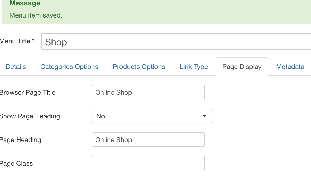

Did you mean "Show Page Heading" on the Page Display menu item? Can't see a "Show Component Heading" there...?
Changing this to YES didn't make any difference.
