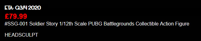

I have products with variants and use the dropdown to select the price options. I would like to display the main price at the top of the product description, ideally below the ETA field as per the attachment.

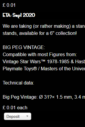

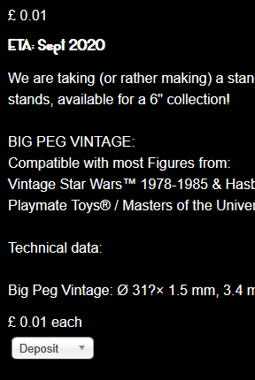

The full price would be £19.99 for instance the default characteristics price is £0.01 which is what is displayed if I add the code.

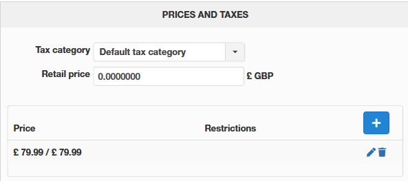

yes the products have a variant. The variant lower price is the default. The main price is £79.99 for instance this is what I would like to display at the top of the description.
David

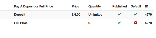

sorry but that code displays the deposit amount which is what I am trying to avoid. Please see the screenshot.
Basically the code like others I have tried displays the lowest price variant price where as I need to show the full price.
David
