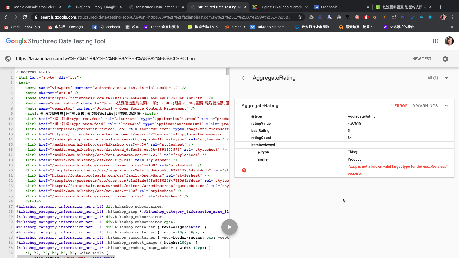

I got the error alert email from google console after upgrading Hikashop to newest version. How to fix it?
The page with problem:
facianohair.com.tw/%E7%B7%9A%E4%B8%8A%E8%A8%82%E8%B3%BC.html
Error message:
Invalid object type for field "itemReviewed"
First detected: 6/5/20
Status: Error

  • Posts: 220
6 years 2 months ago #320581
Please see attachment and help me know how to fix it. Thank you so much.

6 years 2 months ago #320743
Thanks for your elements that allow me to go more far on your issue, and after analyze I think I get your root issue, follow me step by step :
- From Main HikaShop Configuration, go to Display dropdown => Views
- Use your 3 dropdowns filters with Product/Your current template/Frontend
- Find your listing_div view
=> Here, you have an override that come from the HikaShop 2.5.0, this view didn't have the HikaShop built-in MicroData, and so it's not really a surprise that something don't work about this.
And to be clear, I'm even surprised that there so few error, for the future take care to don't use another microdata plugin on page where HikaShop already manage this.
Now, what you have to do, is to remove this override and if required create a new one from your HikaShop 4.3.0, and this will quite for sure solve your issue.
Hope this will help you to solve this.
Last edit: 6 years 2 months ago by Philip.
