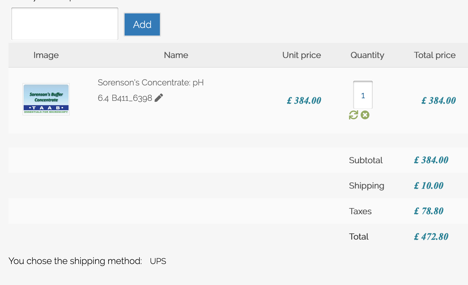

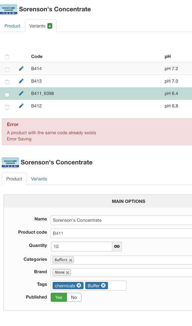

I have a product type in 4x versions
B411, B412, B413, B414 (each is a different concenration)
B411 is the default product
I add 3 Variants for B411 and each variant becomes B411_xxxx
The variants state : "no default" selected
I add the default value of the primary product so there are now 4 variants and it appears OK on the website. BUT when I try to change the numbers back to B411, B412, B413, B414; I cannot change the default product as its says the number exists and I have a number then B411_xxxx
How can I stop this. I need to keep the product number correct for the business.

6 years 4 days ago #320862
Your error message means that among all your products one of them use the same Product code.
The most simple idea, is to check that your "main" product code isn't the one you want use in your variant and to modify it
Ex :
Product tab : ("main" product)
Code => HKTSwh01_REF
Variants tab :
Code => HKTSwh01
(variant 01)
Code => HKTSwh02
(variant 02)
Code => HKTSwh03
And so on...
IF your "main" product doesn't use this code AND also, if none of all of your products use this code, maybe this product code remains present in SQL (from a deleted product).
Then take care, wrong managing Sql can leads to important issue, you have to only modify the product code, not delete it OR delete the product entry (line), I insist it's very important.
If you have any doubts about how to process come back to us before modifying your Sql.
Note : Most often we didn't recommend to directly modifying Sql tables, here it's one of the rare cases where there is no other choice !
Hope this will help you to move forward.

The main product is a virtual entity. For example, if I sell a red tshirt in the sizes L and XL, the main product would be "red tshirt" and it would have two variants: L and XL.
So in your case too, you want to have B411 as a variant of the main product. You first need to change the product code of the main product to a code which doesn't exist, like "main_B41" and then add the variant B411 with the correct product code.
If your main product already has the code B411, you can't use it in a variant or another product. That why you should first change the code of the main product if it's actually using the code of a variant you want to add.
