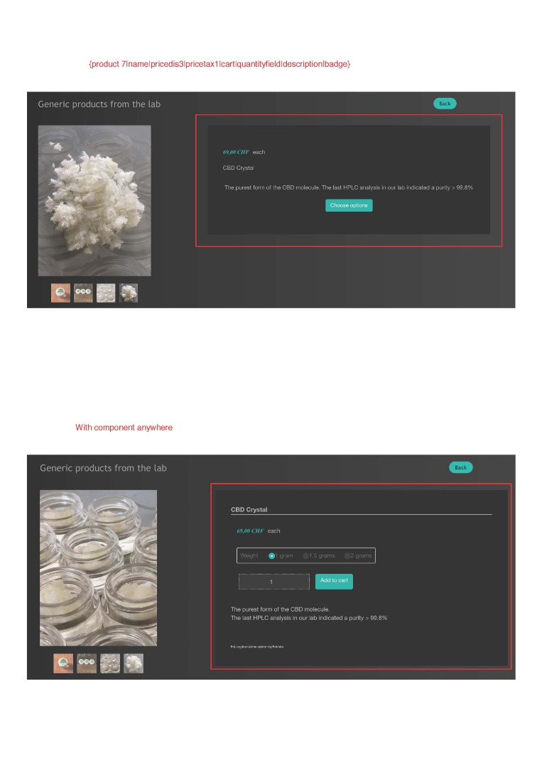

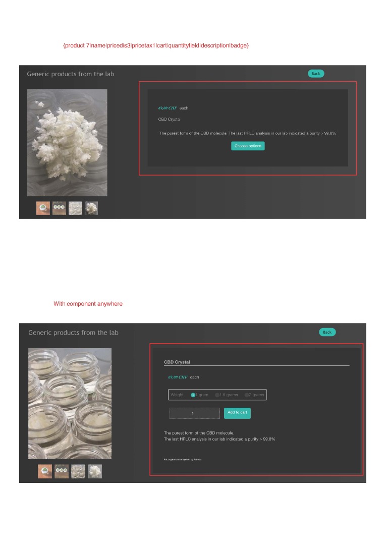

Seems the default Joomla method to get url contents does not have the functionality to pass on cookies.
In the Components Anywhere system plugin settings, switch on the "Force cURL" option.
Let's try something else.
If I put tags in a custom module, I have the "choose options" on another page.
Is there any way to get the options on the same display, like on the image on the bottom, which is the result I get with Components anywhere?
With tags, the currencies are ok but I can't get the options on the same page. Do you see a solution?
Thank you, again...

  • Posts: 86114
  • Thank you received: 14210
6 years 2 months ago #321181
I understand what you're trying to do. But the characteristics selector system is only available on the product page.
Doing that elsewhere would require important development, which is why I first recommended to do it with components anywhere.
Now this can be developed but you're looking a several hundred euros of development costs.
